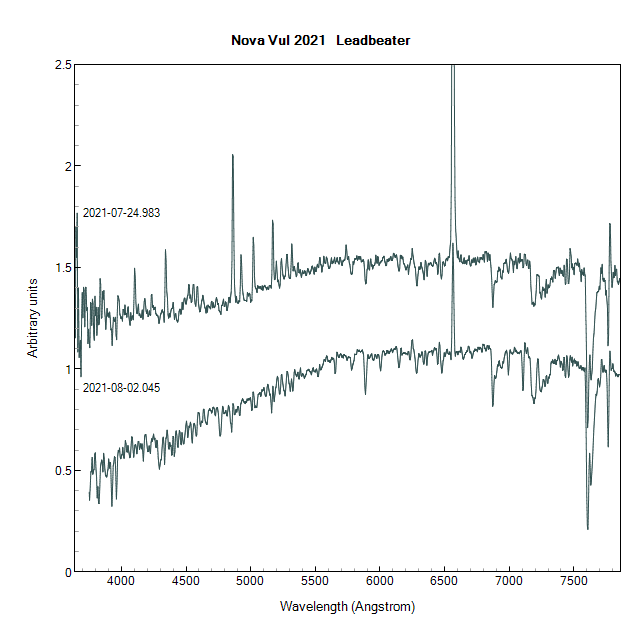

I took a new spectrum of Nova Vul 2021, five days after the first one. The continuous spectrum and luminosity have increased (Magnitude: 12 to 10.4). Spectral lines have also varied: In the last spectrum the only line in emission is H-alpha, but with a relatively diminished intensity. The rest of the Balmer lines as well as the iron lines (which were in emission five days ago) are now, all of them, in absorption. I suppose it must be the relationship between what happens in the stellar wind of the nova and in the shell (now more expanded). Is that so?
However, I do not see this effect in the spectra of other observers. Conditions in which I got both spectra were similar ..... (?)

That is an interesting dramatic change. (I have had no clear skies for a week.) I checked the BAA,ARAS and AAVSO databases and I cannot find any spectra later than yours for 20210726 and 20210731. ATel# 14816 mentions Fe lines with P Cygni profiles on 20210728 so the change to absorption must have taken place between 28 and 31 July
Re: TCP J20210770+2914093 a nova in Vul
Posted: Mon Aug 02, 2021 1:26 pm

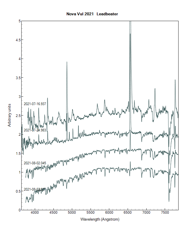

A spectrum last night confirms the dramatic change in the spectrum. Except for a relatively weak narrow H alpha emission, all lines previously in emission are either missing or in net absorption
Posted: Tue Aug 03, 2021 1:00 pm

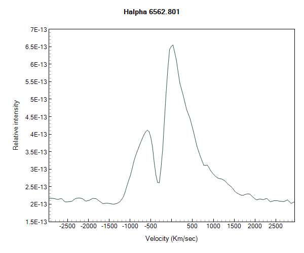

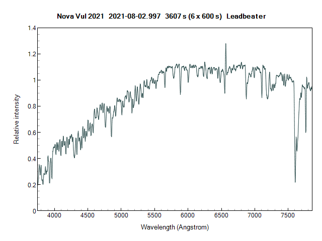

The H alpha emission has weakened further and is now showing a P Cygni profile with velocity (emission max-absorption min) of ~600km/s. The spectrum looks similar to a G/K star photosphere but with some additional absorption lines, particularly in the red at ~7106 and 7766.

Seeing the magnitude evolution, it seems that the luminosity of the nova is stabilizing. The emission lines decrease while spectral background and absorption lines increase. Juan Jose

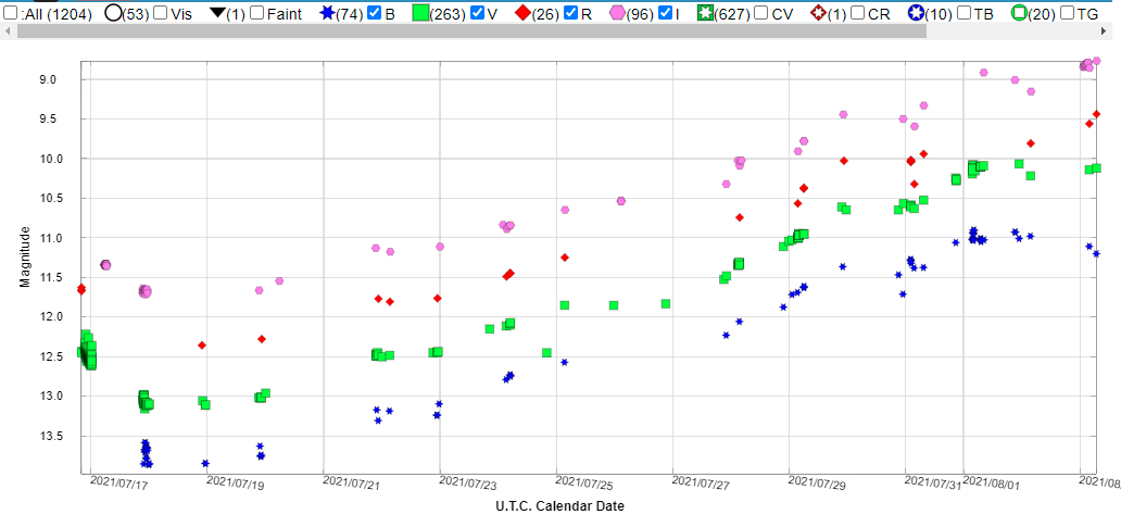

Juan Jose Pueyo wrote:Seeing the magnitude evolution, it seems that the luminosity of the nova is stabilizing.
Hi Juan Jose,
Should the date for the last spectrum be 02/08/2021 ?
V is steady but B is decreasing and R/I are still increasing. (It is cooling down?)
I think there could be a problem with the response correction. Your continuum shape looks quite different to mine
(EDIT: the problem could be partly with my spectra. I am seeing some consistent differences between the reference stars I am using which I need to investigate)

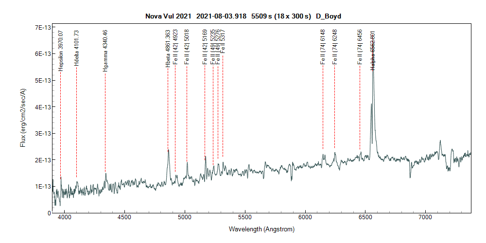

Last night, 3rd August, I measured Nova Vul 2021 at V=10.97, B-V=1.14, almost a magnitude fainter than 48 hrs before and slightly redder.
The following LISA spectrum (R~1062) was calibrated in absolute flux using this V magnitude and response corrected with the B9III MILES star HD192907 recorded at the same airmass as the mid-time of the nova spectrum. H-alpha has a strong P-Cyg absorption dip at -320 km/s which now falls within the ~3000 km/s FWZI of the line. FeII multiplets 42, 49 and 74 are prominent with just-resolved P-Cyg dips. There are also emission features at ~5526A, ~5662A and ~7117A, all with P-Cyg dips, which I have not been able to identify in the WIlliams list of nova emission lines. Suggestions?
