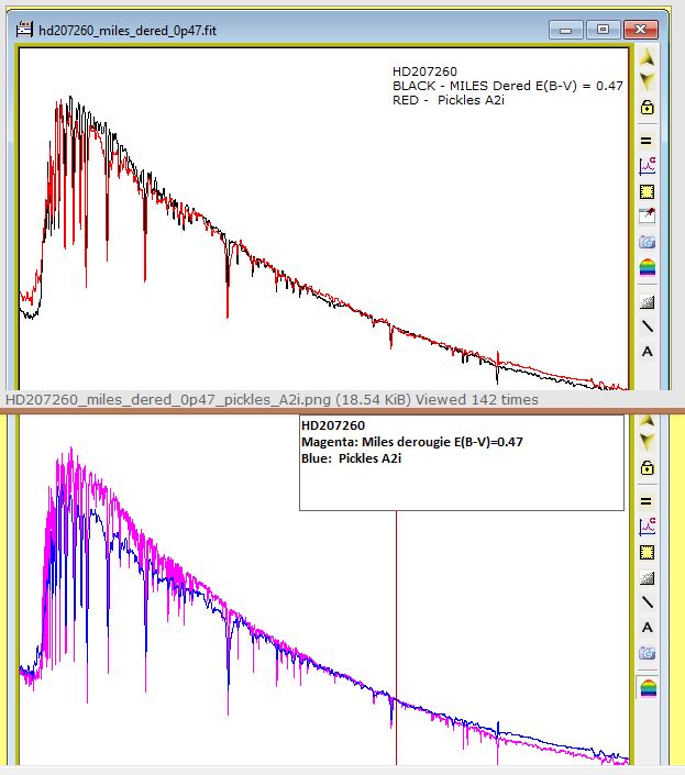

Benjamin Mauclaire wrote: Where is the truth (sic)?
Here is the truth :-)
Black is MILES HD207160 dereddened by E(B-V) = 0.47
Red is Pickles A2i
Red is Pickles A2i
Hello Robin,
I just read your message.
Thank you, that's telling, so for HD206270, E(B-V)=0,47.
Cheers.
Michel
The attachment HD207260_miles_dered_0p47_pickles_A2i.png is no longer available
Red is Pickles A2i

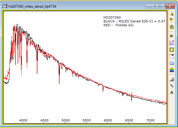

Hello Robin,
I tried to make the same comparison as you:
-HD207260 Miles (extracted from ISIS library) and dered with E(B-V)=0.47 (using the “Extinction” tab in ISIS V6.1.1)-(normalization: between 5650A and 5665A)
and
-the profile of a star A2i (from the VisualSpec library)-(normalization: between 5650A and 5665A)
But my result is slightly different from yours: the gap between the continum of HD207260 and that of A2i Pickles is a little bigger than in your comparison:
Comparaisons HD207260-Miles-Pickles-var.JPG (74.28 KiB) Viewed 13818 times
What would be the cause of this difference?
Cheers.
Michel

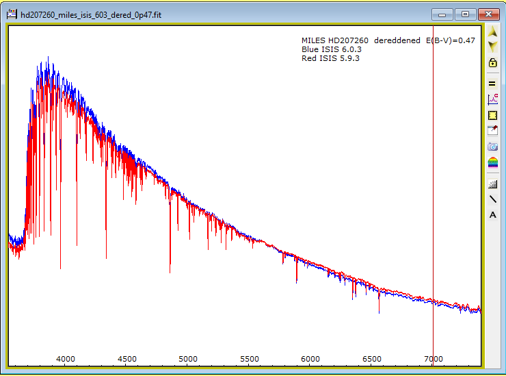

Re: Ecart de continuum
Hi Michel,
Here are my files(zip file attached.) Which one is different to yours ?
(I smoothed the MILES spectrum in the posted image to match the resolution of the Pickles spectrum and I still use ISIS 5.9.3 because I prefer that it corrects for the black body curve of the flat lamp but that should not be important here)
HD207260_fits_files.zip
(34.66 KiB) Downloaded 815 times
Robin Leadbeater wrote: Here are my files(zip file attached.) Which one is different to yours ?
OK I think I have found the reason. The formula ISIS uses to calculate the extinction must have been changed somewhere between version 5.9.3 and 6.0.3 (There are alternative formulae in the literature.)
The extinction calculation used in ISIS 5.9.3 matches that used by the authors of the MILES library and by Paolo Berardi in his MILES spreadsheet.
Unfortunately I cannot find any documentation for this change in ISIS or references to which formulae are used.
