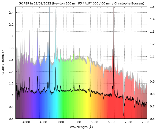

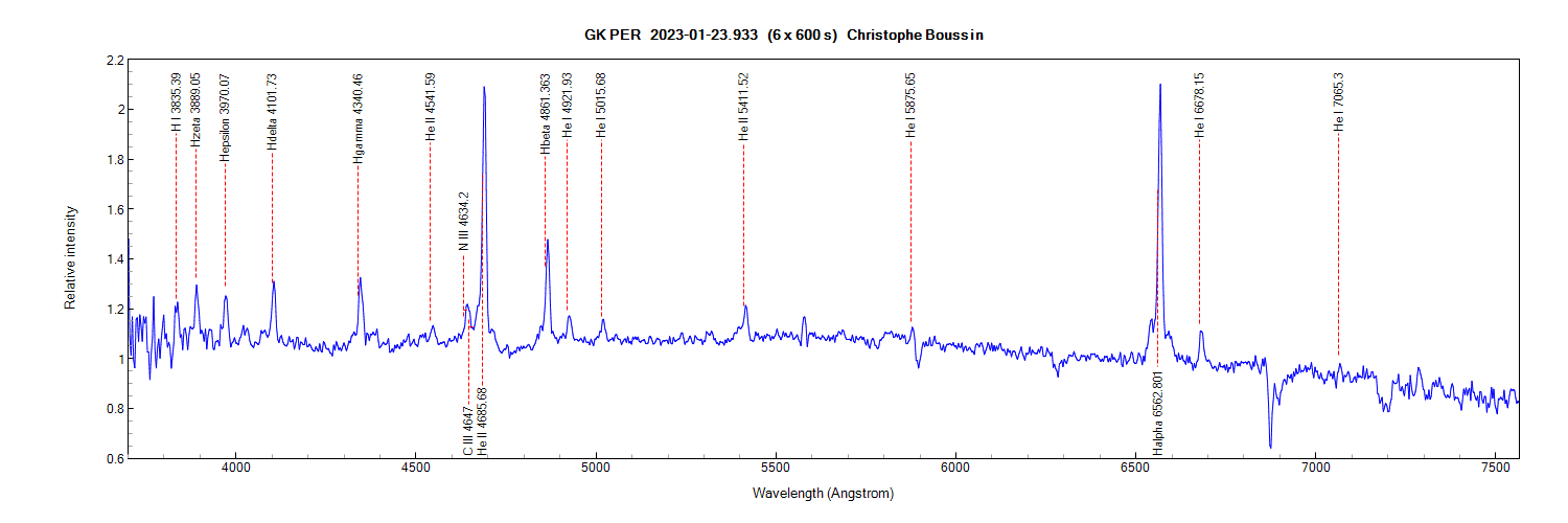

Again, clear skies for a few hours on Monday evening, just enough time to take a second spectrum of GK Per...which was obtained on 23 January at 22:23 UT (resolution of 528, JJ = 2459968.4328) with my Alpy 600 and an acquisition time of 60 min (6 x 600s) :
GK Per on January 23th, 2023
_gkper_20230123_933_Christophe Boussin_3700_7565.png (104.61 KiB) Viewed 17104 times
GK Per on January 23th, 2023 (identification of some lines from PlotSpectra)
Clear skies for all...as often as possible !!

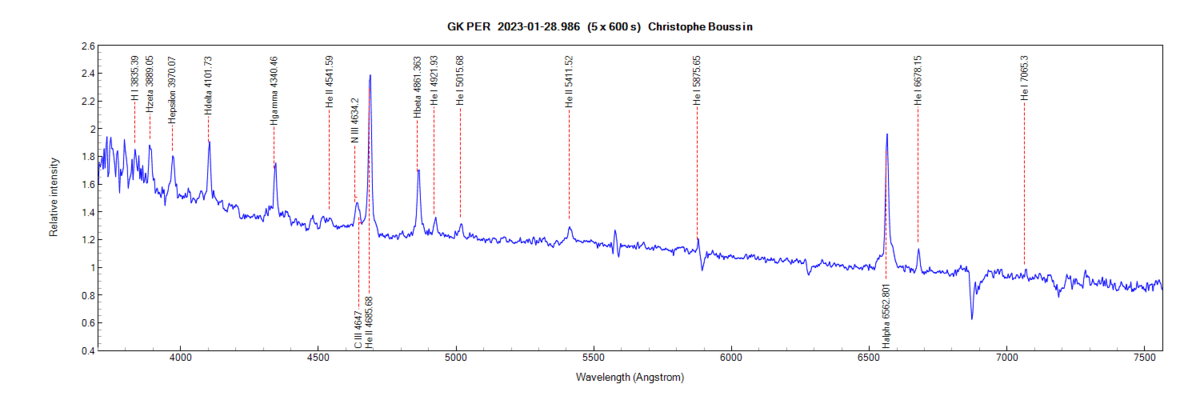

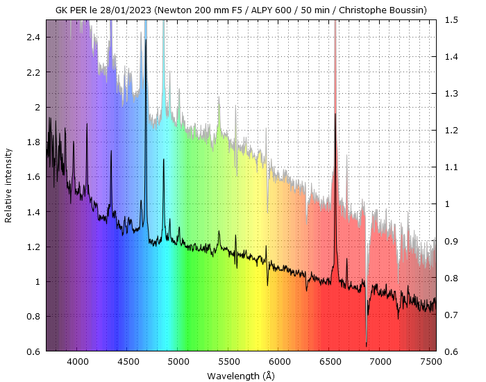

Here, opportunities to observe GK Per are as rare as ever...
The following spectrum was obtained on 28 January at 23:39 UT (resolution of 527, JJ = 2459973.4857) with my Alpy 600 and an acquisition time of 50 min (5 x 600s) :
GK Per on January 28th, 2023

GK Per on January 28th, 2023 (identification of some lines from PlotSpectra)
And now I'm waiting for the next clear night ;) !!
Clear skies to all !!

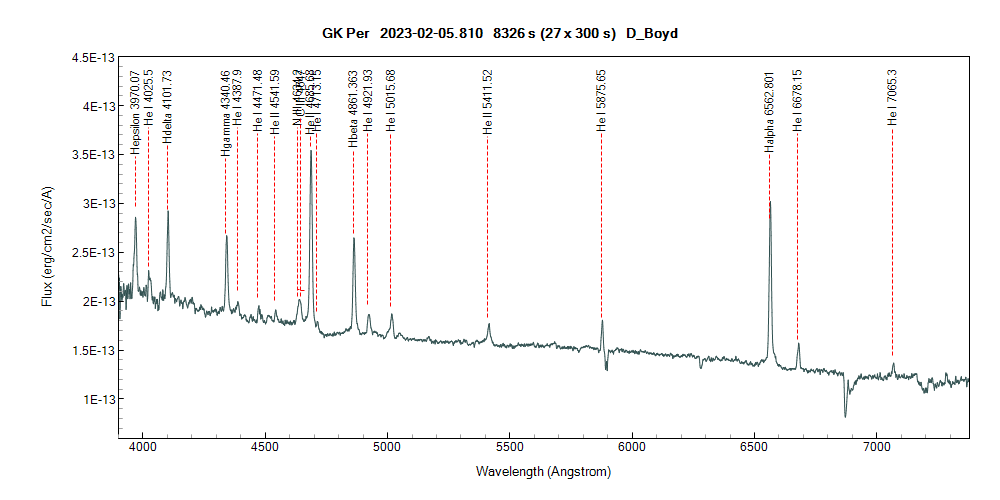

Another spectrum of GK Per as it slowly fades. This was calibrated in absolute flux with a concurrently measured mean V magnitude of 10.95.

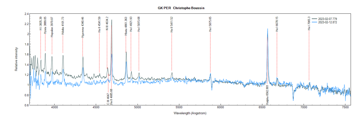

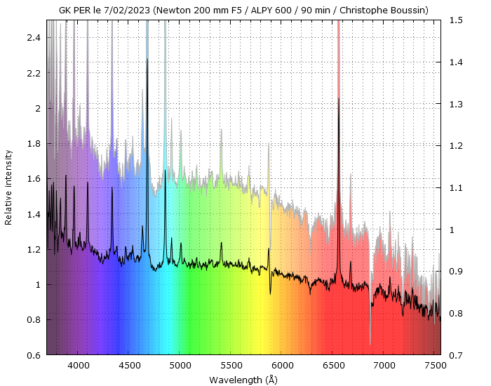

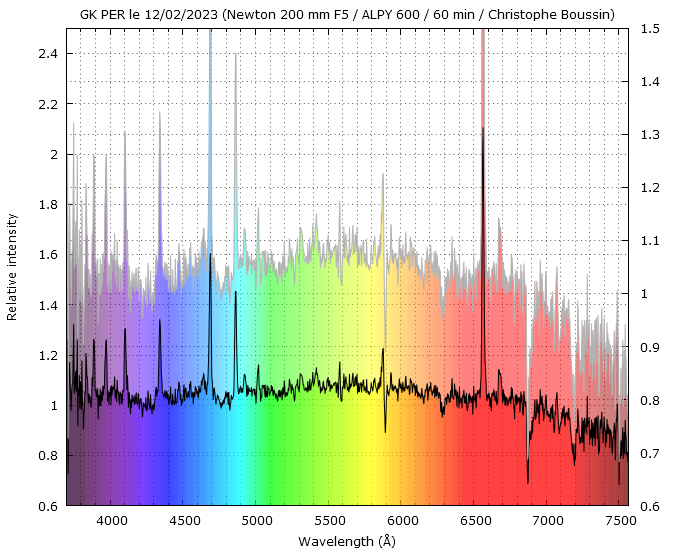

The following spectra were obtained with my Alpy 600 on 7 February at 18:41 UT (resolution of 521, JJ = 2459983.2785) with an acquisition time of 90 min (9 x 600s) and on 12 February at 20:56 UT (resolution of 531, JJ = 2459988.3722) with an acquisition time of 60 min (6 x 600s) :
GK Per on February 7th, 2023
_gkper_20230207_779_Christophe Boussin_3700_7565.png (115.09 KiB) Viewed 16597 times
GK Per on February 12th, 2023
_gkper_20230212_872_Christophe Boussin_corrected.png (114.99 KiB) Viewed 16511 times
GK Per on February 7th and 12th, 2023 (identification of some lines from PlotSpectra)
Note : the 12 February spectrum has been modified with an updated instrumental response !
