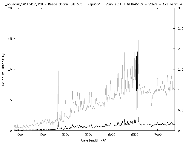

Re: Nova Cyg 2014 = PNV J20214234+3103296
Posted: Thu Apr 17, 2014 10:56 am
by Jacques Montier
The spectrum of the last night with Alpy 600

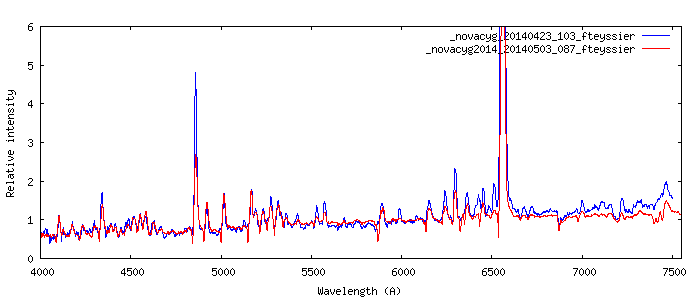

From April 24. Emission lines dropping and p Cygni profiles returning.
Posted: Sun May 04, 2014 12:33 am

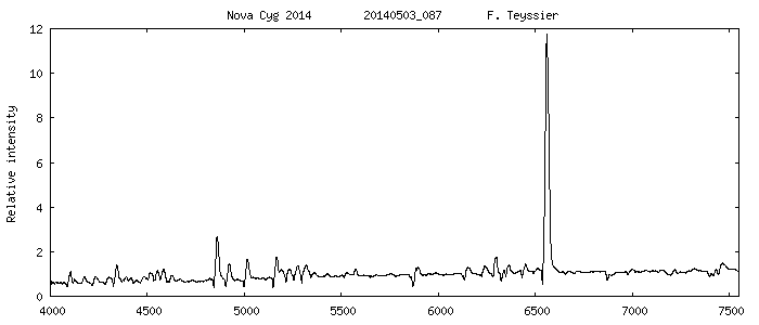

Nova Cyg 2014 the 03-05-2014
Absorptions detected by Tim the 24-05 remains
Comparison with spectrum obtained on 23-05-2014

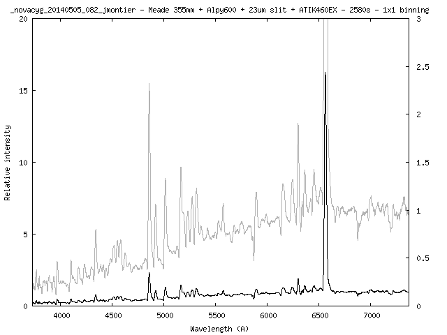

Posted: Mon May 05, 2014 1:19 pm
by Jacques Montier
Nova Cyg Spectrum of the last night (R 650)

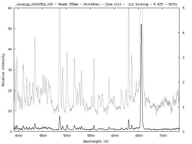

Posted: Fri May 16, 2014 9:14 am
by Jacques Montier
The last Nova Cyg spectrum
Rather surprised by the relative intensity of the Halpha line...
