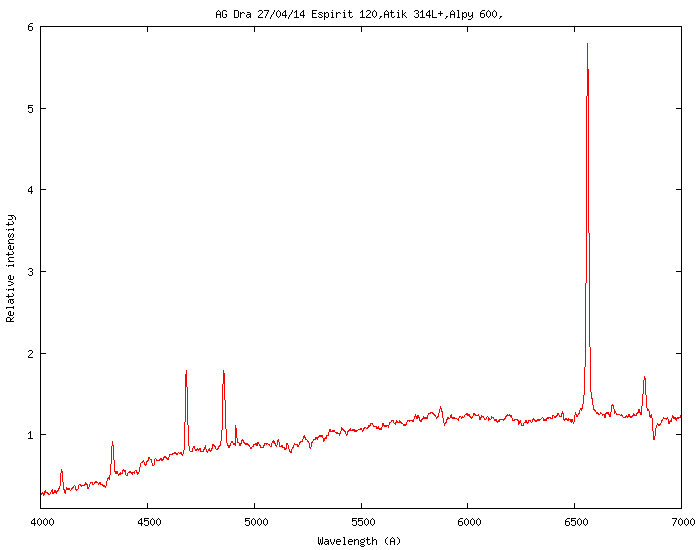

Thanks again Robin!
A little more work and I now have this -
which hopefully looks more like the recognised profile!
regards
Steve
Re: second try at AG Dra
Dear Steve,
Good, it looks correct.
You have just a hot pixel in the red edge of H béta.
Also, for a very precise instrumental response, see http://www.astrosurf.com/buil/isis/guid ... uto_en.htm in which Christian Buil describes the smooth of the curve (" un poco ma non tropo")
If you agree, you can send me the fit file for the ARAS data base
Congratulations for the result
A good learning curve
Regards,

Excellent thanks for that Francois!
I have not sent any fits files to the forum before, do I send you the raw fits or the processed one?. The raw one I have is called AGDra600secs and the ISIS processed one is _AGDra and do I just attach it to a post?
regards
Steve
Hello Steve,
You send me the fit file obtained with ISIS (francoismathieu.teyssier at bbox.fr)
The name of the file must be something like (the treatemnt is automated in ISIS)
_agdra_20140427_029_SteveCulbert
