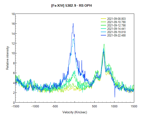

Robin Leadbeater wrote:A new line has appeared at 5303A between 20210911 and 20210919
Confirmed in a spectrum from last night by David Boyd.
https://britastro.org/specdb/data_graph ... s_id=10440
Growing rapidly and now significantly stronger than the adjacent line at 5316A
Yes, Robin,
The coronal line [Fe XIV] which appeared on 2021-09-11 (+/1d) in medium resolution spectra (Joan Guarro, Colin Eldrige, Francois Teyssier)
Energy ionisation ~ 360 eV !

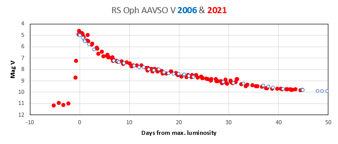

Updated light curve:

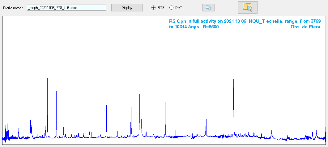

Hello at all,
RS Oph is around the 9 magnitude but it shows high activity in all its regions.
Regards, J.Guarro.
__rs oph activity.png (13.96 KiB) Viewed 26225 times
Great spectrum, Joan,
Large range, very food SNR.
NOUT at is top!
Congratulations,

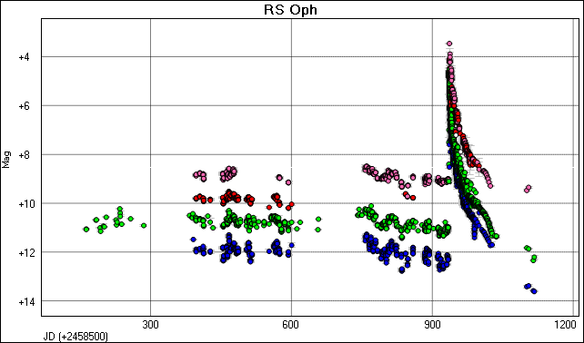

RS Oph is back in the morning sky.
V luminosity is low (~12), one mag under the pre-outburst but the red part of the spectrum should be at a higher level.
New spectra will be very welcome in the database to complete our excellent monitoring of the 2021 event
