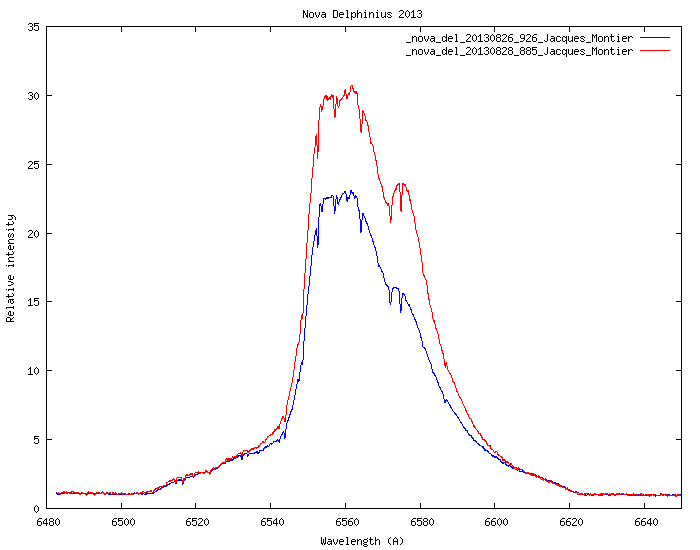

20130828_885 Halpha spectrum with C11 and LhiresIII 2400 t/mm
I confirm the double pic shape on the red part of the alpha line as intensity is still increasing.

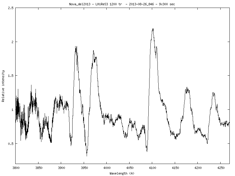

Comme disaient certains assureurs... je l'aurai un jour, je l'aurai.. et ben je l'ai eu.
A force de réflexion, j'ai trouvé où je merdouillais dans le traitement et voilà... c'est beaucoup plus exploitable que ce que j'avais produit hier.
Yesterday, I don't know why, I did not process correctly. I Make up my mind all the evening and, alleluia, I found what was wrong. Here is a more useful picture.
Eric
Eric
- nova del2013-08-26_846.png (8.48 KiB) Viewed 8460 times
- Posts: 1432
Eric B, c'est un superbe spectre des raies du Ca II que tu présente là !!!

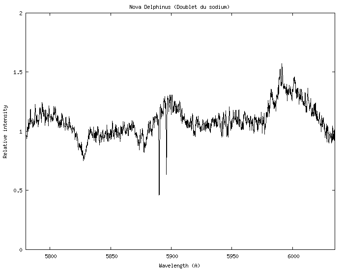

- Posts: 242
Bonsoir,
20130828_982 spectre de la région du doublet du sodium ; C11 + Lhires 2400

- Posts: 1268
Evolution of Halpha line and H beta line during last 48 hours.
In blue : August the 26th
In red : August the 28th

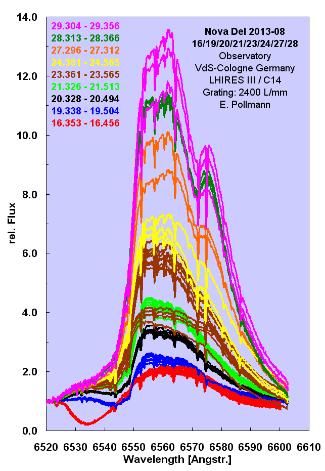

- Posts: 461
In order to play further within the concert of these amazing results:
here the (neverending) Halpha growth of this evening.
The "red shoulder" comes more and more significant.
I am curious what the expert´s explanation regarding of this separation of two velocity areas is.
Ernst
Ernst
