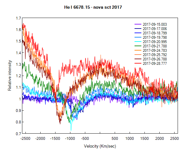

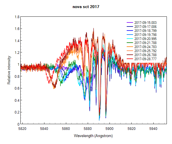

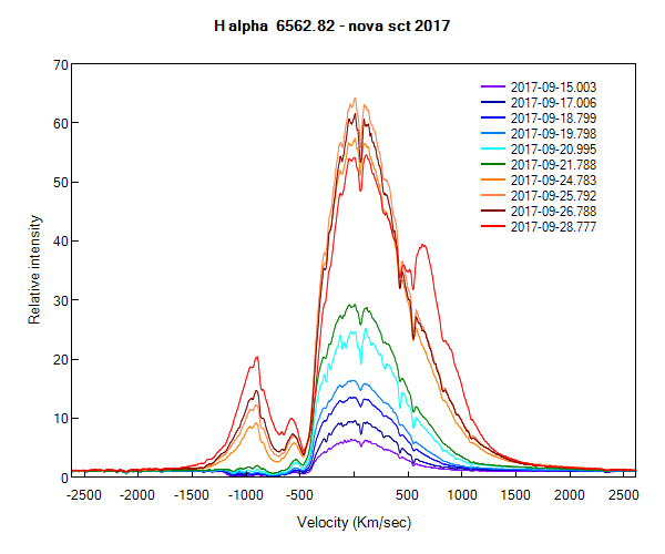

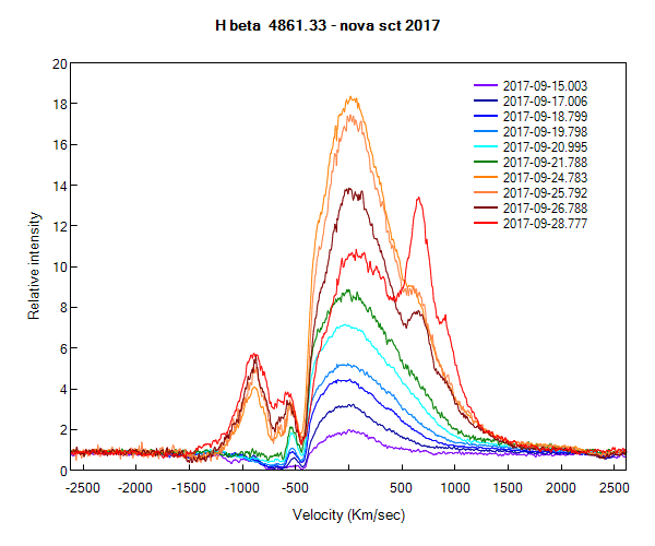

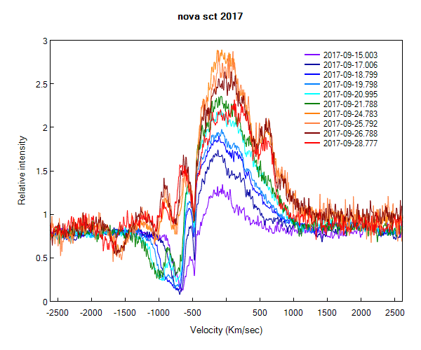

This is the evolution zone Hbeta and Fe II, from 2017 07 26 to 2017 09 28.
Cheers, Joan.

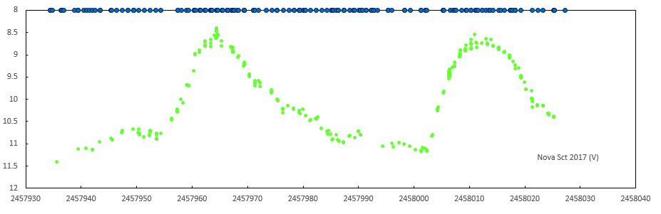

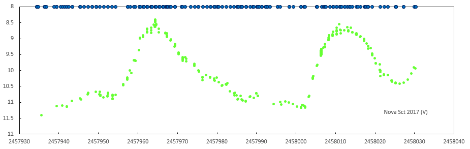

Update of the light curve with the second rise from ARAS data base http://www.astrosurf.com/aras/Aras_Data ... ct2017.htm:
Evolution of some lines during the second decline:
H alpha. At the second maximum, the emission is very weak
This is the typical behavior of the lines during an oscillation, hightlighted by Mac Lauglin: during an oscillation the spectrum tends to regain the aspect it had at the same luminosity

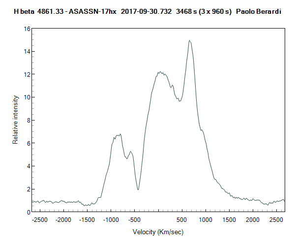

H beta profile from the mast spectrum obtained by Paolo:
Interesting to see the similarity between the two main absorptions vr ~-430 and +460 km/s

Outstanding coverage of this "nova". Last news show that the nova is again rebrightening and is going into his third maximum.
Greetings
Fran

Uptade of the lightcurve and last spectra (Terry, Joan, Paolo, Umberto, Fran)

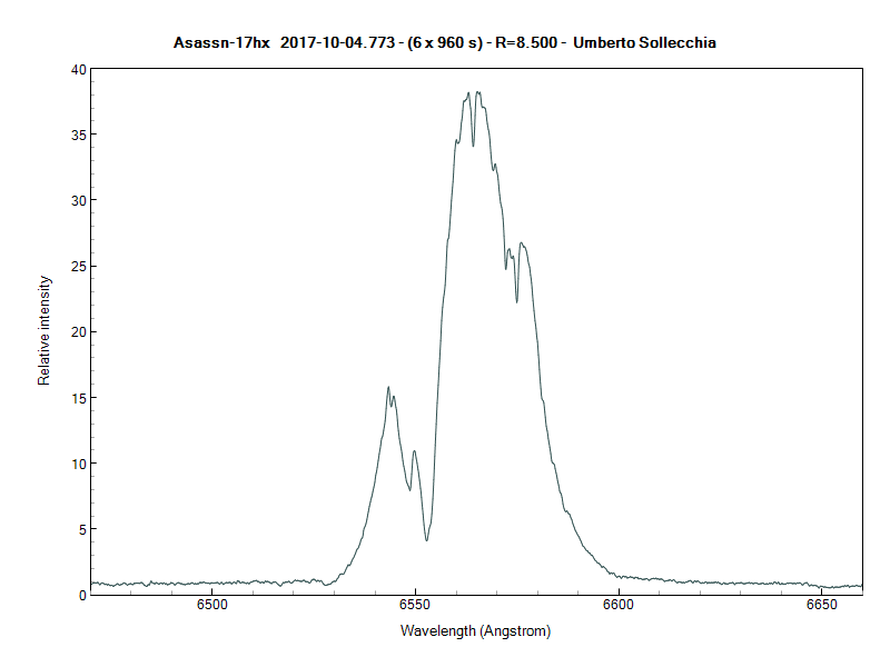

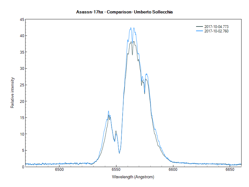

Bonsoir, la nouvelle a de nouveau gagné 1 grandeur. Afin d'évaluer la variation significative, placer le profil de ce soir et une comparaison avec le jour 02-10-2017.
asassn-17hx_20171004_773_Umberto Sollecchia.png (24.05 KiB) Viewed 11563 times

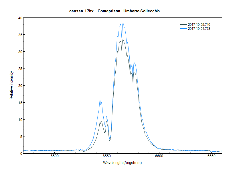

asassn-17hx -Comparison- Umberto Sollecchia.png (34.18 KiB) Viewed 11563 times

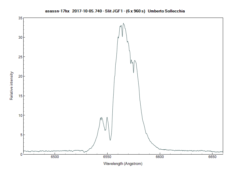

Bonsoir du tout, la danse de la nouvelle continue. Place le profil du jour 05-10-2017 et une comparaison avec le jour 04-10-2017.
asassn-17hx_20171005_740_Umberto Sollecchia.png (23.49 KiB) Viewed 11535 times
asassn-17hx - Comparison -Umberto Sollecchia.png (33.58 KiB) Viewed 11535 times

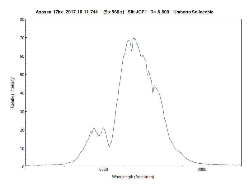

onne journée à tous, placez le profil de la nouvelle observé le 11-10-2017.
asassn-17hx_20171011_744_Umberto Sollecchia.png (21.81 KiB) Viewed 11506 times

As it is seen in the graph of the Umberto. Halpha of the New Sct 2017, has been back in the maximum issue
Regards, Joan.
