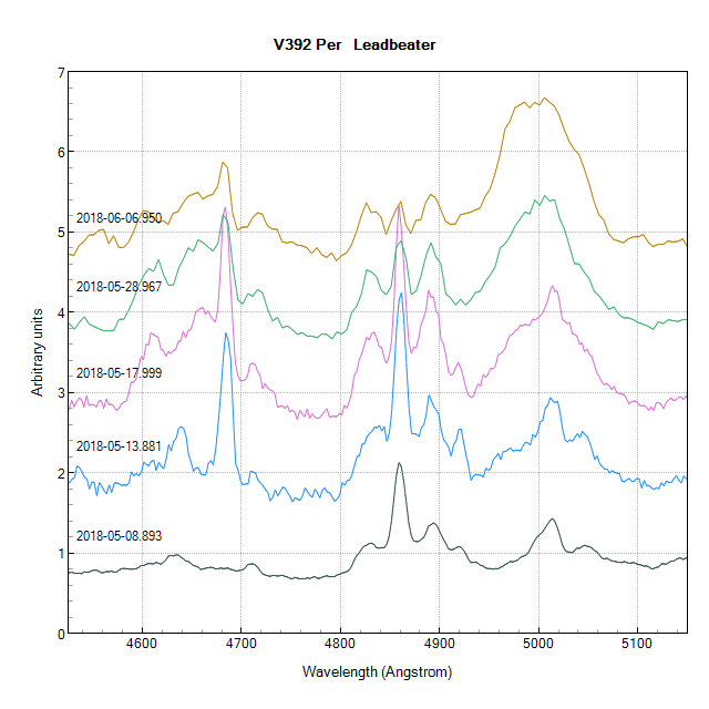

Re: V392 Per in outburst
I see the He II 4686 line mentioned in the Mason Munari paper
"The He ii 4686 Å narrow emission which appears at the onset of the nebular phase in both novae is somewhat controversial. Our
observations suggest that the corresponding line forming region is physically separated from the rest of the ejecta"
Also appeared in the V392Per spectra from 2018-05-13
http://www.spectro-aras.com/forum/viewt ... 120#p10792

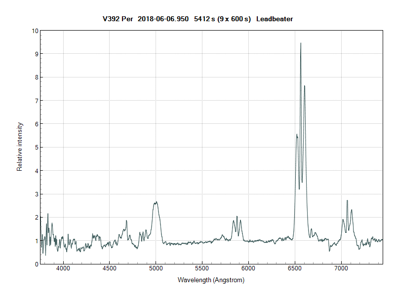

A spectrum from last night, 2018-06-06. Further evolution in the region 4600-5100A, particularly on the blue edge of the broad blended region centred on 5000A
Impressive
The blend could be OIII, 5007 and 4959
There's also a broad line in the red of H gamma
If it is, there's no narrow component. Interesting!

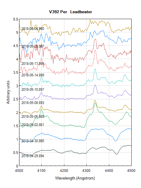

Hi Francois
Here is the region around H gamma/H delta from the start of the outburst to the present. It is probably fainter than mag 13 in B now and the bright sky and the 4.8 air mass means the SNR is rather low in this part of the spectrum unfortunately
