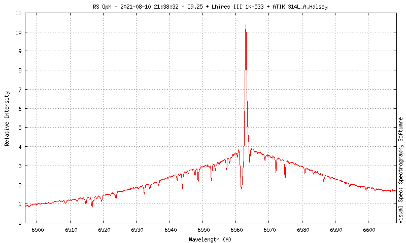

Posted: Wed Aug 11, 2021 3:01 pm
by Alun Halsey
My attempt last night (10th) using my C9.25 and Lhires III with 23m slit riding on a CEM60,captured 9x60sec images. I chose Vega as reference star,and RS Oph profile normalized at wavelength 6498 to 6503. Used ISIS to carry out calibration and Vspec to create chart.
_rsoph_20210810_902_alun halsey.png (7.27 KiB) Viewed 78488 times
Alun Halsey
