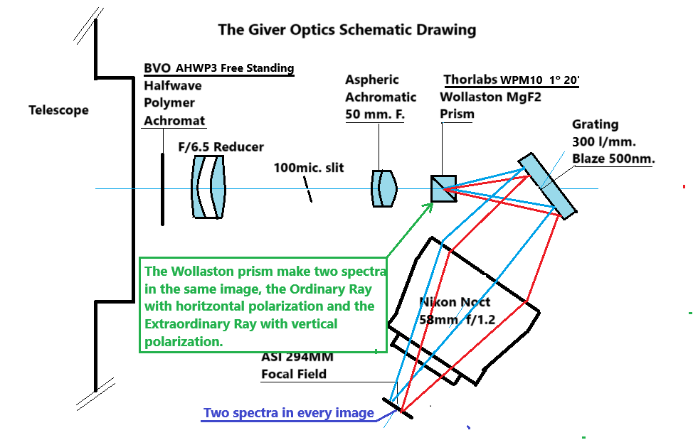

- Posts: 731
Re: POLARIMETER DEVICE PROJECT
Bonjour Guillaume,
At the moment all is new in this sense for me. So, it's time to learn about spectropolarimetry, before showing new results.
Like you, the weather hasn't been good here in these last two months, but some test was allowed.
You can see in this sketch the answer to your question. Specifically, the BVO Halfwave Achromatic Polymer was recommended by Gary Cole who has using it for a lot of years.
I hope that will be useful for your project, I would like to know something about it.
Cheers, Joan.
Cheers, Joan.

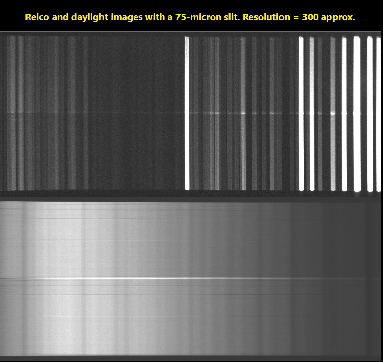

- Posts: 731
The practice has thought that the internal tungsten light, - that is very useful for the NOU_T echelle -, doesn't work with The Giver, therefore, to obtain good flats, this type of light has to enter through the telescope.
But, on the other hand, it seems, there are opinions that they said the use of flats isn't a requisite for taking a good spectropolarimetry. Just in case, I made an external tungsten flat light diffuser, and it's ready for it.
I also have changed the 100-micron air slit for a 75-micron chrome on glass one, with the reason to do good guiding when I'll need to use the same target for it, overall if this star is weak and there is no other.
All are ready for more tests now.
Cheers, Joan.
Cheers, Joan.
- DEFINITIVE CONFIGURATION.png (637.86 KiB) Viewed 172772 times

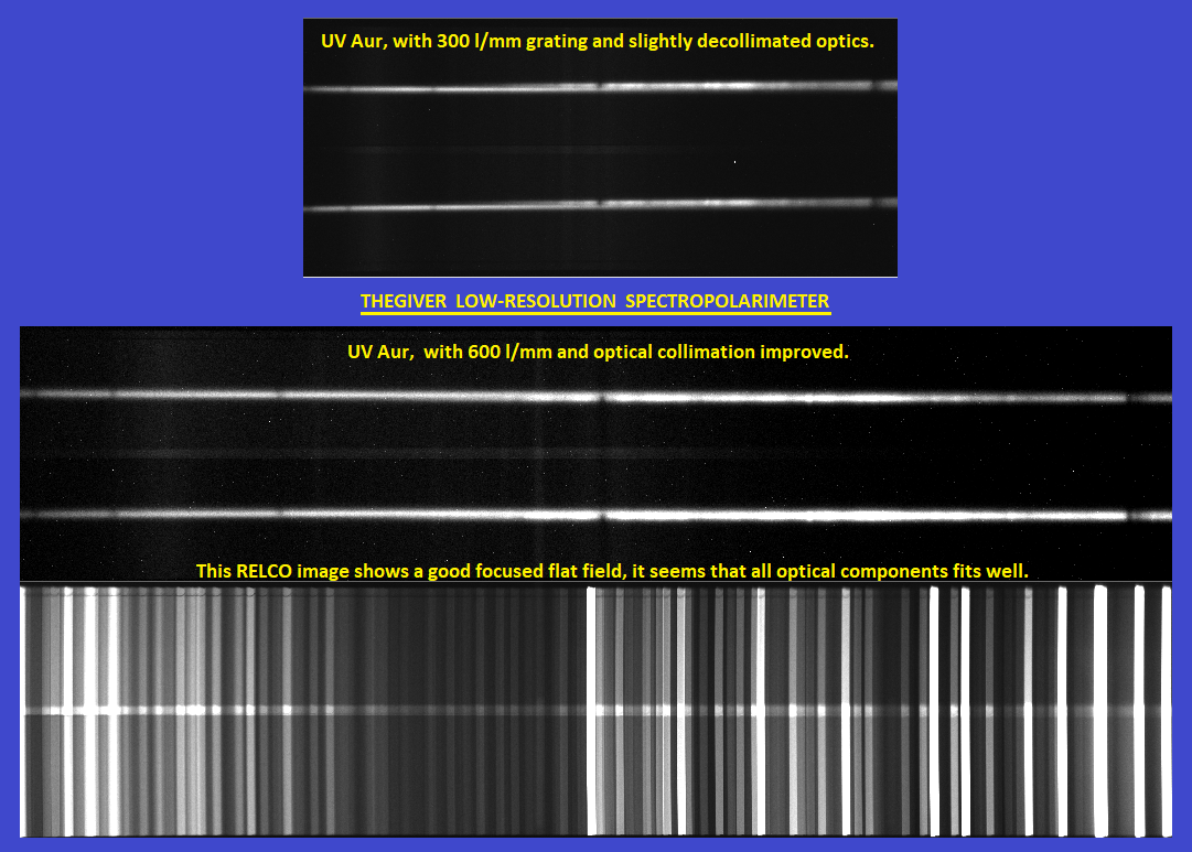

- Posts: 731
François Teyssier was right when he said that the UV Aur double image was a decollimated optics result.
In this picture you can see the new setup of TheGiver low-resolution spectropolarimeter.
Cheers, J. Guarro.
Cheers, J. Guarro.
- THEGIVER 300 600.png (590.48 KiB) Viewed 172249 times

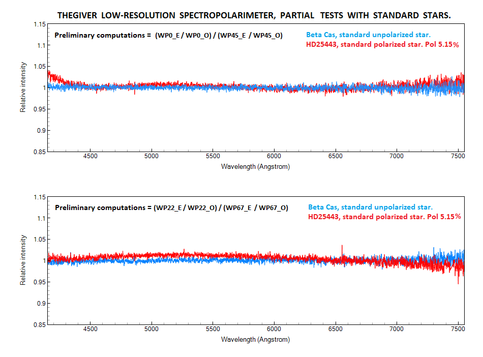

- Posts: 731
Meanwhile, their software is being developed, you can see other evidence that TheGiver spectropolarimeter works well.
Greetings, J. Guarro.
- PRELIMINARY COMPUTATIOS 1.png (109.96 KiB) Viewed 172204 times

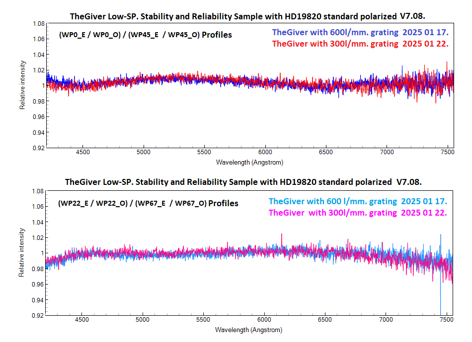

- Posts: 731
Seeing these graphics you can judge and take out your own opinions about the stability and reliability degree of TheGiver low-resolution SP.
- image.png (140.82 KiB) Viewed 172170 times

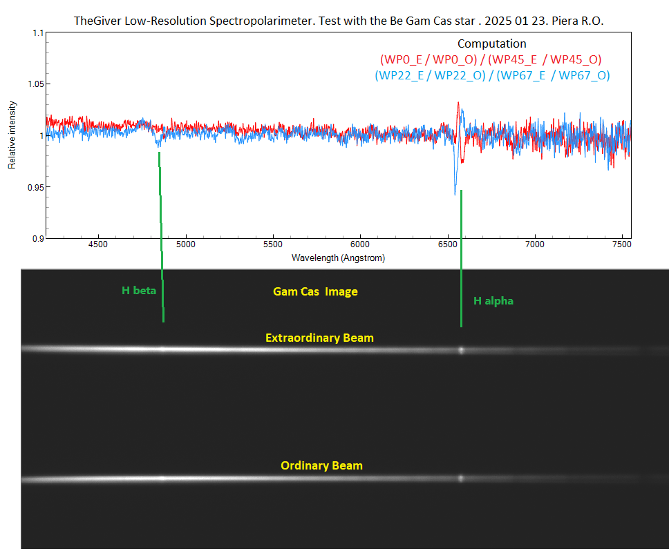

- Posts: 731
With Gam Cas you can see another example of how TheGiver works.
Cheers, Joan.
Cheers, Joan.
- gamcas_0000-e_20250123_779_J. Guarro2.png (198.36 KiB) Viewed 172126 times

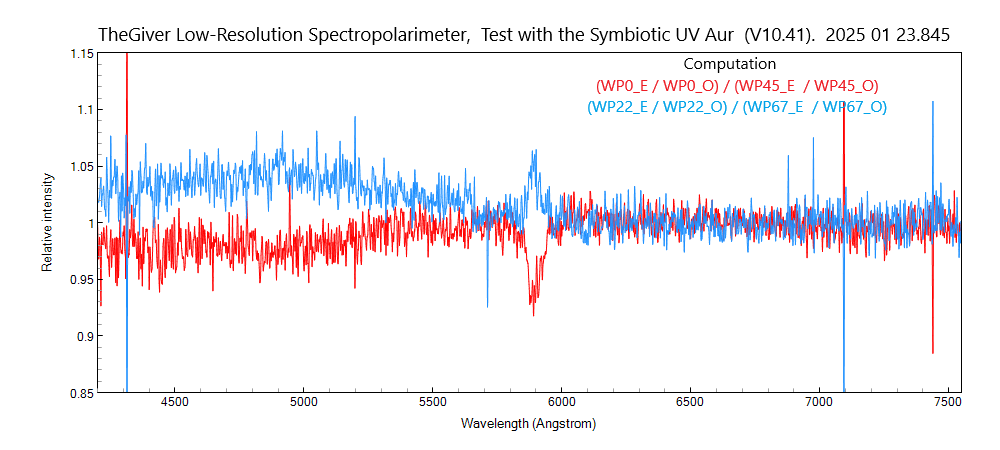

- Posts: 731
Spectropolarimetry could open a new world before us, a new skyline for our knowledge.
This graphic is another sample of it, the tool exists, so only lacks one good software now.
Regards, J. Guarro.
Regards, J. Guarro.
- uvaur_0000-e_20250123_845_J. Guarro2.png (101.64 KiB) Viewed 171273 times
