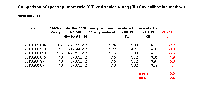

Using the same technique to calculate the absolute flux was my next step and was very simple. I used Christian's relative and absolute flux calibrated ALPY/LISA spectra as a test. The results are in the attached table
I used the AAVSO Vmag data and the formula that Christian uses in method 1 step 2 here
http://www.astrosurf.com/buil/calibrati ... ration.htm
to calculate the flux at 5556A and compared it with the calculated weighted mean relative flux in the Vmag passband from the relative flux calibrated spectra
The relative flux spectrum is then just multiplied by Flux5556A / (weighted mean relative flux) to give the spectrum in absolute flux.
The two methods (Christian's and mine) give very similar answers within a few percent. (probably dependent on the accuracy of the AAVSO Vmag data)

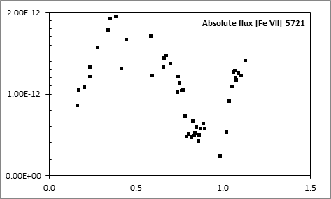

sur la page : http://www.astronomie-amateur.fr/feuill ... Cyg_2.html
Abscisse = orbital phase
avec notemment calcul de la température de la naine blanche à partir des flux absolus Hb, HeII
Enfin, last but not least, Steve travaille en ce moment sur une méthode pour calibrer nos spectres à partir des flux absolus qu'il a calculé sur les spectres NOT et Ondrejov.
