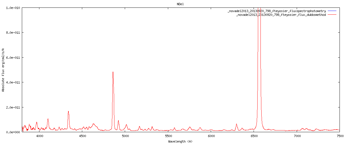

J'ai repris ta méthode avec le spectre du 20/09
en utilisant V = 8.09 (SRIC-AAVSO)
puis comparé le spectre obtenu avec le spectre calibré que j'avais obtenu par la méthode spectrophotométrique de Christian (standart HD196544)
C'est parfait; tellement parfait que j'ai recommencé le traitement une deuxième fois, pensant avoir commis un erreur.

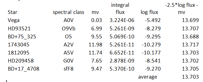

the determination of the calibration constant gave me a lot of headaches. The problem is that there are more magnitude systems than astronomers, if you look up for Johnson UBVRI you find several different response curves, e.g. here:
http://ulisse.pd.astro.it/Astro/ADPS/Systems/index.html
I chose Bessell_V because it corresponds well with some Johnson V curves and to get consistent values with your calculations. No need to increase the confusion by introducing yet another system.
In addition there are different values for the flux of reference stars.
I finally adopted a value which gives a good agreement between the spectra in calspec database (from ISIS) and the V magnitudes indicated there, using Bessell-V, also from ISIS:
calibration constant.PNG (13.92 KiB) Viewed 97953 times
The good thing is that the equation works independent of spectral class, so I assume that for the HST calibration they use a quite similar response curve.
Using the definition of Vega system I found values closer to your value of 13.73. The difference comes maybe also from the fact that the center of gravity of the Bessell curve is at 548 nm and not at 555 nm, the absolute flux specified at different wavelengths (549 nm in Astro Virginia, 548 nm in Oke Schild 1970, 555 nm in Hayes Latham 1975). It is not surprising therefore to get slightly different values. I honestly do not know what is the current correct Vega flux value, traceable to standards of the metric system.

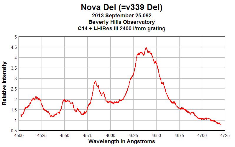

Here's one of my spectra of Nova Del, this one from September 25th. I'm not 100% certain of the wavelength calibration as I only have a Ne source lamp. I was able to identify some fairly faint lines, partly with the help of Robin's article here, but the probability that I misidentified some of the lines is not zero! Still, using the lines I found I was able to get a fairly good fit (+/- 0.04 Angstroms) with a low-order Legendre polynomial. I'm currently adding the necessary keywords to the FITS headers for submission to the database. I'll also post an image of one of my calibration spectra along with a list of lines I was using to determine the wavelength calibration.

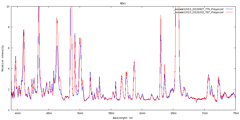

Flux calibtared eShel spectrum taken the Sept. 30.7 compared with spectrum taken the Sept. 24.8:
The intensities of all features decrease (also Halpha) (dust absorption ?)
Same but in relative intensity for compare to Terry spectra:
