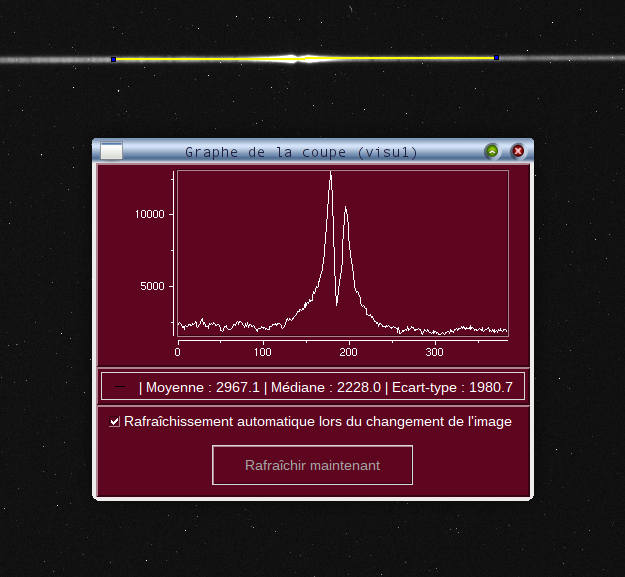

Dramatic change of H alpha profile
Campaign on the request of Dr Ausgustin Skopal
H alpha line at R > 10,000
and low res spectra

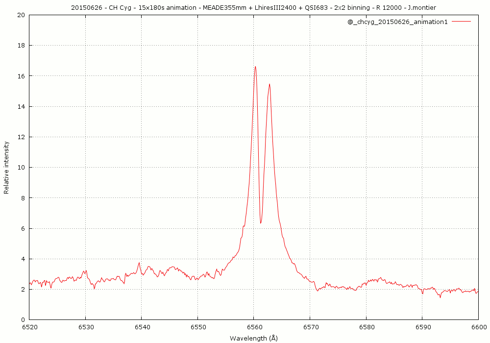

Re: Dramatic change of H alpha profile
Post by Jacques Montier »
CH Cyg spectrum of the last night 2015/06/26
Animation of 15 profiles of 180s each.
The small Halpha line oscillation seems to go on.
Regards,
Jacques Montier

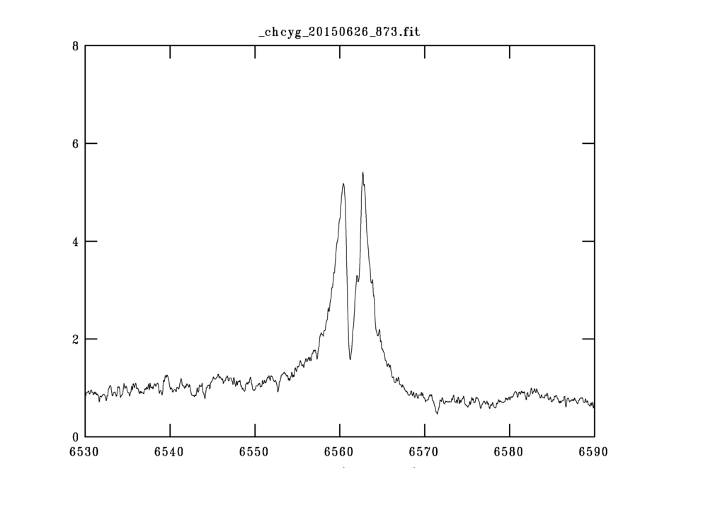

Next evening (5 minute exposures, 25cm Newt, LHires/2400/15um, R~20K-18K, break between .897 and 911):
It was very slowly fading (note the 5:1 peak ratio to continumm already lower than the 8:1 outbreak we saw - but still seem to be double peaked).
After more than 1.5 hour observation switched to another target.

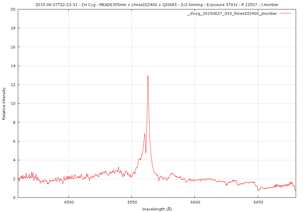

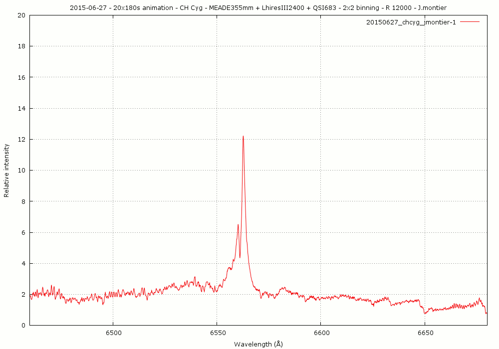

On 2015/06/27, blue wing of Halpha line has decreased a lot.
Peter, you observed the beginning, so we missed the transition...
Here is the animation with 20x180s spectra.
The profile looks quiet.
Jacques Montier
IAU code J23

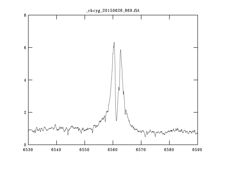

Yesterday it had double peak again (6:1 - 5:1 ratio of Ha/cont., Lhires 2400/mm, 15um slit, R~25K, 13 x 5 min):
Taken through randomly going over clouds (= variable SNR), finally had to give up.

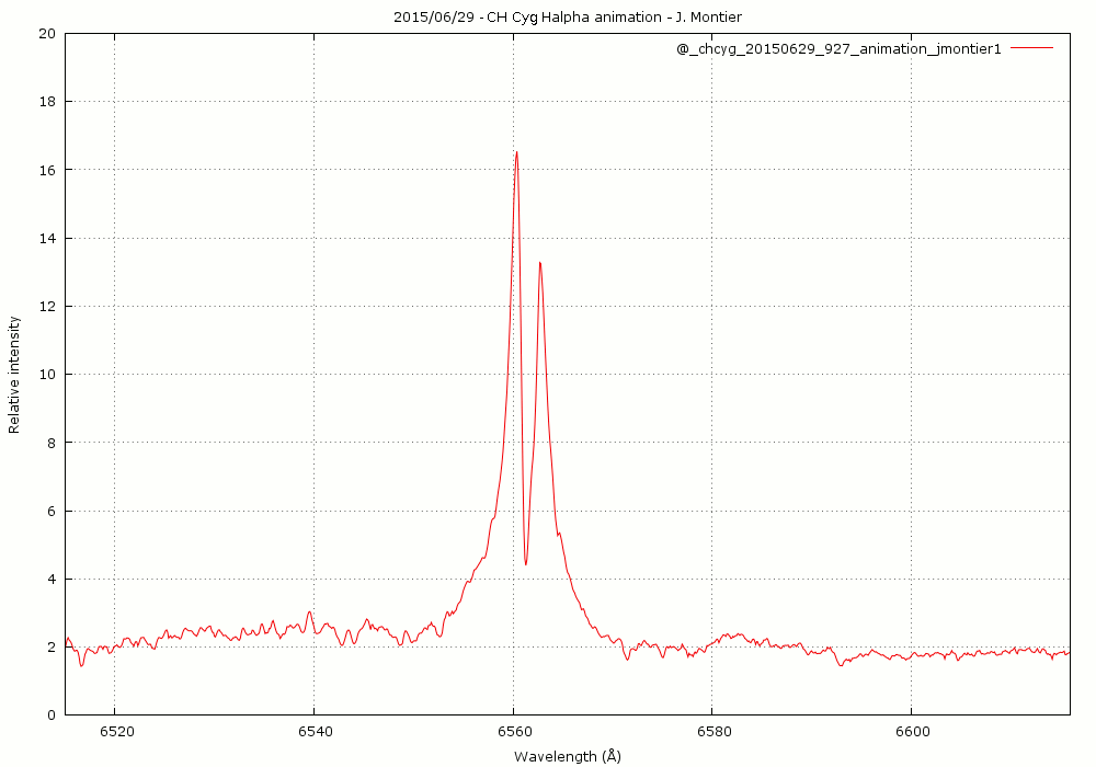

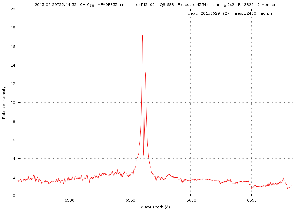

CH Cyg spectrum of the last night on 2015/06/29
Animation with 24x180s spectra
Double peak again with a very impressive blue wing Halpha line.
PS : a strange and slight wavelength shift along the 24x180s spectra ; neon calibration lines moving during monitoring with LhiresIII ?
Last edited by Jacques Montier on Tue Jun 30, 2015 10:20 am, edited 1 time in total.
Jacques Montier
IAU code J23

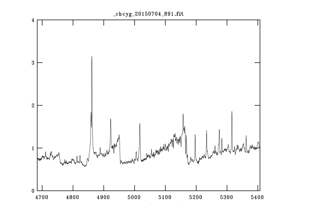

Another animation of CH Cyg : time serie of 64 exposures of 180s each (3H)
For Halpha
For H Beta (see the small emission line near 4888 Â)
Yesterday I was experimenting around H-beta with LHires + 600/mm + 15um slit, got around R~3000 in blue (which I'm satisfied because blue is less good at res. - at blue end, I can't even focus properly all the range).
3 minute exposures, with a few cal. pauses:
Interpolated 3 times a ref.star Iot Cyg.
Took a bit few Ne/Ar manually (hopefully automated today...) but in return, exposures quite continuous with 3 bigger breaks.
Processed by ISIS, other than ref. star interpolation have not touched the continuum.
Note: this is also my lesson to get more precise calibration, after returning to lower it's more obvious...
- Peter
