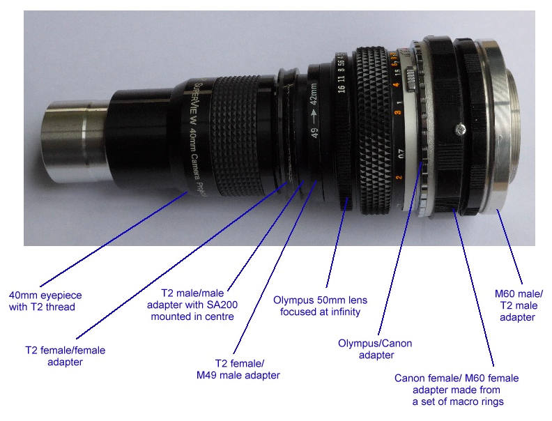

Sorry no. I only used this configuration with a DSLR once once to see if it would work. Spectroscopy is much easier with a mono astro camera

I also have an Atik314+ but i don't have an adapter to connect the camera to the objectif photo 50 mm.
what's your adapter ?

I used many adapters from my junk box screwed together together to convert an Olympus lens to T2.
You can do it much easier though using this adapter
https://www.teleskop-express.de/shop/pr ... ength.html
plus an adapter of the right length to reduce to 42mm from the list there

Hello robin,
what is the adapter of the right length to reduce to 42mm ?

Sebastien Berriot wrote:Hello robin,
I do not know but you can calculate it (camera lens to M48 + M48 to T2 + atk 314 back focus = back focus of the camera lens) or you can ask Teleskop Service
