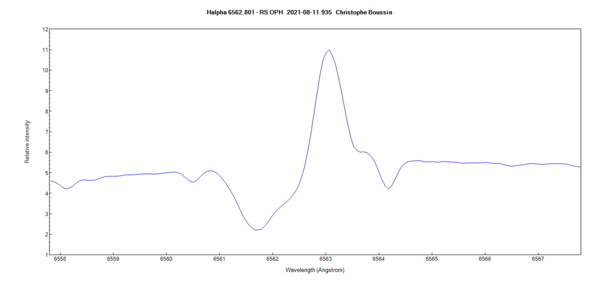

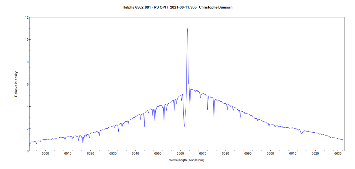

Finally a clear sky to follow the evolution of the RS Oph outburst !!
Here is my contribution with a spectrum of the Halpha line at high resolution obtained on August 11 at 22 h 26 TU (resolution of 18696, JJ = 2459438.435) with my LHIRES III (grating of 2400 lines / mm, acquisition time of 30 min (3 x 600s)).
Halpha line of RS Oph on August 11th 2021
Halpha line of RS Oph on August 11th 2021 (zoom)
More than ever, clear skies to all !!

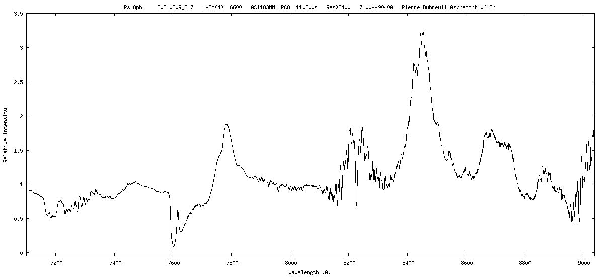

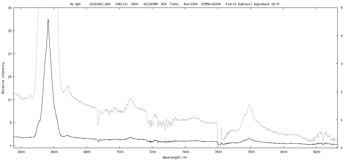

Bonjour à tous
Un peu de ciel hier soir après des orages dans la journée.
Spectre réalisé avec le spectrographe UVEX(4) G600 750nm RC8 Slit 23µ ...
détails autour de O I 8446
François, si tu à quelques infos sur ce profil ?
Rs Oph proche IR
Rs Oph proche IR
_nocacas2021_20210812_811_Pierre Dubreuil.png (9.23 KiB) Viewed 30521 times
Et avec H-Alpha
Rs Oph  H-alpha + IR
Rs Oph H-alpha + IR
Rs Oph 20210812_860_Pierre Dubreuil.png (9 KiB) Viewed 30404 times
j'envois le spectre FIT

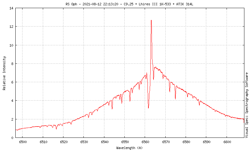

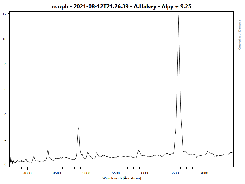

Having both my Alpy 600 and Lhires III attached to C9.25 via flip mirror I managed to acquire lo and hi res spectra last night (12th). Acquisition time for Alpy working at f/6,90 seconds (9x10sec) and
acquisition time for Lhires 21 minutes (7x180sec) both instruments with 23 micron slit.
rs oph_20210812T212639.png (26.93 KiB) Viewed 30512 times
_rsoph_20210812_926_alun halsey.png (7.12 KiB) Viewed 30512 times
Alun

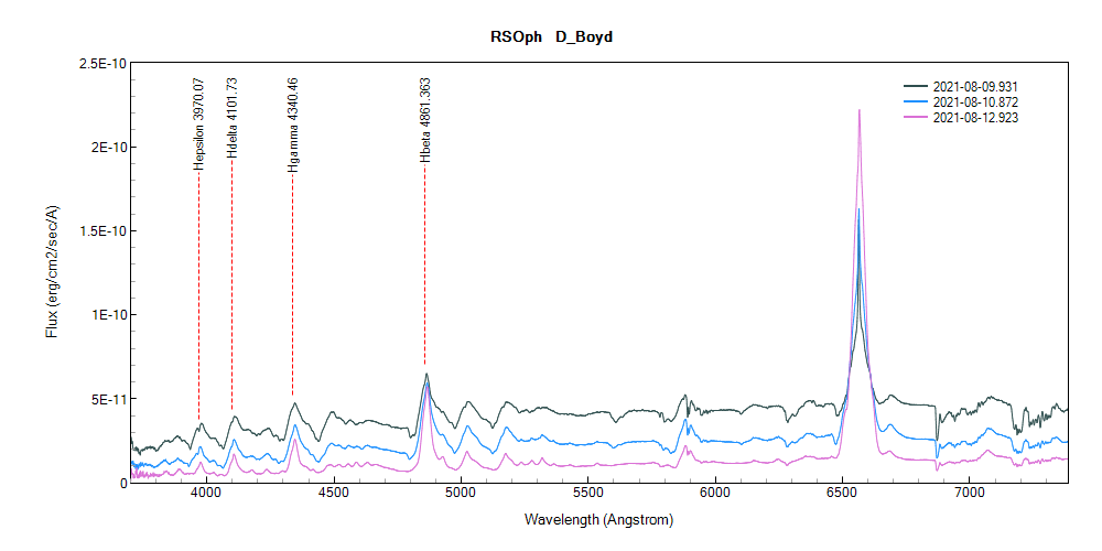

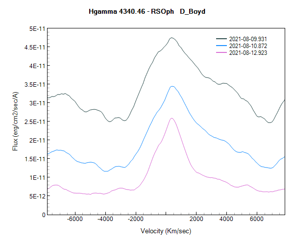

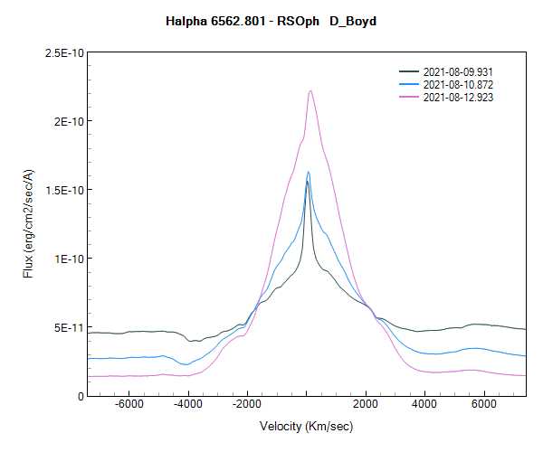

Posted: Fri Aug 13, 2021 11:53 am

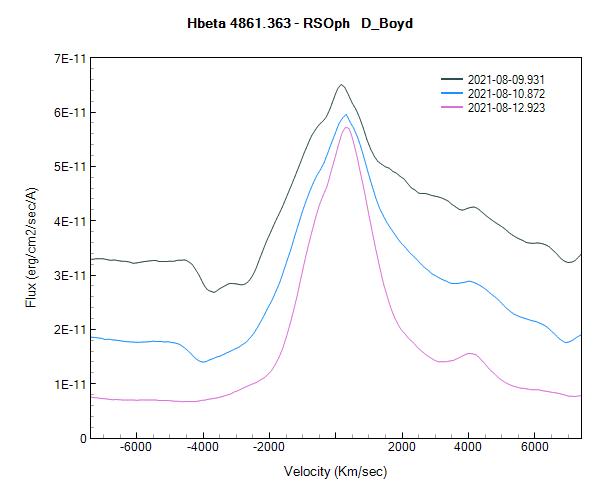

by David Boyd
Continuum flux level dropping as the magnitude fades, V=4.88, 5.44, 6.24 for the 3 spectra below.
H-alpha now less sharply peaked, line flux has increased 3 times, peak velocity relative to rest wavelength increased from ~+30 km/s to +120 km/s
H-beta narrower, line flux unchanged, peak velocity relative to rest wavelength increased from ~+160 km/s to +320 km/s
H-gamma narrower, line flux reduced by factor 0.4, peak velocity relative to rest wavelength steady at ~+360 km/s
RS Oph H-alpha.png (23.44 KiB) Viewed 30479 times
RS Oph H-beta.png (24.17 KiB) Viewed 30479 times
RS Oph H-gamma.png (23.14 KiB) Viewed 30479 times

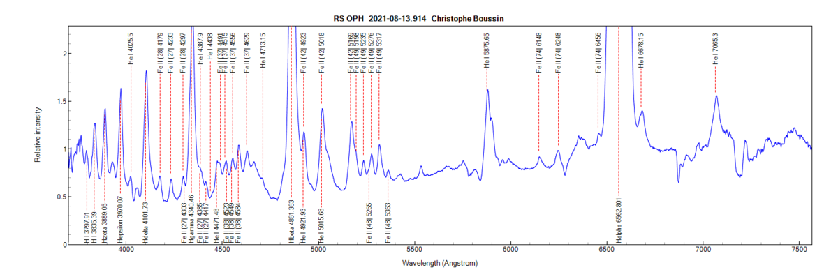

by Christophe Boussin

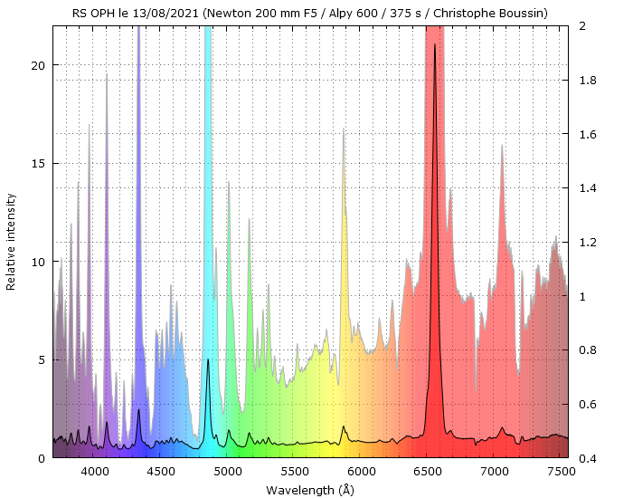

Here is my update for the monitoring of the outburst of RS Oph with a new spectrum obtained the 13th of August at 21 h 56 TU (resolution of 520, JJ = 2459440.4137) with my Alpy 600 and an acquisition time of 375 s (25 x 15 s) :
RS Oph on August 13th, 2021
_rsoph_20210813_914_Christophe Boussin_3700_7565.png (100.25 KiB) Viewed 30350 times
RS Oph on August 13th, 2021 (tentative identification of some lines from PlotSpectra)
Clear skies to all !!
