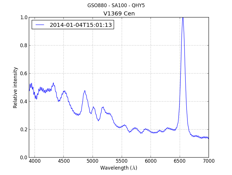

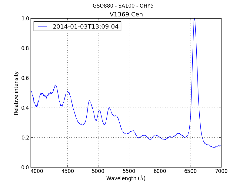

Belated SA100 results from the 3rd and 4th of Jan attached. Hb line is very faint on the 3rd.

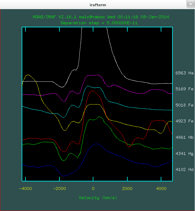

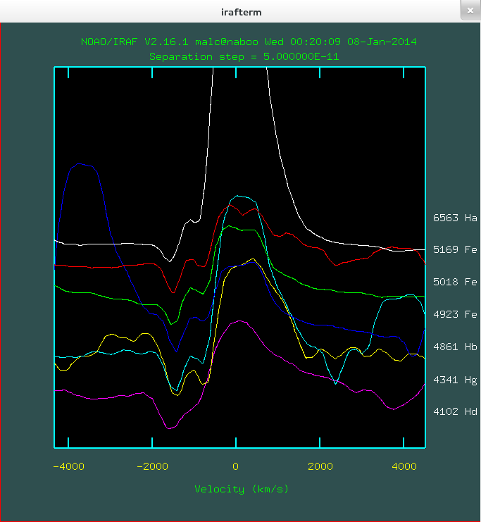

Steve has recommended we plot against velocity rather than wavelength to reveal structures and changes.
Here is an overplot of Ha, Hb, Hg, Hd, FeII 4923, FeII 5018 and FeII 5169 from Terry Bohlsen's spectra of Dec 28th.
And the same treatment from 9 days later on the 5th Jan.
There is a considerable increase in velocity for the two absorption features between the two dates. There also seems to be a slight trend of lower velocity for lower wavelength.

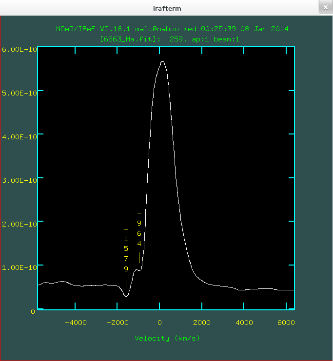

Here is the Ha line with the absorption minima velocities marked. The 25th Dec:
And the 5th Jan:
And the 5th Jan:

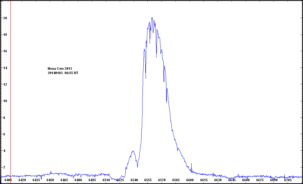

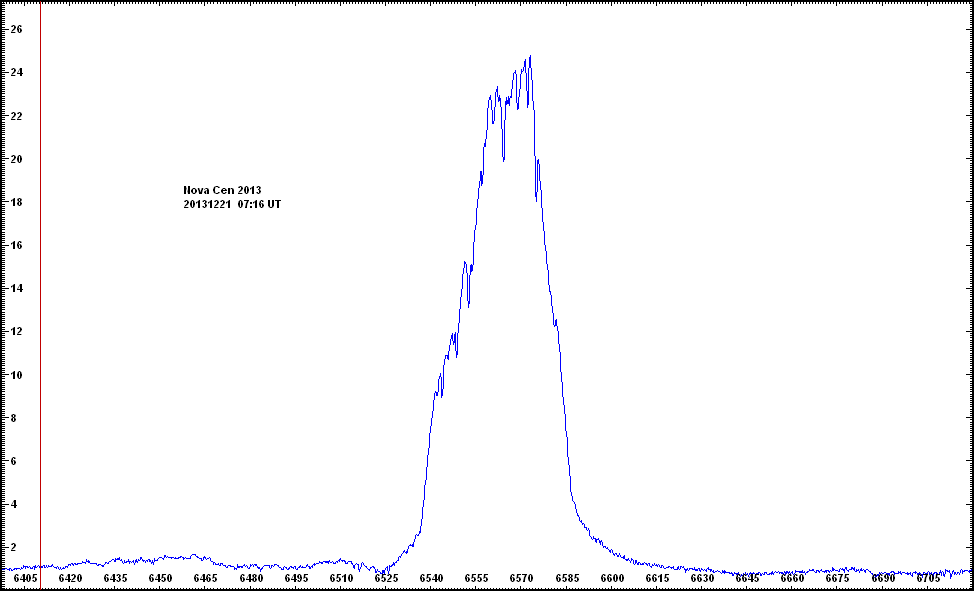

Weather has not been favourable for us over the last weeks (summer is usually very hot and wet in this part of Brazil). Below please find what could be done in the period:
Spectra of V1369 Cen taken on Dec 21, 2013 and Jan 03, 2014, by Rogerio Marcon (acq´n) and Tasso Napoleao (red´n). Exposure 600s. Observing site: Campinas, SP, Brazil (22.792271 S, 47.070032 W, height 597m). Spectroscope R=11 000 (grating 2400 l/mm), Newtonian scope 315mm, Audine camera (KAF 1602), all equipment built by R. Marcon. Pre-treatment and reduction made with Maxim DL and VSpec 4.1.2.
Our Jan 3 profile shows a kind of P-Cygni dip which appears to be the same already visible on Ken´s and Terry´s spectra taken on late December / early January.
H-Alpha has apparently been weakening gradually since the last spectra we had taken (Dec 19).
