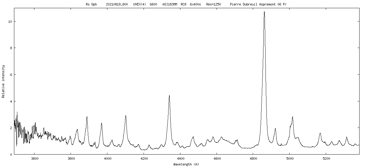

Posted: Thu Aug 19, 2021 9:21 pm
by Dubreuil Pierre
Bonsoir
Nova proche l'UV ce soir
reseau pas optimal !
UVEX(4), G600 750nm, RC8, slit 23µ
UVEC(4)  G600 UV
UVEC(4) G600 UV
Rs Oph 2021_20210819_UV Pierre Dubreuil.png (8.46 KiB) Viewed 18057 times
La Lune commence à gêner un peu !

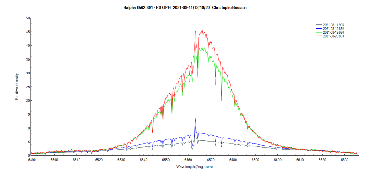

by Christophe Boussin
Not so easy to follow the RS Oph outburst with the parade of clouds the last few days !!
Here is a comparison between my three last spectra the Halpha line of RS Oph at high resolution on August 12 at 21 h 24 TU (resolution of 16932, JJ = 2459439.3915, acquisition time of 70 min (7 x 600s)), on August 19 at 22 h 19 TU (resolution of 18039, JJ = 2459446.4296, acquisition time of 10 min (1 x 600s)) and on August 20 at 21 h 12 TU (resolution of 18575, JJ = 2459447.3835, acquisition time of 50 min (5 x 600s)) obtained with my LHIRES III (grating of 2400 lines / mm) and the previous one, on August 11.
Halpha line of RS Oph on August 11th, 12th, 19th and 20th 2021
What a dramatic change in the profile of the Halpha line in a few days !!
Clear skies to all !!
