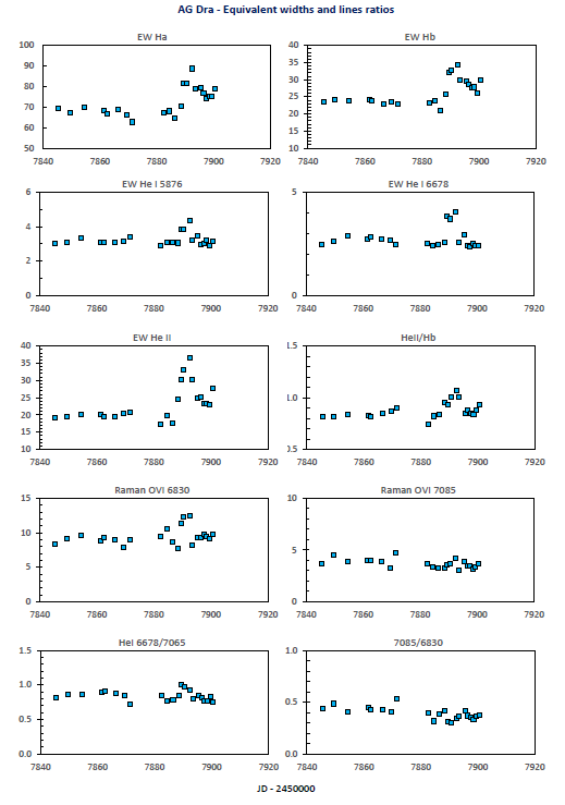

Increase of He II, and Balmer lines intensities in the last spectrum obtained by Joan
Equivalent widths mesaured on Echelle spectra:
New observations strongly welcome for the next days
Stormy weather here
Posted: Mon May 29, 2017 6:27 pm
by Joan Guarro Flo
These graphs, are a complement of the François's anterior explanation.
This is de first service of the Linx.
Today is de second day cloud, the weather will improve on next Wednesday.
Regards, J. Guarro.

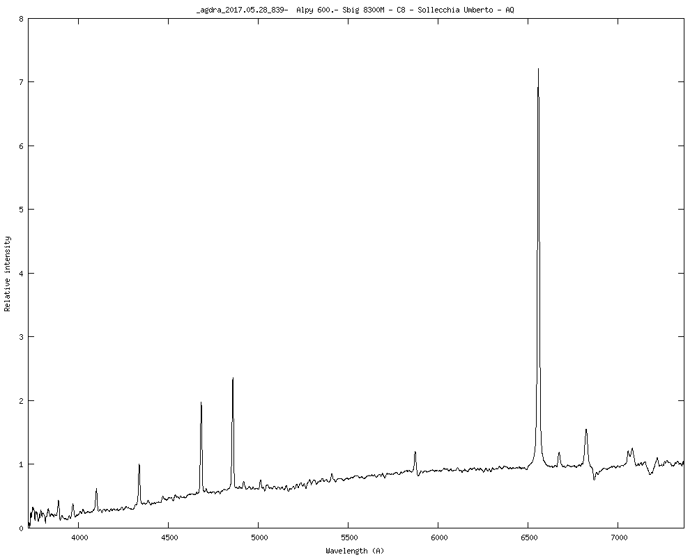

Posted: Tue May 30, 2017 2:22 pm
by umberto sollecchia
Bonjour à tous, placez le profil d'observation de la nuit 28/05/2017.
Profilo Ag Dra.png (7.73 KiB) Viewed 8422 times

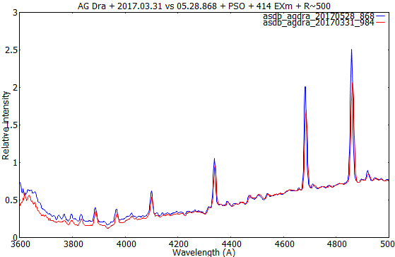

by James Foster
I've been having issues processing my LISA spectra...think I just solved it with another tune-up at the scope.
Here is AG Dra on 28May17:
I labeled the probable He lines...Hope we see more "fireworks" in this system!

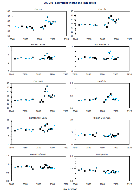

Posted: Wed May 31, 2017 5:17 pm
According to last AAVSO observations from the previous night, there is an increase of brightness of AG Dra in all filters. Of course, it is based only on the observations by one observer, but nevertheless, also according to your last spectroscopic observation (the increase of EWs of Balmer lines and He II), it is worth monitoring the star in the next days.
Clear sky last night
The fit is now in the base, Jaroslav
Significant increase of Raman OVI
Update of EW from echelle spectra
James: the identification of He I lines is correct
Your spectrum is welcome in the base!
Umberto: excellent coverage!

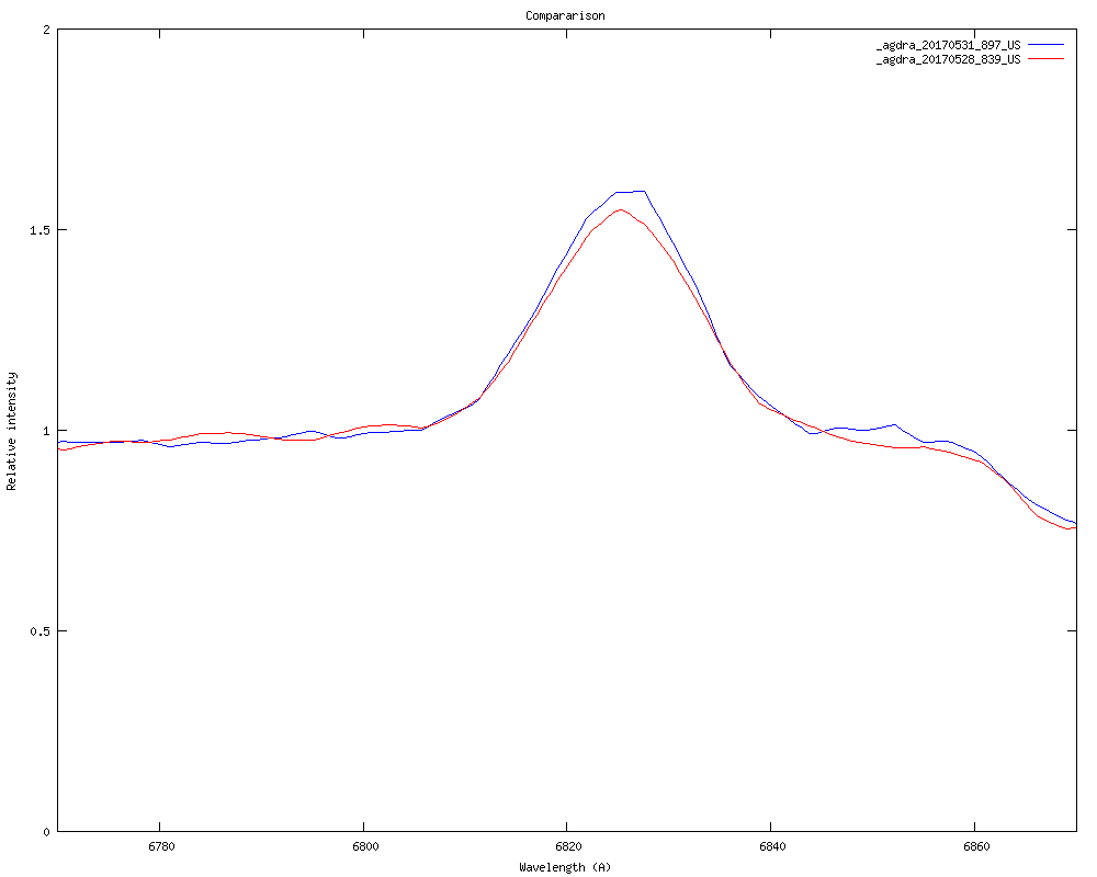

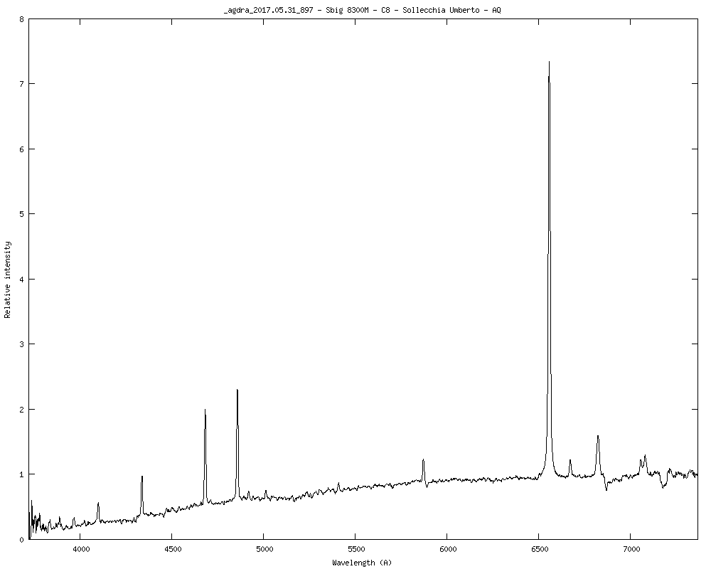

Posted: Thu Jun 01, 2017 9:54 am
Bonjour, voici le profil hier soir et une comparaison des Raman OVI avec le jour 28/05/2017
Profilo AG Dra.png (7.78 KiB) Viewed 8363 times
Comparazione crop.png (6.15 KiB) Viewed 8363 times
