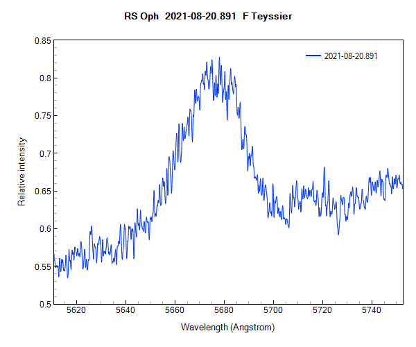

Not easy at low resolution.
From echelle spectrum (R = 9000) acquired last night.

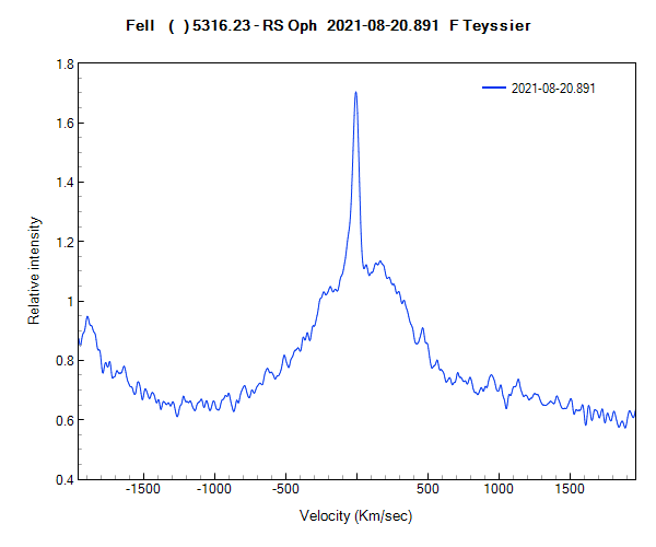

"5309"
The shape is similar to Balmer, He I, single ionized lines, notably Fe II (broad component from the ejecta and narrow line from the symbiotic nebula)
Thus it is very probably a single ionized line (Fe II, Si II)
Fe II 5316.23 is an excellent candidate.
"5677"
We observe only the broad component, thus formed in the ejecta only.
I think it is NII 5676 ("allowed")

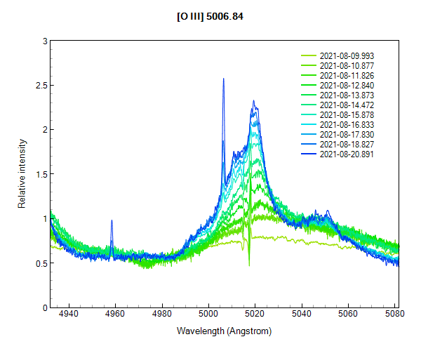

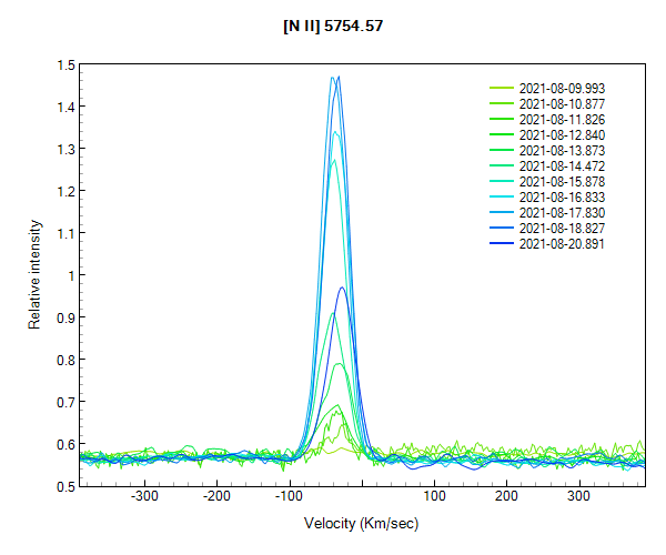

BTW, [NII] has increased (*according to the continuum*)
and [OIII] 5007, 4959 are growing
In eshel spectra, we note the first traces of [Fe VII] and [Ar III] - only narrow component, formed in the symbiotic nebula.
Waiting for higher ionized species ...! in the next weeks.

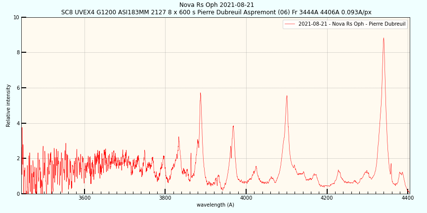

Malgré une météo brumeuse, (seuls Antares et Del Sco étaient visibles dans le secteur !) spectres Nova avec G1200 dans l'UV.
Pas mal de bruit compte tenue des conditions météo
Apparition de nouvelles raies Fer ??
Nova Rs Oph
Nova Rs Oph
Spectre3444 to 4405.png (63.91 KiB) Viewed 48010 times
résolution > 2100
A refaire dans de meilleures conditions

further growth perhaps of the OIII line at 5006 emerging?

@ Hamish: yes, Peter's spectrum show clearly the growth of [OIII] 5007 on the blue part of HeI/FeII 5016/5018 blend

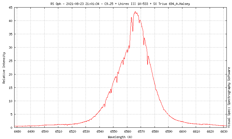

What causes the shape of the HeI 6678 line with apparently absobtion in the middle of the broad emission hump?
Wonderful echelle spectra by the way, congratulations on the technical achievement!

Last night was first decent clear sky since my last posting. Using Lhires III with 35um slit and 2400l/mm grating I captured five 300 second subs through C9.25 sct.
_rsoph_20210823_876_alun halsey.png (7.29 KiB) Viewed 47782 times
Alun
