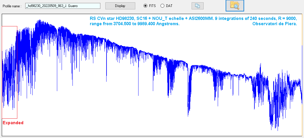

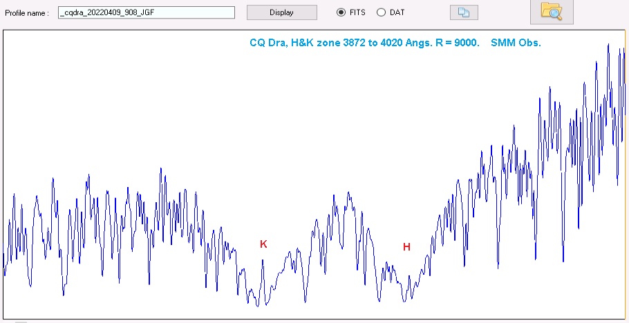

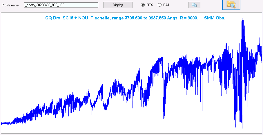

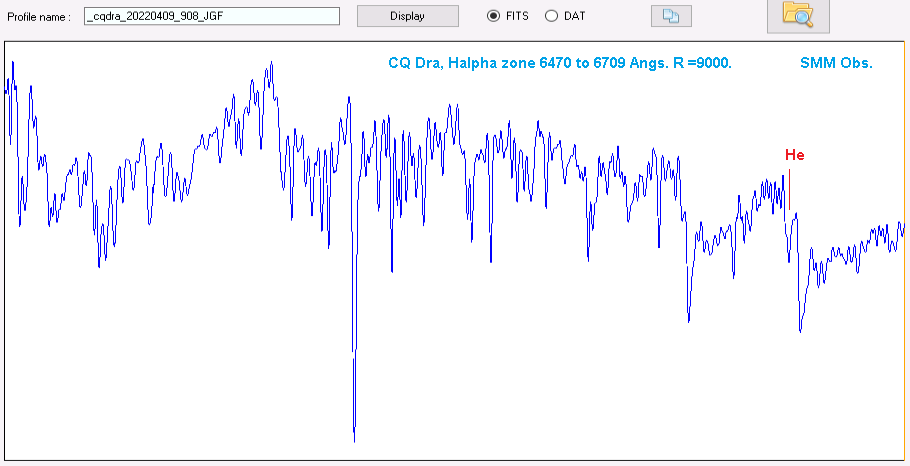

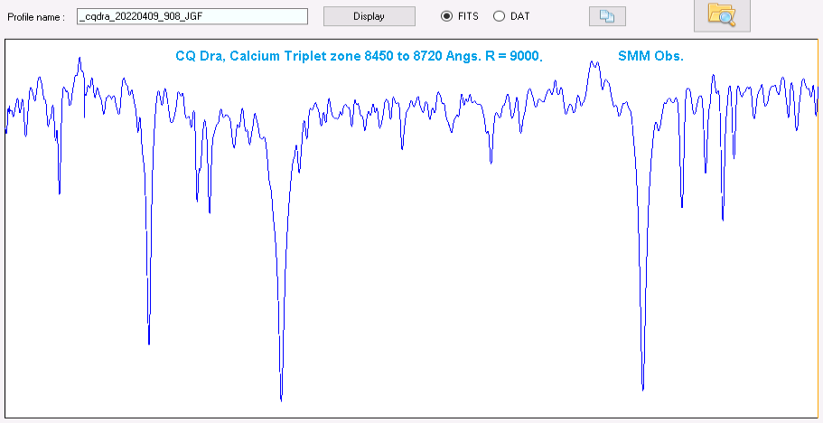

- Posts: 731
You can see here some CQ Dra graphics that I observed last night, the NOU_T echelle with a NIKON 85mm. F/1.8 objective gives more agility to the observations and its R = 9000 is very useful for analytical measurements with really any difference as the NIKON 135mm. R = 11000 and with the same precision.
I hope that it likes you, you know, you can reach to have a NOU_T too.
J. Guarro
J. Guarro

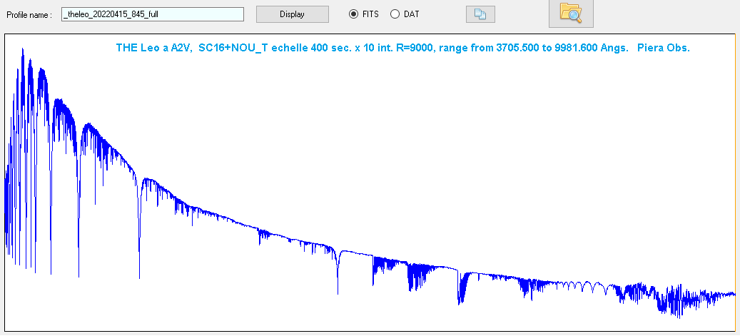

- Posts: 731
Hello at all,
It seems that after NOU_T echelle was born and passed tests, checks and improvements it has arrived to adult age, and I can say that its observational results there are contributing in three in course professional studies, - so I can mention it -, in two cases, the NOU_T echelle spectra have chose between a lot of another observations in a database and in the third case due a direct collaboration.
I've noted these professional teams, examined oscillations in the spectra NOU_T graphics from 3800 to 8900 Angstroms, so I am afraid thatother very good high resolution graphics that don't reach this range could be incomplete in some cases. Low resolution is useful for achieving a good stellar flux only. That opinion is applicable on these three studies that I know. Ernst Pollmann answered my question very quickly by asking about specific low resolution observations.
With two options, low and high resolution, if we want to, we can choose between if we want to make testimonial observations for showing, or if we want to make useful observations for analysis studies. That is the personal feel of everyone.
On the other hand, I've come back at R = 9000, with the Nikon 85mm. F/1.8 objective, first because two different analytes told me that they haven't seen any remarkable difference between R=11000 and R=9000, because in both cases the error measurements were the same, so 1%.
In my equipement there are significant advantages with R=9000, time exposure is half reduced, more weak magnitude detected, files more lighter, etc., you know, one equipement works as well as the worst of their elements.
I want to remain you, for last time, that went you want to I could help you achieve a NOU_T echelle. I hope that you could see my future observation graphics and my offer will continue to exist,
Cheers, J.Guarro.

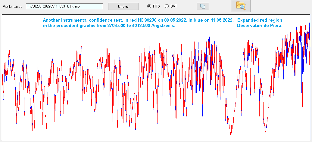

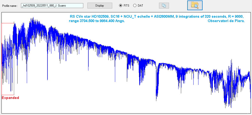

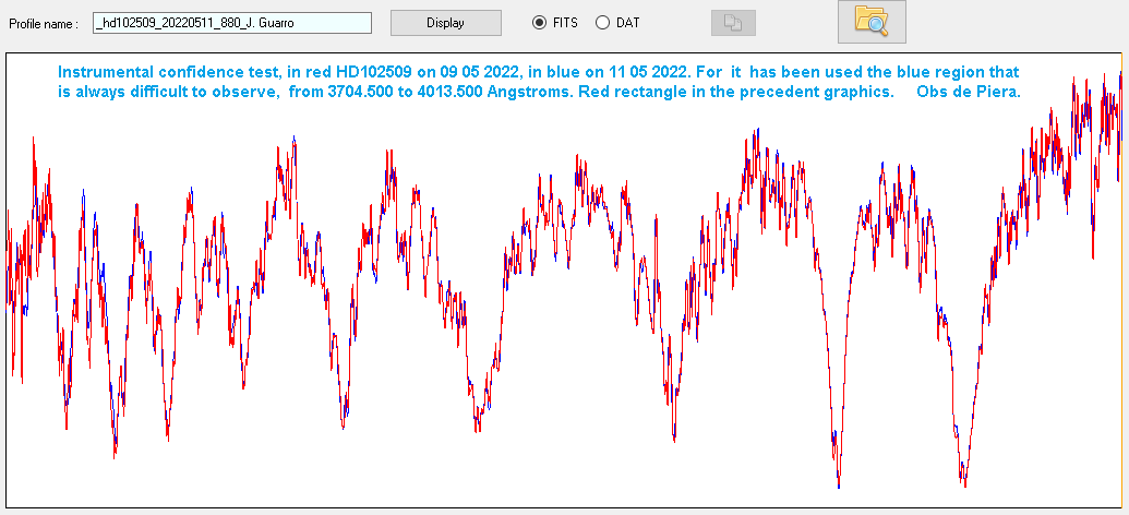

- Posts: 731
You can see here a sample of the reliability levels of the NOU_T echelle observations.
You can extract your own opinion about that, which is signal and which is aleatory noise.
Cheer, J.Guarro.
Cheer, J.Guarro.

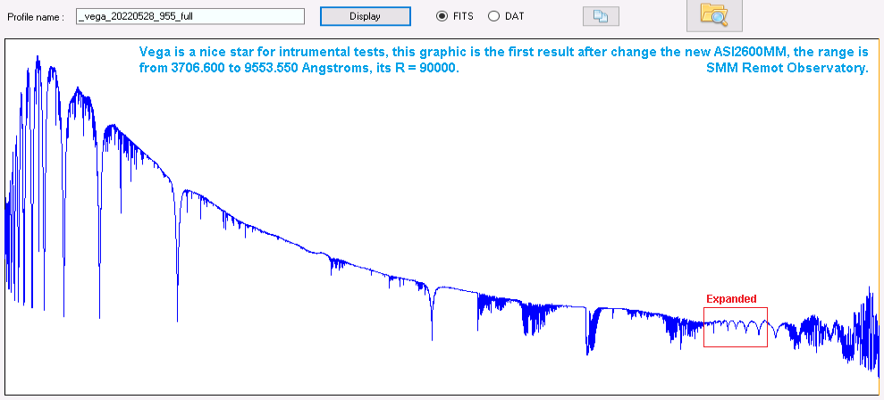

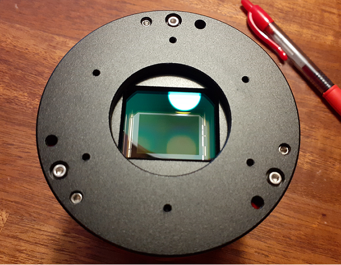

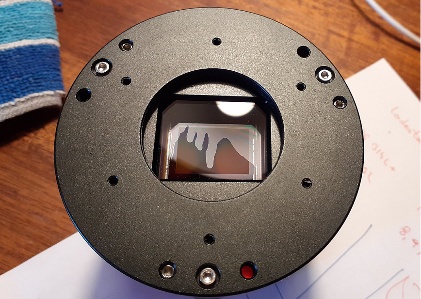

- Posts: 731
You know the camera is an essential part of your spectrograph.
Three weeks ago I noticed that stated to appear weird and incomprehensible lines in the stellar graphics that I observed from the remote SMM observatory, I found that their origin was a rare liquid leak over the chip of the ASI2600MM camera, - you can see the picture -, last week I sent the camera to my seller, and he sent it to European ZWO, in Germany.
Quickly the European ZWO has sent to me a new ASI2600MM, that I hope recibe next few days.
From this I have deduced that I not only have a good camera but that there is also a really reliable and professional company behind it.
To ASI camera owners, for our peace of mind, I leave this ZWO website link,
https://astronomy-imaging-camera.com/ne ... meras.html
Cheers, J.Guarro.

At any cost, the new ASI2600MM was from ZWO Europe, and after its setup, now I demostrate here the first test through Vega star, it seems that all works well again in the Remot SMM Observatory.
Regards, J.Guarro.
Regards, J.Guarro.
- ASI NOVA.png (854.54 KiB) Viewed 15802 times
- VEGA1.png (24.13 KiB) Viewed 15802 times
- VEGA2.png (23 KiB) Viewed 15802 times

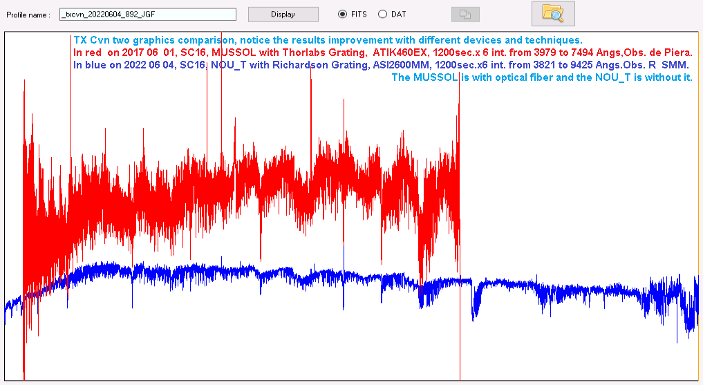

You can notice in this picture the evolution and improvement of Piera and SMM observatories from the year 2017 to now. They have passed from taking very noisy and short graphics in the past, to notable, finest and more extended ones nowadays.
Cheers, Joan Guarro.
- _TX CVN comparison.png (48.68 KiB) Viewed 15584 times
