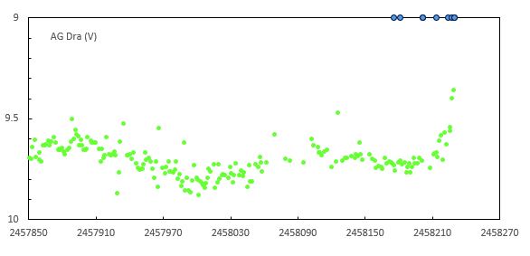

Balmer's lines velocity
AAVSO lightcurve and ARAS spectra (2018)
A daily spectroscopic monitoring is expected
