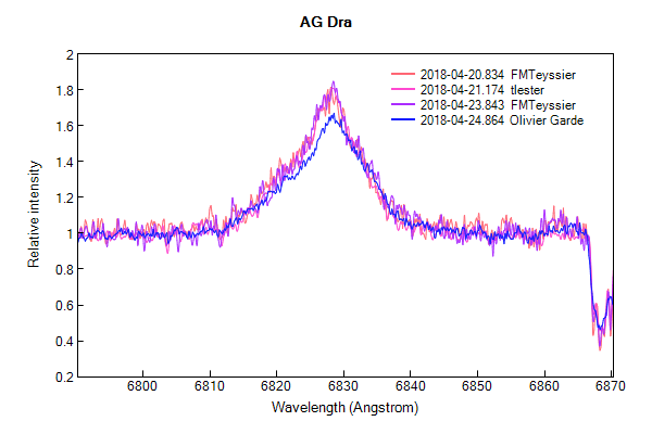

My last observation of AG Dra taken last night and comparison on several wavelenght with another spectrum taken 4 days ago.
Very interesting, Olivier
From spectra of the database, one can determine that Raman OVI declined between 04-23 and 04-24
Daily coverage is strongly expected
