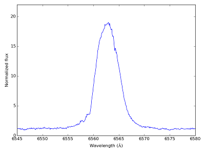

To give you an idea how wide H alpha is I attach a spectrum that we took a while ago (2014 Nov 10) with a 1.2m mirror and 180 seconds of exposure time.

It is a very interesting activity! I do not own a big telescope and I would like to ask if a spectrum like the one attached may be useful for the purpose.
Resolving power is about 6000. It was obtained with a Lhires III spectrograph equipped with a 1200 l/mm grating, 31 microns slit and a 9.25 inch telescope aperture. Total exposure 80 minutes.
I can also use a 2400 l/mm (R~15000) with which, using similar exposure time, I clearly would get a lower SNR. I wonder which is better (when possible I could take a spectrum with this configuration).
Profile in standard FITS is enclosed to allow a better evaluation.
Thank you very much!
