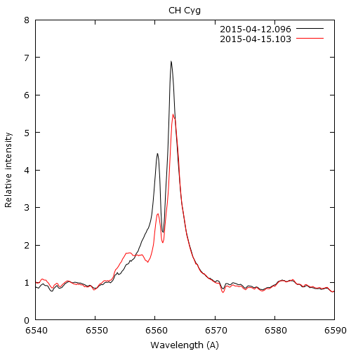

Low spectra of CH Cyg and BF Cyg required
- Posts: 1562

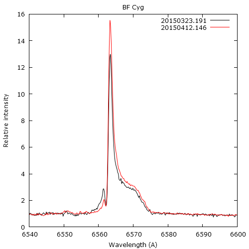

In these two stars appears fast and dramatic evolutions of line profiles
See for example
Comment from Augustin Skopal :
I have looked the new spectra of CH Cyg and BF Cyg. Really dramatic
changes in the profiles of Balmer lines on the time-scale of a few days!
Also on BF Cyg
As concerns to BF Cyg, I was also surprised with changes in the hydrogen
line profiles. At first look the shift to the red seems as a result
of a wrong calibration of the last spectrum from 12/04/2015, but
comparing the 01/04/2015 spectrum to that from 23/03/2015 suggests
that calibration and/or heliocentric correction is O.K. Just significantly
more absorption on the blue side, and more emission on the red side of
the line appeared.

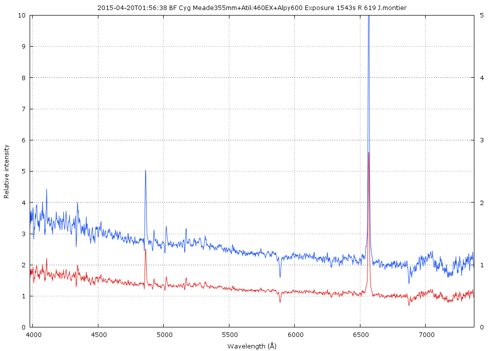

A. Skopal's request :
However, to interpret such variations will not an easy task. Above all,
we need the continuum profile, which is possible to obtain by modelling
the low-resolution spectra. So, I hope that somebody will obtain also
a low-res spectrum (CH Cyg and BF Cyg).

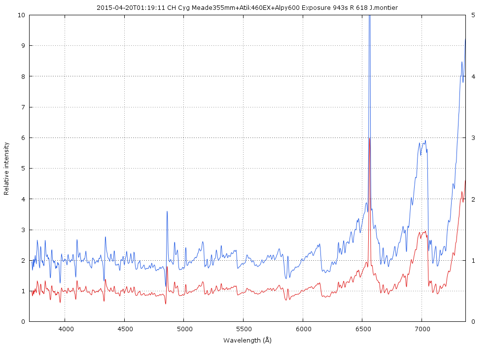

- Posts: 242
Re: Low spectra of CH Cyg and BF Cyg required
Two low resolution (R 600) spectra of CH Cyg and BF Cyg on 20150420
CH Cyg
BF Cyg
CH Cyg
BF Cyg
Jacques Montier
IAU code J23
Jacques Montier
IAU code J23
Jacques Montier

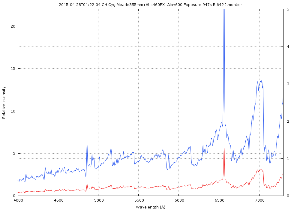

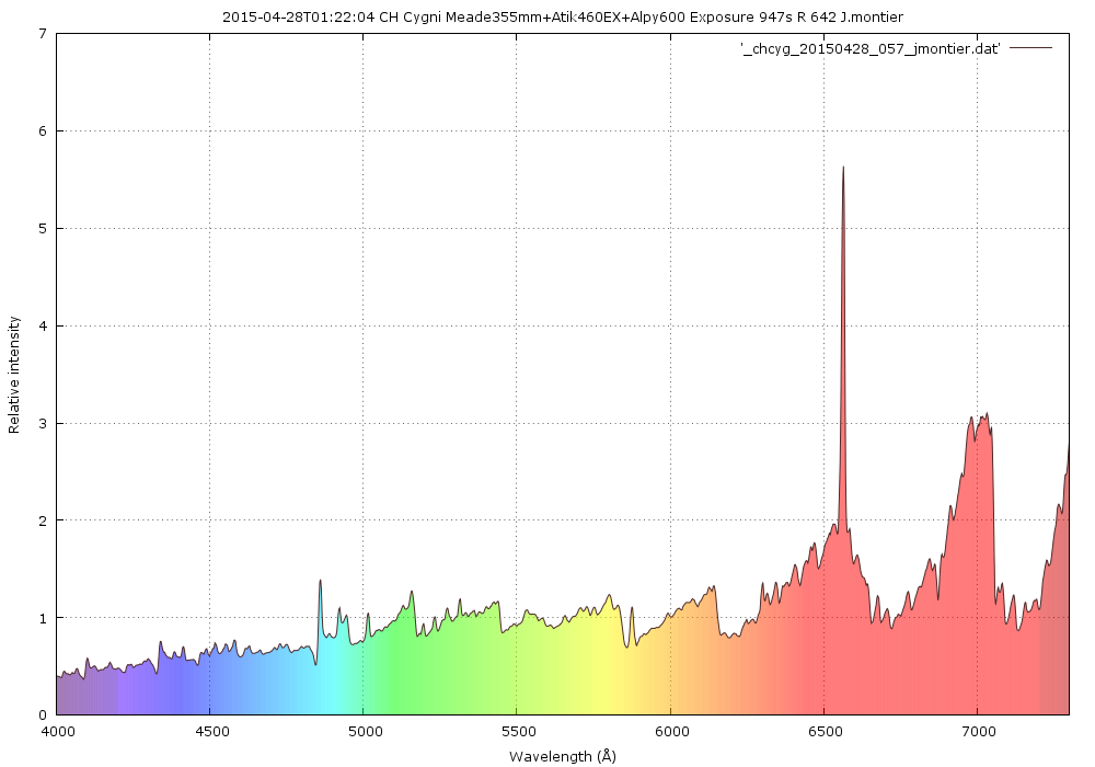

- Posts: 242
CH Cyg on 2015/04/28
Regards,
Regards,
Jacques Montier
IAU code J23

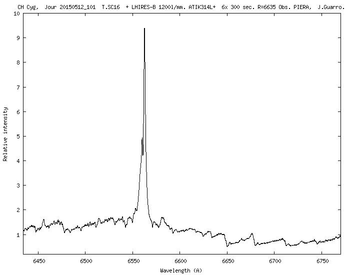

- Posts: 731
Hi to all:
Two news spectra of the CH Cyg.
Regards, J.G.
Regards, J.G.
- _chcyg_20150512_101_J. Guarro.png (5.83 KiB) Viewed 40629 times

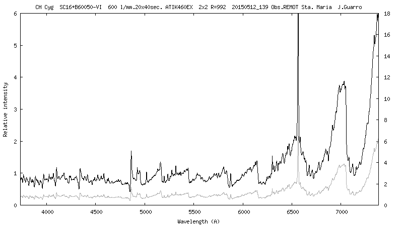

- Posts: 731
This is the second.
J.G.
J.G.
- _chcyg_20150512_139_J. Guarro.png (7.69 KiB) Viewed 40628 times

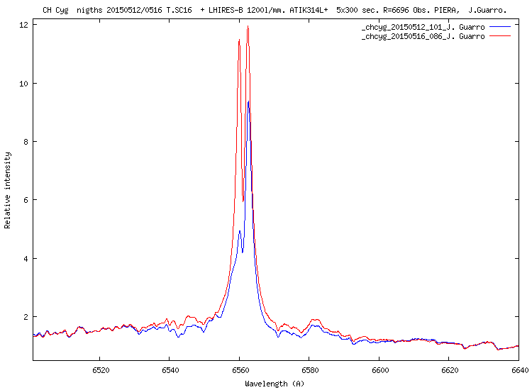

- Posts: 731
Hi:
CH Cyg, comparison nights 20150512/0516.
Regards, J.Guarro.
Regards, J.Guarro.
- CH Cyg 20150512-0516.png (6.63 KiB) Viewed 40578 times

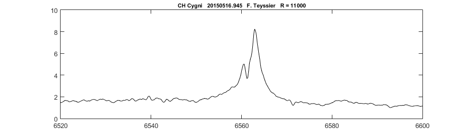

- Posts: 1562
Impressive evolution
Spectrum obtained last night :
Also, the full spectrum in pdf :http://www.astronomie-amateur.fr/Result ... yssier.pdf

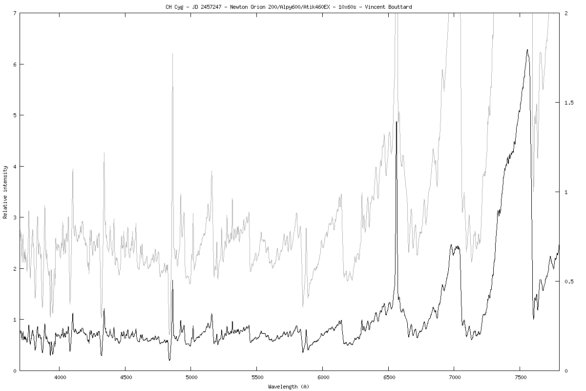

Vincent Bouttard
A low resolution spectrum of CH Cygni on 2015/08/12 (JD 2457247) at the beginning of the OHP worshop 2015.
Setup : Orion 200 F/5 Newtonian + Alpy 600 + Atik 460EX + Takahashi EM-200.
Regards
Vincent
Regards
Vincent
- Low resolution spectrum of CH Cygni on 2015/08/12 (JD 2457247) - Vincent Bouttard
- CHCyg_JD2457247_2015-08-12_bouttard.png (17.42 KiB) Viewed 40262 times

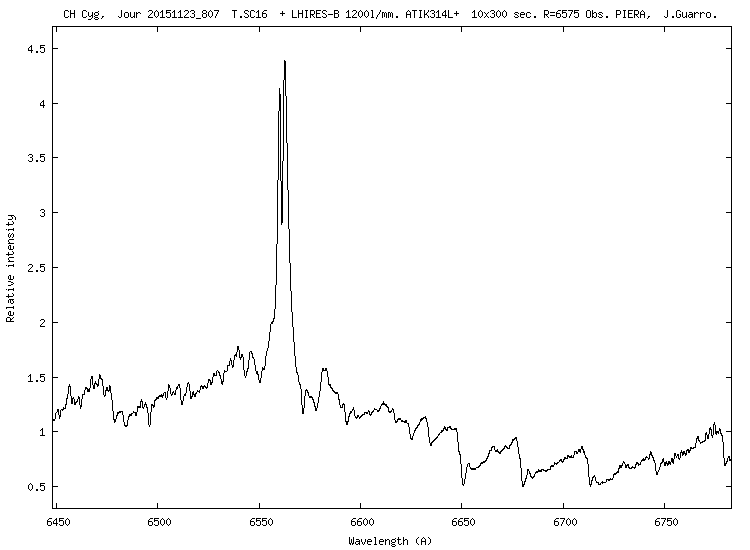

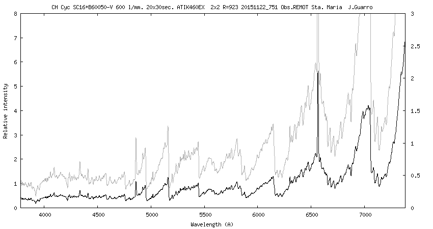

- Posts: 731
To All:
Two spectra of CH Cyg.
Regards, J. Guarro.
Regards, J. Guarro.
- _chcyg_20151122_751_J. Guarro.png (9.03 KiB) Viewed 40125 times
- _chcyg_20151123_807_J. Guarro.png (6.63 KiB) Viewed 40125 times
