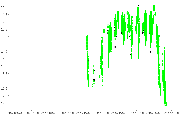

Re: V404 Cyg in outburst
Impressive variations of luminosity.
It dropped to mag 18 !

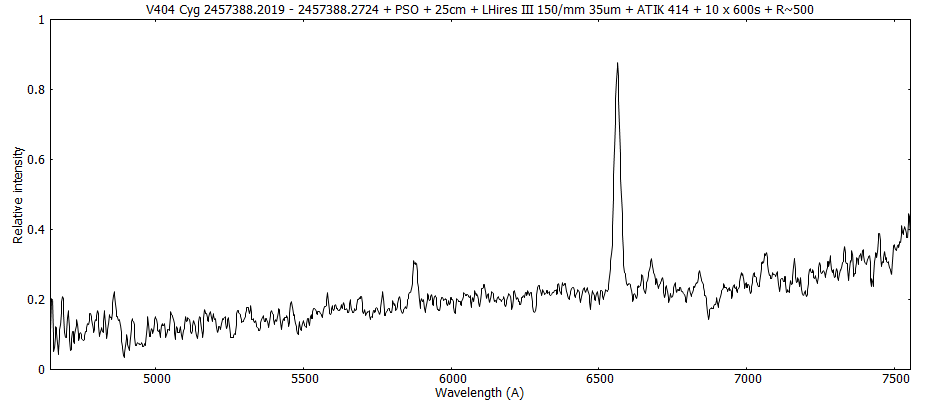

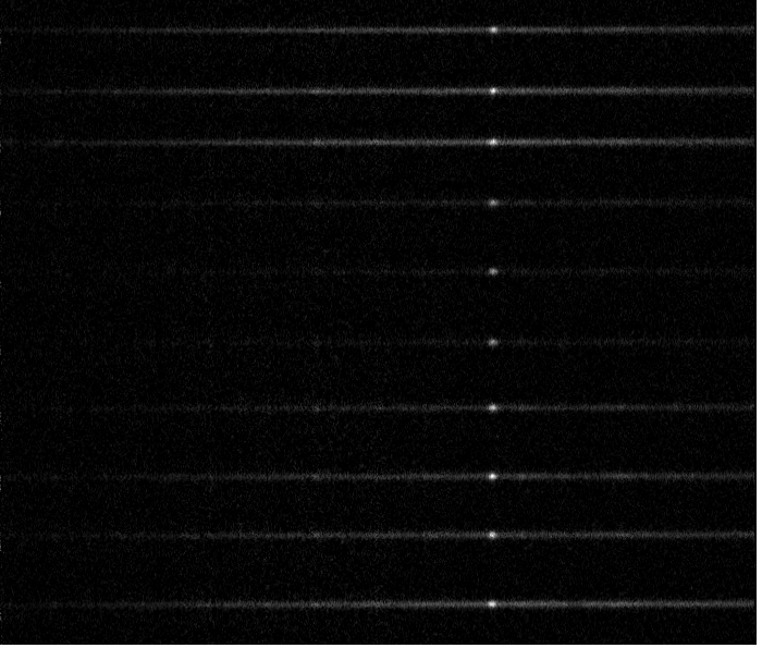

V404 has rebrightened yesterday, taken 10 x 600s till reaching the trees, it was quite variable.
2D images after procerssing, without dividing by flat:

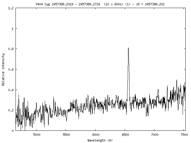

Weighted sum of spectra by Ha-peak ADU:
Animation, intensity scaled in 6555 - 6569A, then multiplied by Ha-peak ratio:
Ha-peak values I've applied, read from the ISIS processed 2D image max of H-alpha peak value:
[number] [day interval] [ADU]
1.: .2019 - .2089: 277 ADU
2.: .2096 - .2166: 365 ADU
3.: .2166 - .2236: 334 ADU
4.: .2236 - .2306: 202 ADU
5.: .2306 - .2376: 211 ADU
6.: .2375 - .2445: 218 ADU
7.: .2445 - .2515: 278 ADU
8.: .2515 - .2585: 372 ADU
9.: .2585 - .2654: 336 ADU
10: .2654 - .2724: 319 ADU
JD: 2457388.2019 + 10 x 600 sec (continuous from the 3rd frame)
