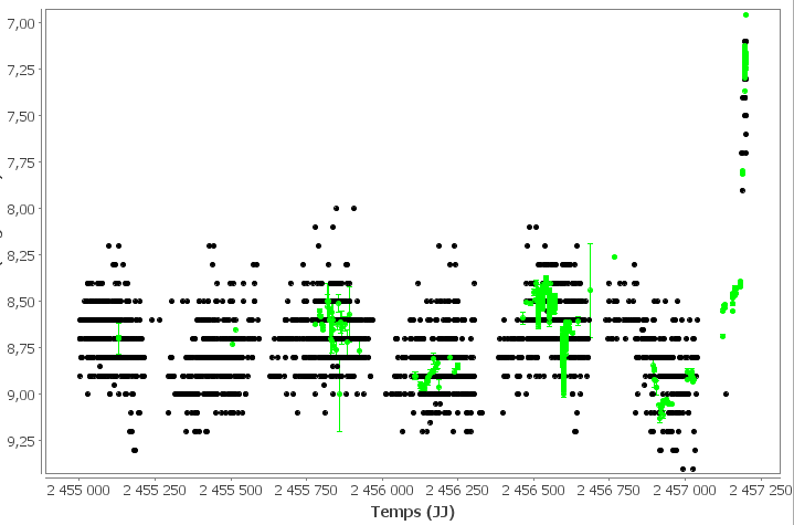

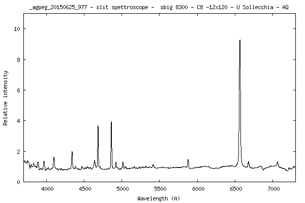

The symbiotic star AG Peg is in outburst.
A exceptionnal event.

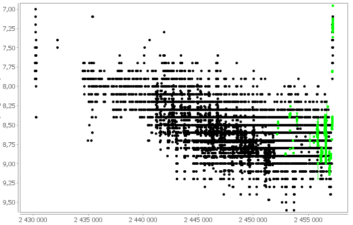

AG Peg had undergone a very slow nova event in the middle of the XIXth century, raising to its maximum luminosity from ~ 1850 to ~1870.
Then it declined ; the decline during more than a century ; it recovered its quiescent luminosity at the begening of the XXIth century.
The AAVSO curve of luminosity (since 1941) Crop : The current increase in luminosity is unique in the story of the star !
Recent soectra : http://www.spectro-aras.com/forum/viewt ... f=6&t=1161

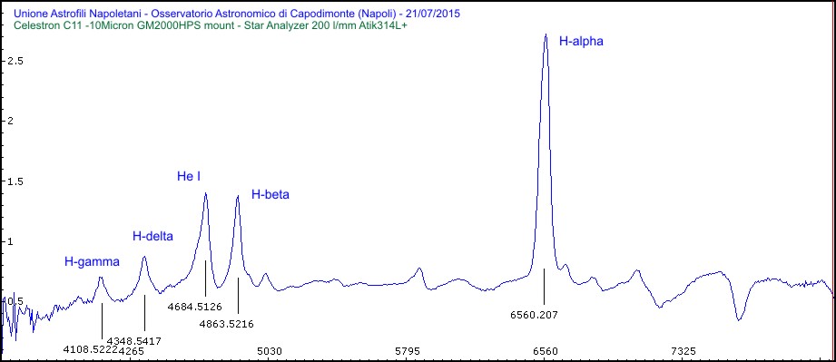

Re: AG Peg in outburst

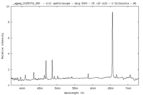

I send AG Pegasi spectrum taken by Celestron C11, mounted on 10 Micron GM2000HPS, plus CCD Atik 314L+. The spectrograph is SA 200 with a dispersion of 7.49 A/pixel.
Elio Ricciardiello
+Dario Castellano, Antonio Marino, Antonio Porcelli, Salvatore D'Alterio, Dario Saracino
UAN-Unione Astrofili Napoletanic/o Osservatorio Astronomico di Capodimonte via Moiariello, 1680131 Napoli
Italy
Elio Ricciardiello
Italy
- ag peg_60s_norm_correct.jpg (51.43 KiB) Viewed 11840 times
- Posts: 1565
Nice result with a SA !
Note that 4686 is He II (ionised helium)
You have also He I lines (5876 ...)
Elio Ricciardiello
- Posts: 12
- Joined: Tue Dec 06, 2011 9:19 pm
- Location: Napoli
You are right. Mine was a misprint.
Thanks for hint. I refer to atomic He.
Elio Ricciardiello
Elio Ricciardiello

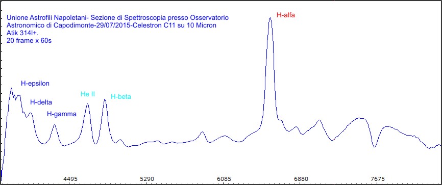

I send a new AG Pegasi spectrum taken on the 29/07/2015 by Celestron C11, mounted on 10 Micron GM2000HPS, plus CCD Atik 314L+. The spectrograph is SA 200 with a dispersion of 7.46 A/pixel.
Elio Ricciardiello+Dario Castellano, Antonio Marino, Antonio Porcelli, Salvatore D'Alterio, Dario Saracino
(Sezione Spettroscopia- Unione Astrofili Napoletani c/ Osservatorio Astronomico di Capodimonte di Napoli)
- agpeg.jpg (47.03 KiB) Viewed 11739 times

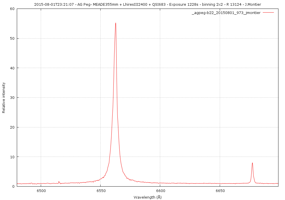

Jacques Montier
- Posts: 242

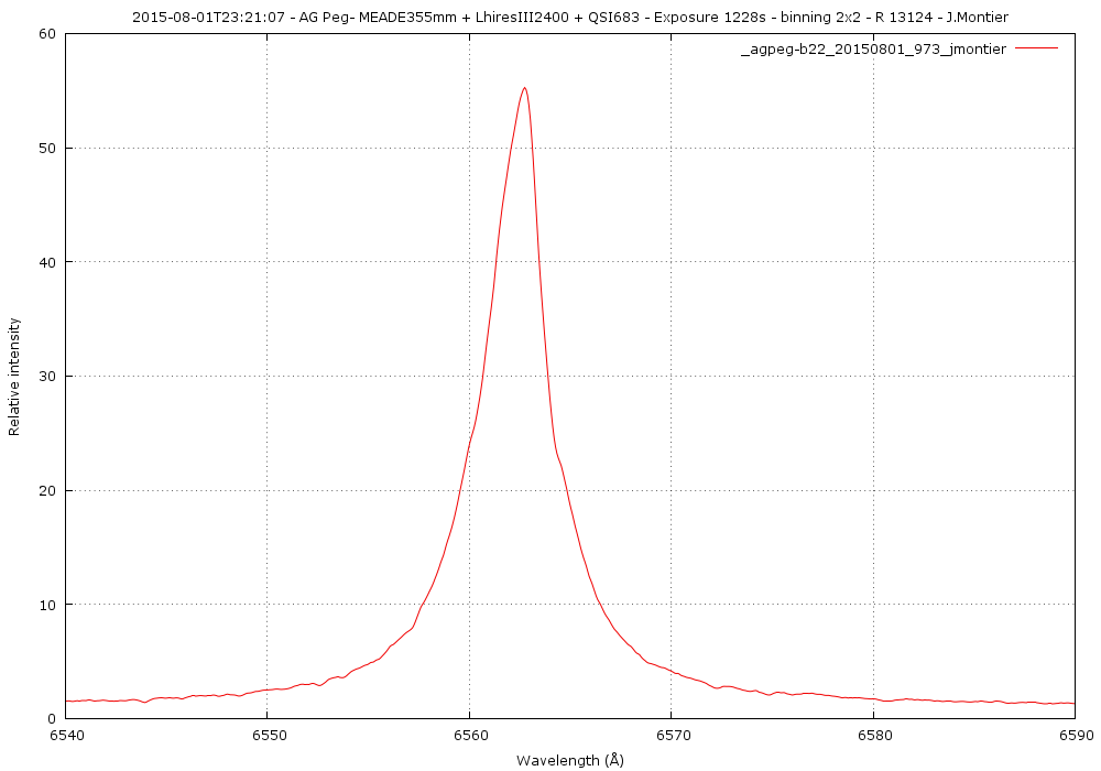

AG Peg spectrum on 2015/08/01 with Lhires III 2400 t/mm
Regards
Regards
Jacques Montier
IAU code J23
Jacques Montier
IAU code J23

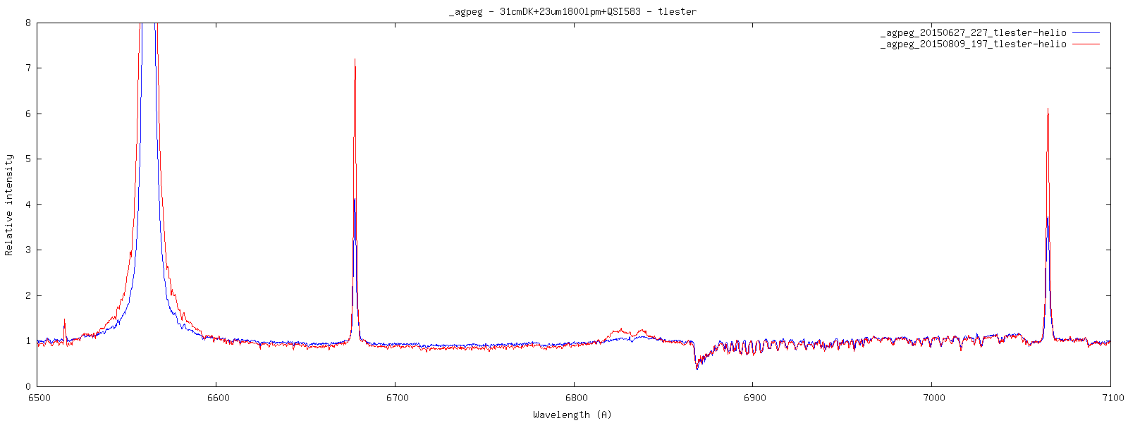

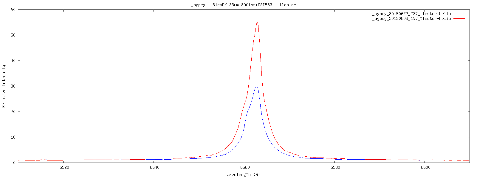

AG Peg for 2015-08-09 compared to my last result on 2015-06-27 at its peak magnitude (R=9000).

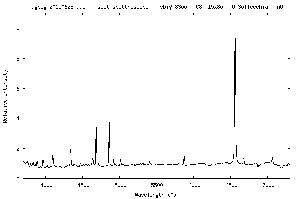

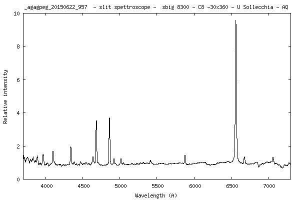

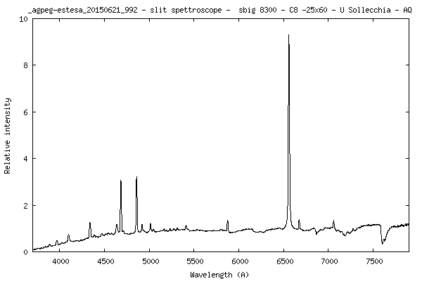

- Posts: 1273
Here's a spectrum of AG Peg taken during spectro meeting at OHP observatory with a LISA
