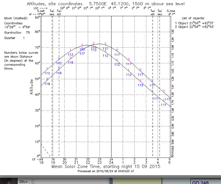

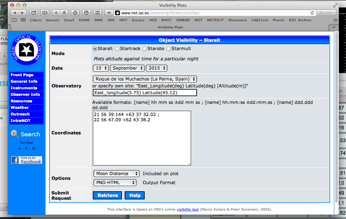

From Steve Shore:
I'd suggest using one of the KPNO spectrophotometric standards,
HD 217086 22:54:49.0 +62:27:35 O5 7.49 +0.63
http://adsabs.harvard.edu/cgi-bin/nph-b ... 58a4905502
and use the NOT visibility tool (there's also one from ESO) to check the timings of your standards:
http://www.not.iac.es/observing/forms/visibility/
you can put in a list of stars and also the location of your observatory. I've included screen shots. The star is ideally suited for comparisons (using, for instance, the date 15 Sept. and Grenoble as the site)
Steve
Screen Shot 2015-08-24 at 2.56.06 AM.png (195.26 KiB) Viewed 13873 times
Screen Shot 2015-08-24 at 2.56.40 AM.png (111.25 KiB) Viewed 13873 times
