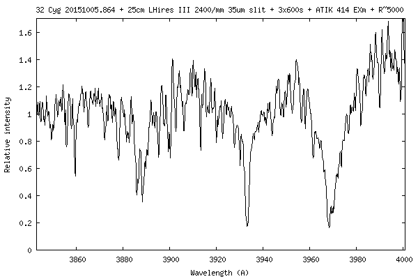

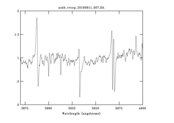

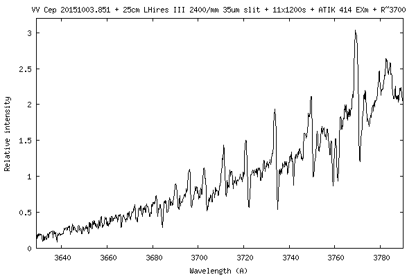

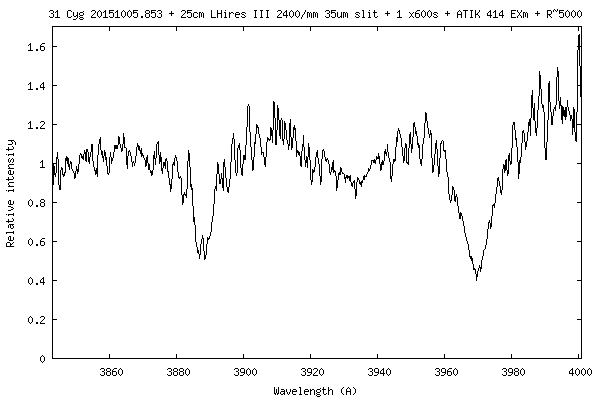

Doing some near-UV captures of 31-Cyg, 32-Cyg, VV Cep - in 3843A - 4001A, I've found the 2400/mm quite usable in this region.

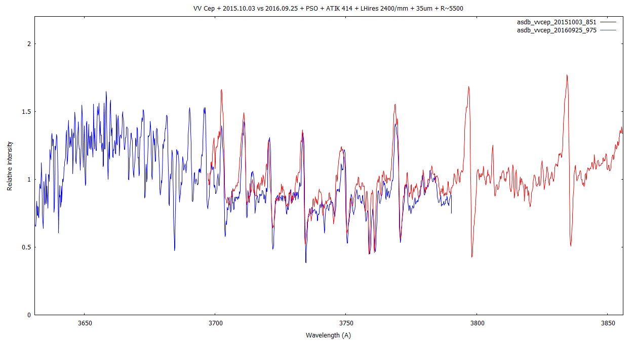

In the beginning sky was OK, one 10-minute exposure was flooded by signal: Then got some fog while 32-Cyg: Before and after 31/32 Cyg, taken VV Cep at the same wavelength (2nd is noisy) during the same night: And an earlier attempt [3629 - 3790] with 2400/mm, with some defocus at both end and signal loss at left side: But I was unable to identify these "reverse P-cygni" features above (couldn't find any line for them in VSpec - and Pickles is too low res), I'd appreciate explanation.

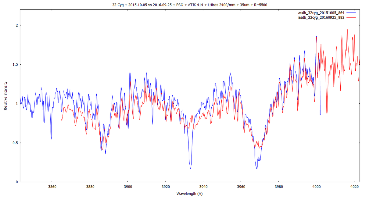

After 1 year, yesterday made a UV session (with some clouds flying by), allowing to do further 1-year compare.

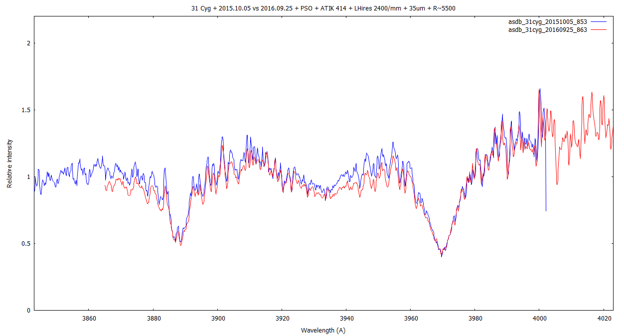

31 cyg: Basically identical, continuum differs for some reason.

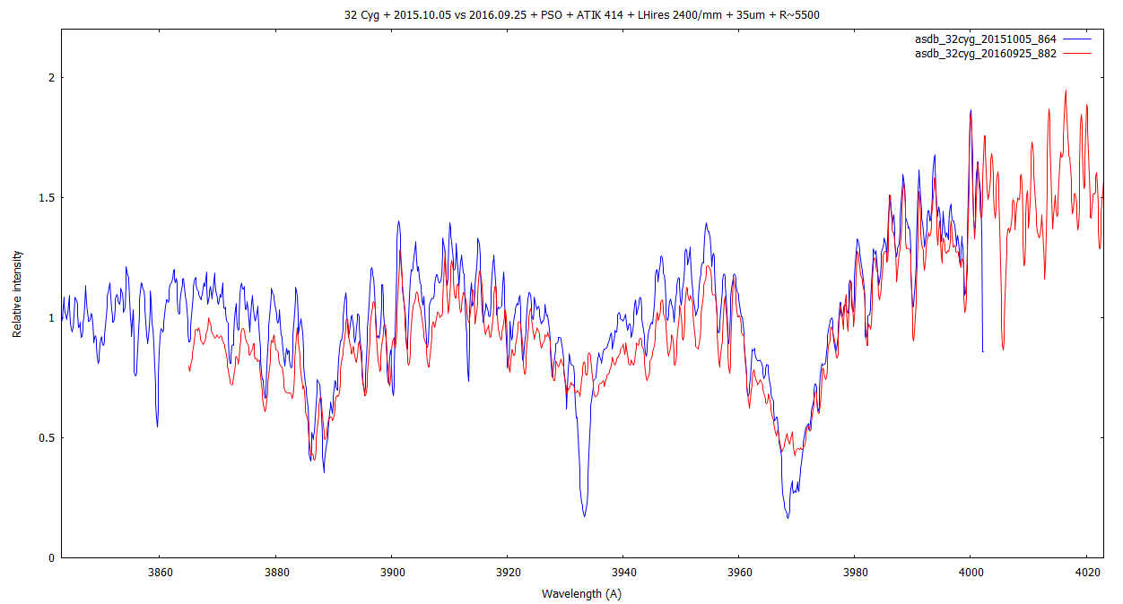

32 cyg: First I thought taken the wrong star. However, did take a Deneb and Del Cyg just for fun, and they are both different. Comparing to 31 Cyg also shows different characteristics.
Is such a big change expected?
Be aware that above spectra (each 2 x 10 exposures) are mostly noiseless.
Made a deeper experimental UV region for VV Cep, had to fix the old 2015 wavelength + simply forgot to apply instrumental response for that one.
Now here is the compare: Interesting that the reverse P-Cyg profile peaks did not increase seriously in this region.

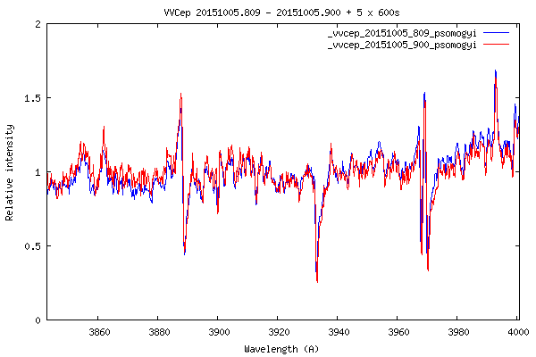

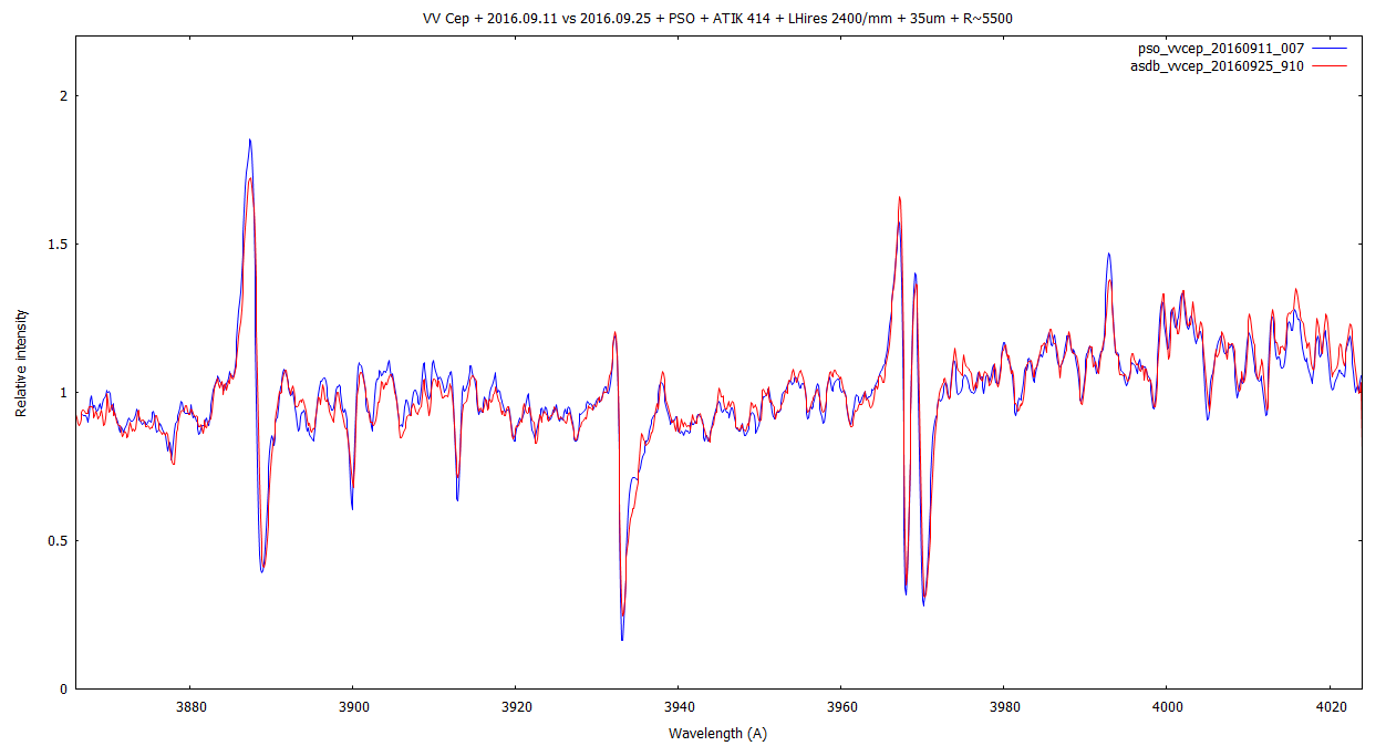

Finally, a change of VV Cep within this month: Something changed at 3934A, what can it be?

Re: Zeta Aur Stars
Peter,
The inverse P Cygni lines in your UV spectrum of VV Cep are the higher Balmer lines (the deep absorption minimum is near line centre). Your spectrum shows, in order of decreasing wavelength:
H 2-11 3770.63 A
H 2-12 3750.15 A
H 2-13 3734.37 A
H 2-14 3721.94 A
H 2-15 3711.97 A
H 2-16 3703.85 A
H 2-17 3697.15 A
H 2-18 3691.55 A
H 2-19 3686.83 *missing* -- another absorption feature appears to be coincident
H 2-20 3682.81 A
H 2-21 3679.35 A probable
+ some possible higher Balmer lines.
Phil

Re: Zeta Aur Stars
Thank you Phil for the lines identification, there seem to be no surprise then.
Let me share the CaII region serie animated gif I have since september:
Besides my flat handling changes (should cause low order humps) I can see a sudden inverse P Cyg extension appeared (radial velocities similar for both H7 and H8 here with CaII superponated), but it doesn't show any longterm trend. It's strong at +500 km/sec and weaker at +1000 km/sec.
