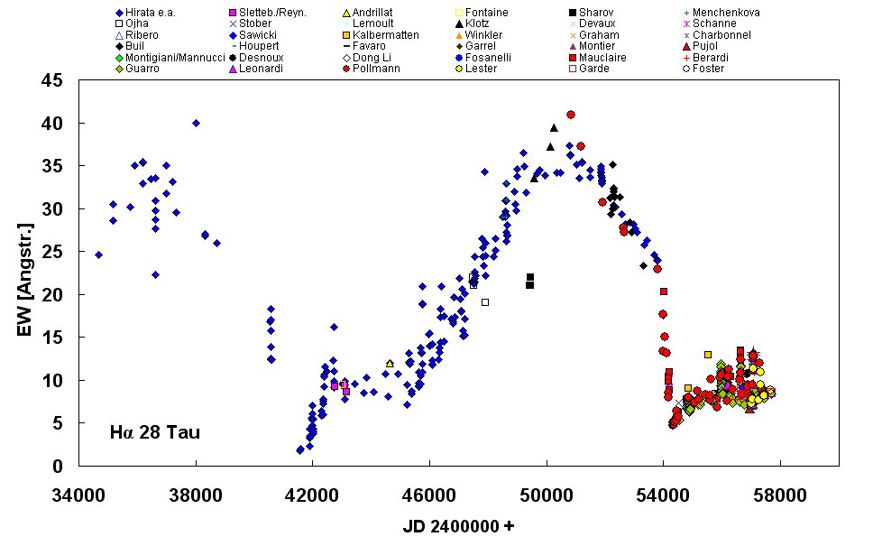

Dear colleagues,
attached you can find the ARAS monitoring of the Be star 28 Tau. As you can see, the last periastron is obviously past already. It's a pity, because the next will be in approx. 218 days.
- 28tau_monitoring.png (139.75 KiB) Viewed 218883 times

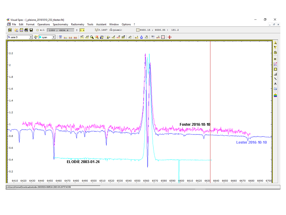

By chance I shot Pleione on 10Oct16, here is the graphic of the Ha region:
Are these to Fe2 lines real? Its curious that there so prominent in this region.

Hi James,
I didn't find any information of the FeII lines (6456.376 & 6516.53) in literature. But at least it seems to be real, by comparison with the BeSS spectrum of Tim Lester at the same date. On the other hand, these both Fe lines are absent in a ELODIE spectrum from 2003 (see the Fig. below).
So, I can't say anymore to that observation fact. Ernst

To: Ernst,
Thanks for the confirm with Tim Lester's spectra. I have additional spectra of this star in Hb and Cak regions
on the same date. Will post them Asap and continue to monitor. Glad you were able to download my spectra.

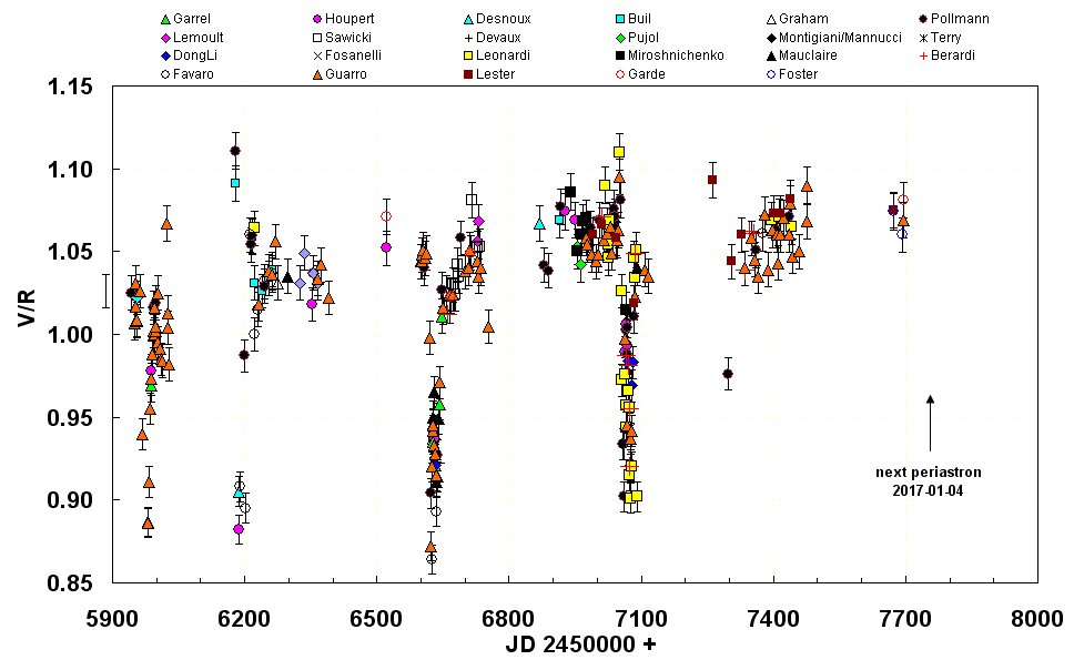

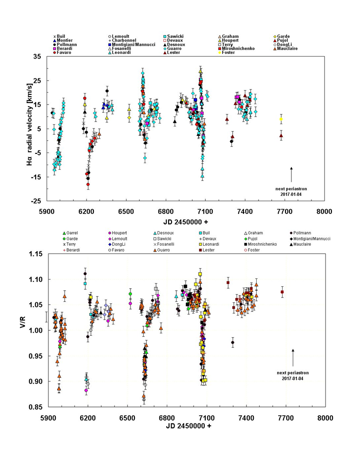

Dear colleagues,
don't forget to observe the next periastron passage of the Be binary star 28 Tauri at January 4th 2017.
Attached you can see the current RV and V/R observation of James Foster and Tim Lester. Ernst Pollmann

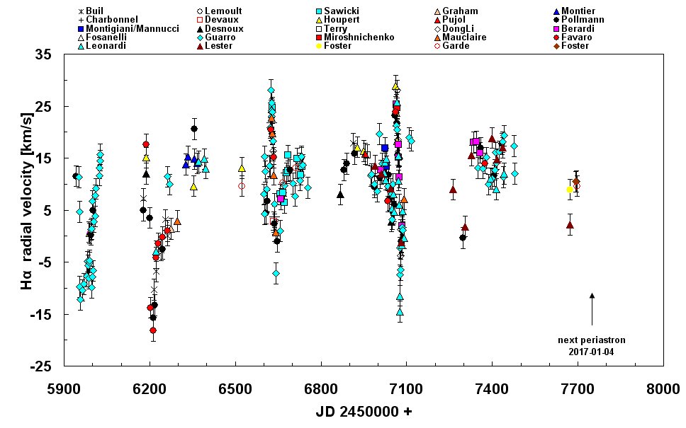

- Posts: 461
Re: 28 Tau ARAS monitoring
James,
here comes the Halpha EW, V/R and RV evaluation.
The link...
http://astrospectroscopy.de/media/files ... glisch.pdf
... offers some information about previous passages. Ernst
The link...
