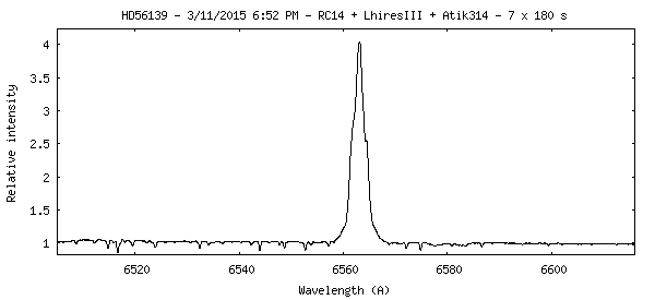

A spectrum taken early this morning local time with the object overhead but under poor seeing.
R ~ 13,000
S/N > 300
I've uploaded it to BeSS.
Paul
_hd56139_20151103_786_Paul Luckas.png (3.19 KiB) Viewed 9989 times
Benjamin Mauclaire
Posts: 258
Re: 28 CMa outburst
Post by Benjamin Mauclaire »
Hello Paul,
Nice spectrum.
Is it a normalized spectrum?
It's important to let continuum's shape natural, it could give informations.
As your wavelength bandwidth is wide enougth, I should put Ha line at a bit blue edge to get He 6678 line.
Benji
Paul Luckas
Posts: 103
Re: 28 CMa outburst
Post by Paul Luckas »
Hi Benji,
No continuum removal. Just IR correction.
Paul

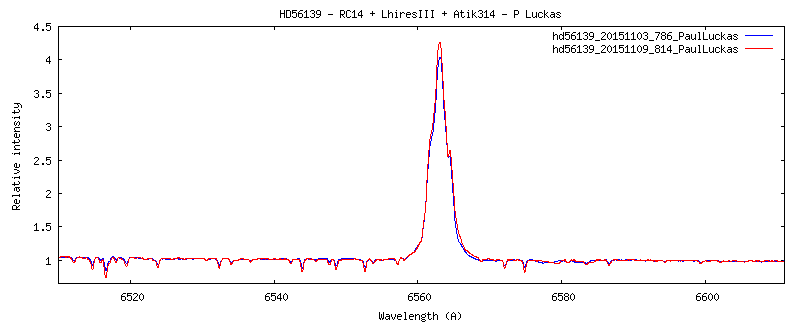

Paul Luckas
Posts: 103
Re: 28 CMa outburst
Another Lhires spectrum submitted to BeSS this morning. R ~ 14,000 @ 6532Å, S/N > 300.
The attached plot shows a comparison with last week's upload.
Paul

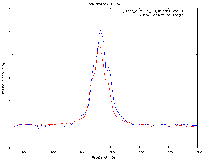

Thierry Lemoult
Posts: 136
Re: 28 CMa outburst
Post by Thierry Lemoult »
Hello
I took a new spectrum of 28 Cma last night and the night before. The Ha emission continusly increase. Relative continuous: more than 5 unit now.
LHIRES 2400T, Telescope Newton 200mm. R=17000. From Abu dhabi, lat=25°N. This star is high is the sky. Alt=35°
