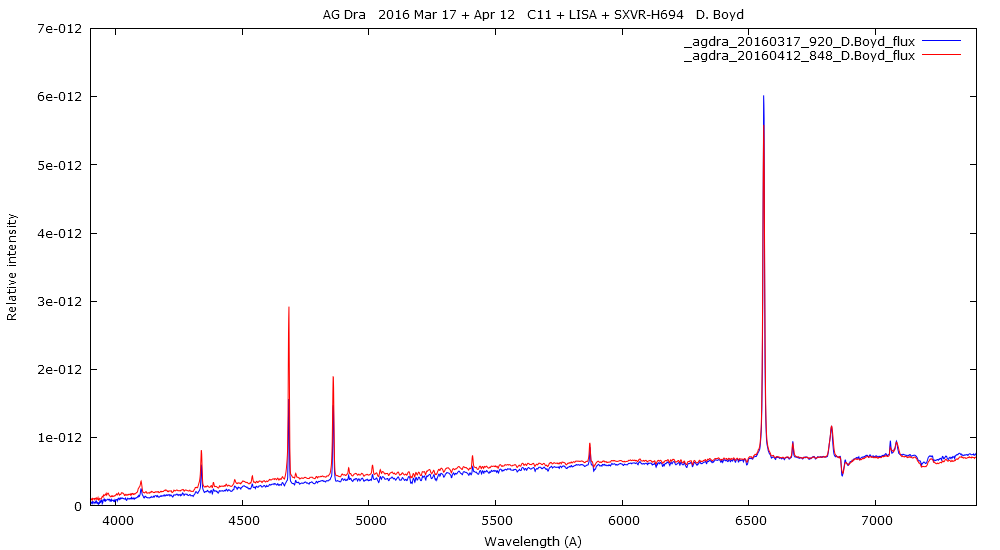

Photometric and spectroscopic observations of AG Dra in March and April 2016 show a brightening from V=9.71 on March 17 to V=9.57 on April 12. The B-V colour index changed from 1.38 to 1.20 over the same period.
Spectra taken on those dates and flux calibrated using the above V magnitudes are compared below and show a corresponding increase in flux on the blue side of H-alpha.
The emission line flux of H-alpha, H-beta and HeII (4686) are as follows (in erg/cm2/s). The flux of He I (4471) is <0.05 H-beta.

April 12
H-alpha 5.0x10-11
H-beta 1.1x10-11
He II (4686) 1.6x10-11

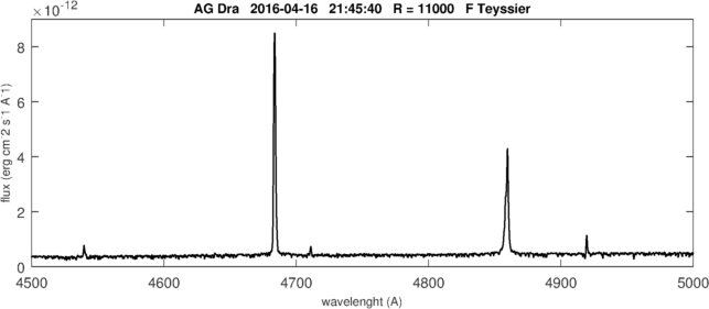

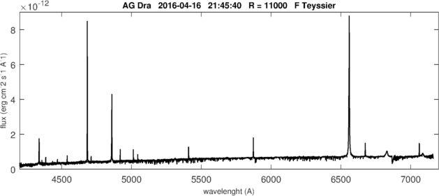

Tonight spectrum
H beta and He II region
A few lines

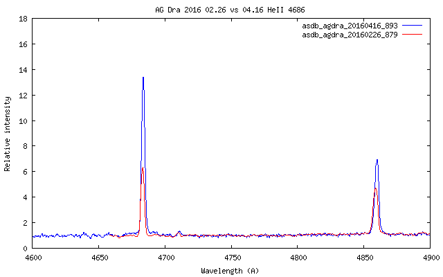

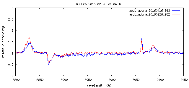

Finally I've also got - a little bit cloudy - night, here is a comparative perspective:
2016.04.16: 6 x 10 minute, unbinned, lots of cloud veils went by
2016.02.26: 3 x 900s bin 2x2, clear sky
Just to confirm the HeII 4686 increase at R~1900:
Of course, the HeII 4686 / HeI 6678 would need a local rescaling to a known continuum (I could do that when requested).
The SNR and continuum shape on 7083 both can be problemmatic, at least for now it's giving a chance to compare with the eShel result by Francois.

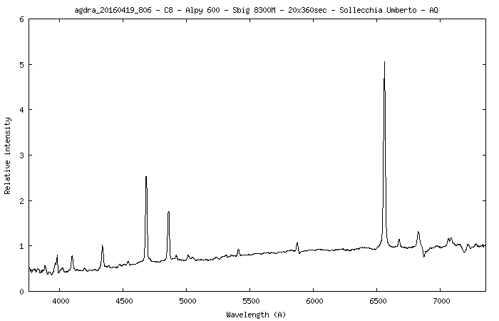

Posts: 247
Re: AG Dra brightening
Post by umberto sollecchia »
Bonjour à tous, placez le profil de l'étoile observée hier soir.
Profilo AG Dra.png (4.39 KiB) Viewed 13295 times
Salutations à tous.Umberto

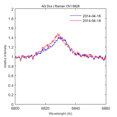

Comparison of Raman OVI 6830 (16 & 18 -04-2016)
_agdra_20160418_831_full_Raman OVI 6828.png (17.57 KiB) Viewed 13282 times
Temperatures
(Iijima, 1981), the same than David used
16-04 : 220 000 K
18-04 : 222 000 K
Formula 2 gives 233000 and 238000 K respectively
Good agreement !

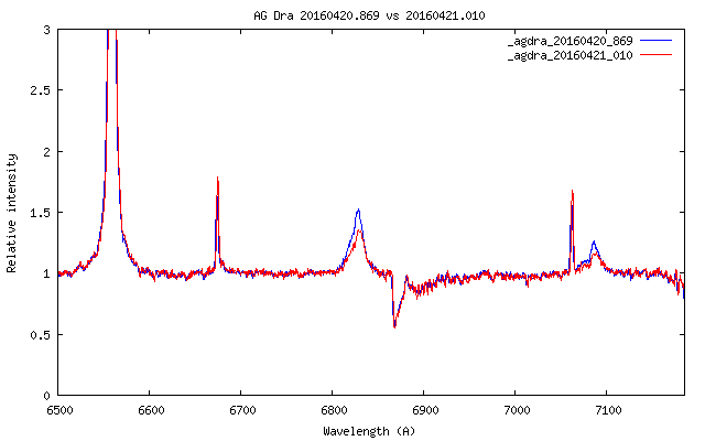

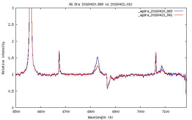

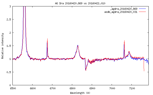

"Red alert" :) - both Raman profiles started to halve by yesterday, looks to have started suddenly!
When things was yet the same (shot over the night 04.19-20 without any change...):
I think I've caught when started to go down suddenly (shot over 1 night, this time I was a more lucky sleeper):
Next day the difference was bigger, both of them halved:
_agdra_20160420_869: 18 x 10 min (of last 1-2 exposures contain the drop, but need to look)
<took calibrations>
_agdra_20160421_010: 8 x 10 min
<daytime>
_agdra_20160421_841: 5 x 20 min
Last 3 spectra have not sent yet, need to process much better as I saw wavelength registration was not really perfect so had to switch off for the 10-minute exposures. (Fortunately I have the scripts to fix it in IRAF in a precise automated way - just need some time).
Will send the fully processed serie when I'm fixing the wavelength precision + flat movement issues soon.
Anyway, the last 3rd spectra confirming me the drop.
BTW I did check flats and with/without wavelenght registration, Raman drop is visible even on 1 exposure or the last night even by the raw image.
Hope someone can confirm the drop very soon - before coming up again, at least!
