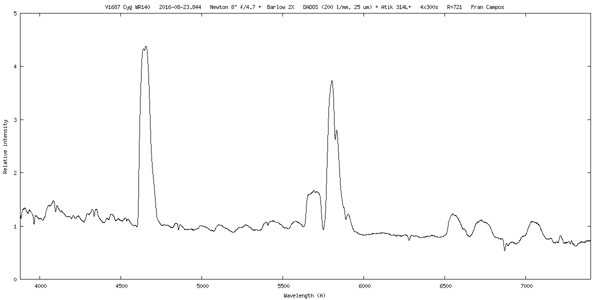

Posted: Mon Aug 29, 2016 3:04 pm
by Francisco Campos
talking about comparison stars, do you think it is a good idea to choose a unique comparison star, in order to minimize possible systematic errors? Well, because I don't have still experience in high-resolution spectroscopy, maybe it is not necessary to be so stricty on this point, But in photometry I believe that it is highly recommended.
Here is a low-resolution spectrum taken with the DADOS and HIP 100518 (B8 V) as comparison star.
Greetings
