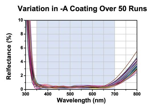

the wavelength dependence of the fringe amplitude probably comes from AR coated surfaces. A typical AR coating has a low reflectance range of 350 to 650 nm for a color camera with steeply rising reflectivity outside the nominal range, similar to the curves taken from a manufacturer (Thorlabs):
AR Coating350-700nm.jpg (29.49 KiB) Viewed 12767 times
The better the AR coating, the steeper the edges of the passband! The rapidly varying fringes point to an air spaced etalon, maybe between top surface of sensor and cover glass. It may help to replace the cover glass with one with a special AR coating for the infrared, but the problem may also be in the CCD itself, which would be much harder to correct.

I agree Martin, complex AR coating used outside its optimization domain can turn
into a mirror. But for me the biggest mystery is the origin of equal inclination
fringes in a thickness of 50 microns only. Too thin for correspond to a cover glass
or a filter, too wide for interference into layers of a dielectric AR-coating it seems.

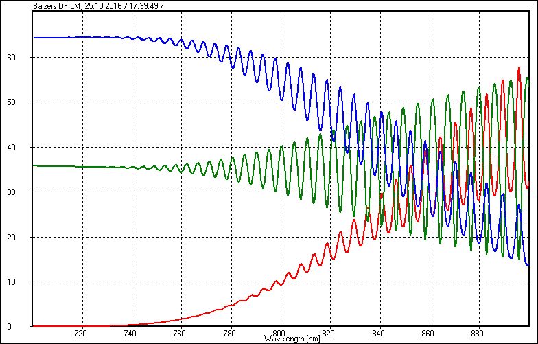

a possible explanation for the high frequency fringes may be the back illuminated sensor itself. At around 800 nm the thin Si substrate becomes rapidly transparent, leading to interference between back (illuminated) and front (electric contacts) surface. With a refractive index of about 3.6 and a 15 micron Si substrate thickness the fringes can be easily explained. As light above 700 nm is normally blocked by filters the manufacturer probably did not bother about these internal reflections. Actually the detector sensitivity in the IR is increased with a reflective front surface, by preventing photons from escaping. The following diagram shows T, R and A of a 15 micron Si substrate, uncoated both sides
15 mu Si wafer. T: red, R: green, A: blue
Si Substrat CMOS15.jpg (95.54 KiB) Viewed 12721 times
Clearly visible is the loss of absorption above 750 nm and the onset of fringes. I am afraid there is no cure against that.
Regards, Martin

Hello Martin,
Your interpretation is very attractive. It may be reinforced
by the presence of the same fringes in the image of H-alpha Sony at the band limit
(but low intensity here), so the problem could be concentrated in the detector.
I have permission to use your graph for illustration?

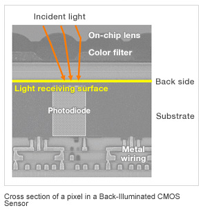

I am not sure about the Newton rings. I thought the EXMOR sensors are covered with small lenses such as shown here:
EXMOR pixel cross-section
For a thin layer the accceptance angle of the center fringe is fairly large, so this should still produce fringes of lower intensity. Just to make sure, with your camera, was the color filter and these lenses removed? I assume they were, since you say total defiltered.
Regards, Martin
Re: Test of Sony A7s for near infrared spectroscopy
Posted: Tue Oct 25, 2016 11:32 pm
Martin,
Only the native IR-cut filter is removed and replaced by a clear glass of same thickness. The microlens and Bayer filters are present (very difficult to remove).
