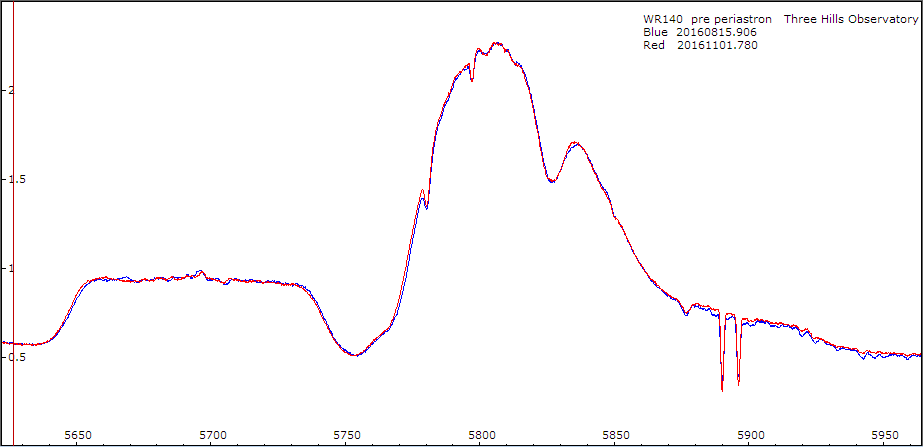

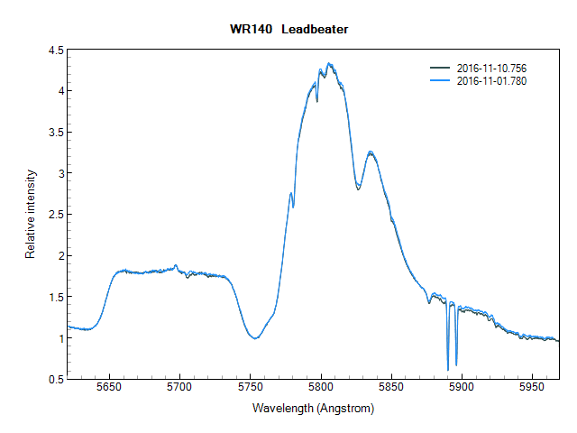

Periastron of the binary system WR140 is due on 18th December so I took a final control spectrum last night for the Pro-Am campaign. (LHIRES III 1200 l/mm grating).
Nothing much has changed since August except for a just detectable blue shift in the WR star component countered by a small red shift in the O star features as the stars move in their orbit.

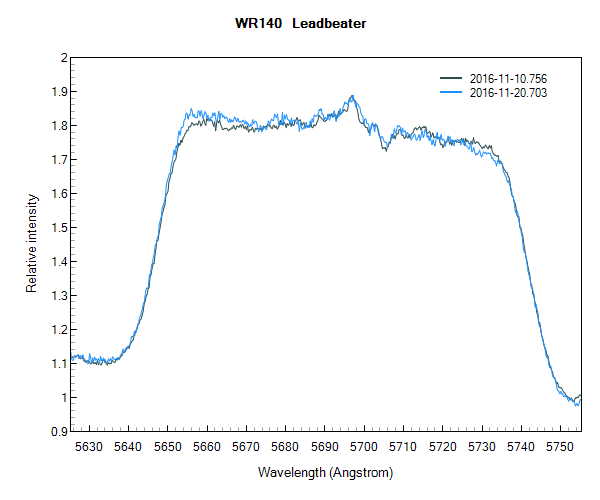

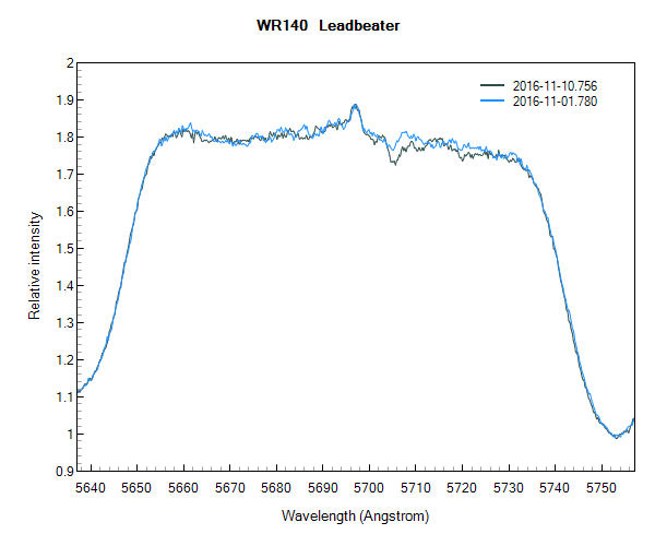

Re: WR140 aproaching periastron
Hi Paul,
The moving ripples on the top of the flat topped CIII 5696 line we are currently seeing are caused by variations in the stellar wind and occur continuously, even outside periastron. (The central blip is from the companion O star) There was a specific Pro-Am study of these wind variations recently in WR134
http://adsabs.harvard.edu/abs/2016MNRAS.460.3407A
Near periastron of WR140 + O star, the colliding winds from the two stars produce additional emission. You can see an animation of what I measured last periastron here
http://www.threehillsobservatory.co.uk/ ... tra_41.htm
Those observations were part of another Pro-Am campaign published here
http://adsabs.harvard.edu/abs/2011MNRAS.418....2F
The objective this time is to determine how repeatable the effects around periastron are.
The spectrum is very reproduceable in the continuum away from the broad emission lines and the SNR is better than 200 so we can have confidence that variations larger than say ~ 2% are real.Paul Luckas wrote:Hi Robin,

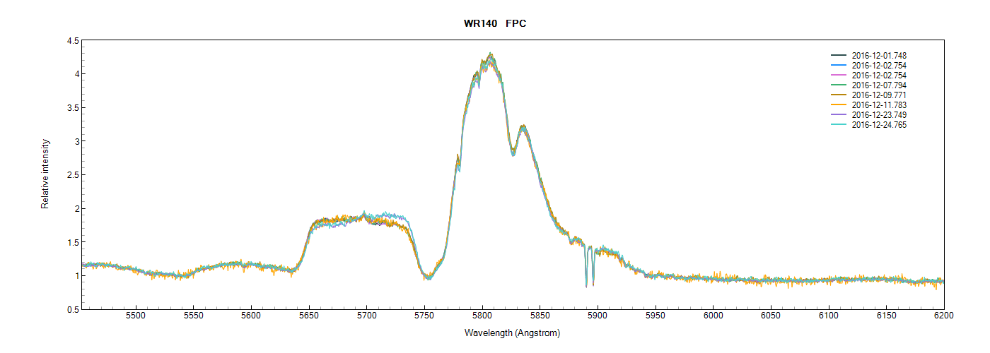

I think the first signs of excess emission can be seen on the blue edge of the CIII line tonight
