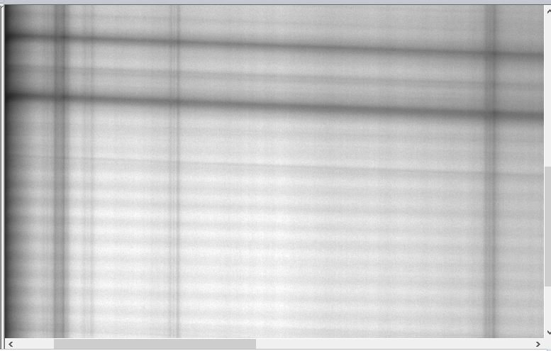

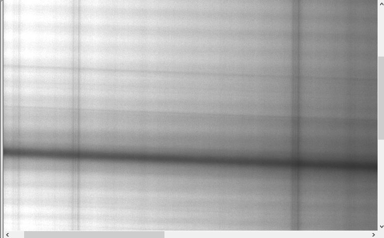

I "invested" in a fast frame ASi 174MM for the spectroheliograph and found the same interference fringes....
They extend across the visible spectrum....
ZWO had no ideas about the possible cause, but I'm pretty sure they are caused by interference between the cover plate and the chip. The spectral spacing of the bands should allow us to determine the effective etalon gap.
ASI 174 Interference banding at Ha
ASI174 Interference banding at Na
Re: CMOS vs CCD for spectroscopy applications
My bet is on the fringes being from internal reflections in the cover glass.
http://www.astrosurf.com/aras/fringing/ ... ripple.htm
The same has been seen at similar spacing in many (but not all) Sony CCD
The fringing is not a real problem for spectroheliography applications, more problematic for standard spectroscopy... The cover glass can be the primary source (in the near infrared the back-side technology adopted by Sony for its recent CMOS can be also at the the origin of fringes, TBC).
