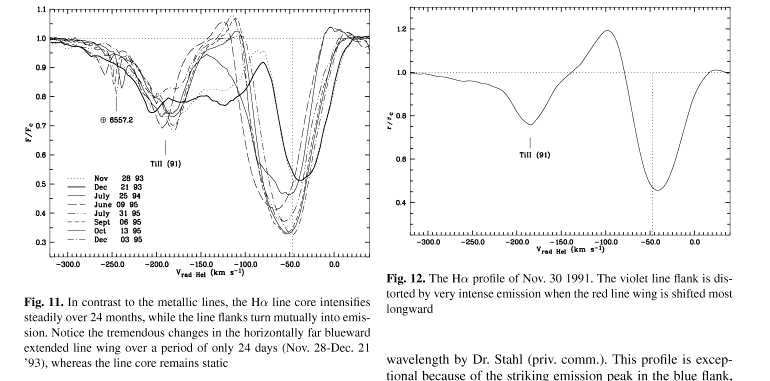

If you are still interested in Rho Cal googling " the spectrial variability of the cool hypergiant 1997" will bring up a link to adsabs.harvard.edu repositry for a paper by A. Lobel et al which covers H alpha in this fascinating star.
Regards Andrew
Rho Cas H alpha.png (43.07 KiB) Viewed 9873 times

Le spectre d'hier soir, la raie en émission est plus prononcée que sur mon spectre du 22/06/2017
La raie qui est en émission (entourée en rouge) est décalée vers le bleu, cela veut dire qu'il y a de la matière qui est éjectée vers nous ?
Que peut on savoir d'autre avec le spectre ? Peut on calculer les vitesses radiales, d'éjecta ?

Hi Etienne,
The theory proposed by Lobel et. al. is that the emission is from a shell disk of gas surrounding the star. Their theory is that this emission is practically static in wavelength (apart from the radial velocity if the star) but the absorption feature moves with the pulsation of the star as do the other absorption lines. This gives rise to the different measured shape of the line and the apparent movement of the emission peak. The peak as seen in the spectra is not the actual peak in emission as it is convoluted with the moving absorption from the star.
They give the same exploitation for the splitting of other metal lines like the Na doublet as shown in my spectra :
Regards Andrew
