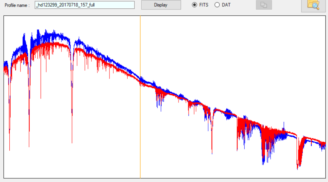

The following comparison illustrates the problem
full spectrum comparison.PNG (60.76 KiB) Viewed 4037 times
This is a comparison of the spectra for HD123299 taken several nights apart. This is the star I use for calibrating response when shooting AG Dra.

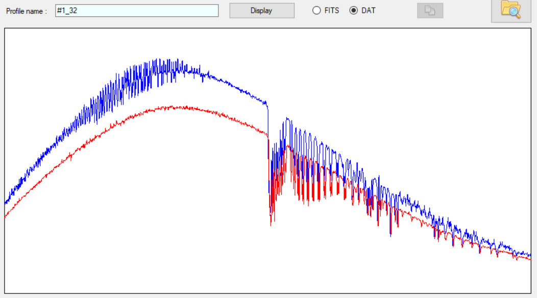

The star is bright so there is only one exposure in each case. Notice the regions of high noise on the blue spectra. Here is a comparison for order 32 to show the effect in more detail.

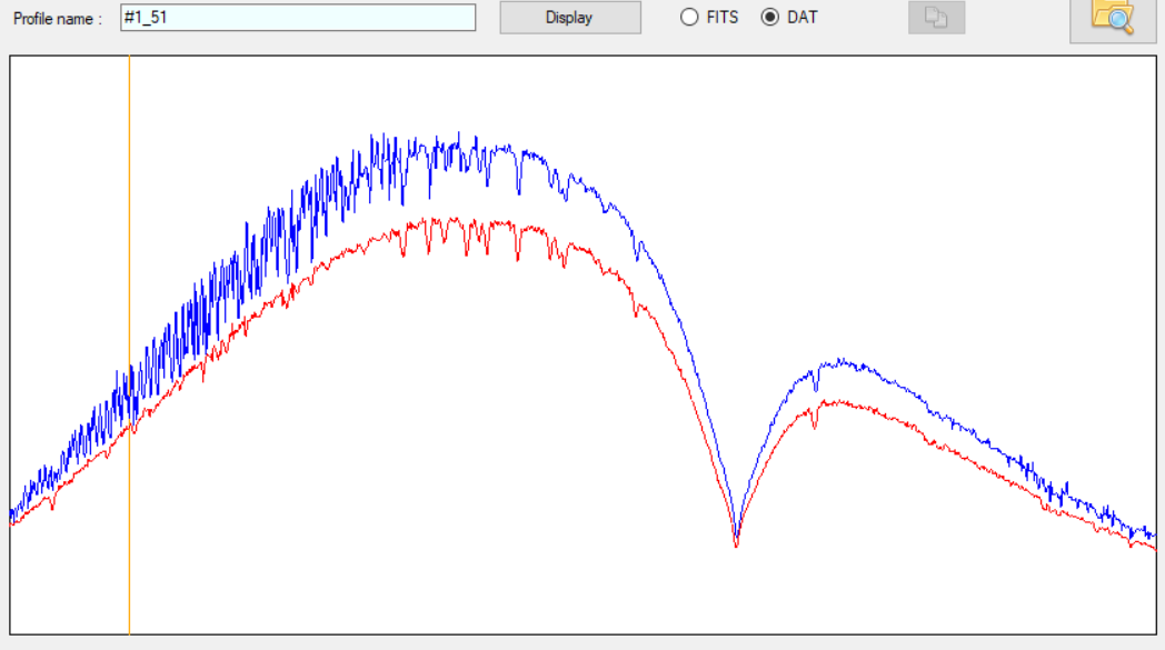

And for order 51 where the order spacing is much larger.

No reasonable adjustment of ANY of the parameters in ISIS will change the result. The new Optimized binning flag does affect the ripple on my flat traces but has no effect on the regions of very high noise.
If you look at the #1_32.fit image that ISIS produces the noise is clearly not present (this can be confirmed by generating a profile using Maxim DL)

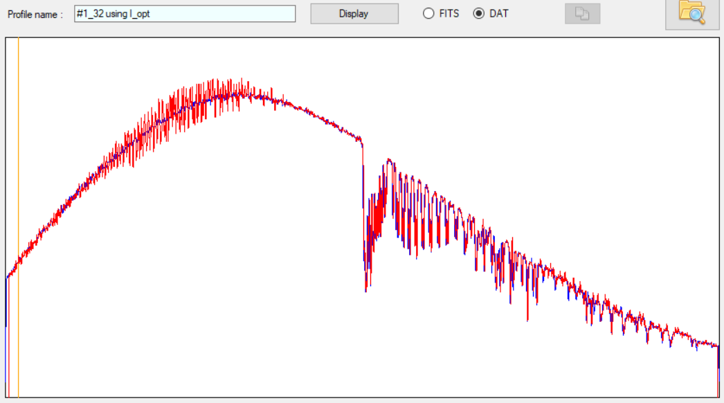

Further if you use the command L_OPT (or L_ADD) to process #1_32 you get a clean profile over a wide range of binning values (12 and 24 in this case) as shown in the next comparison.

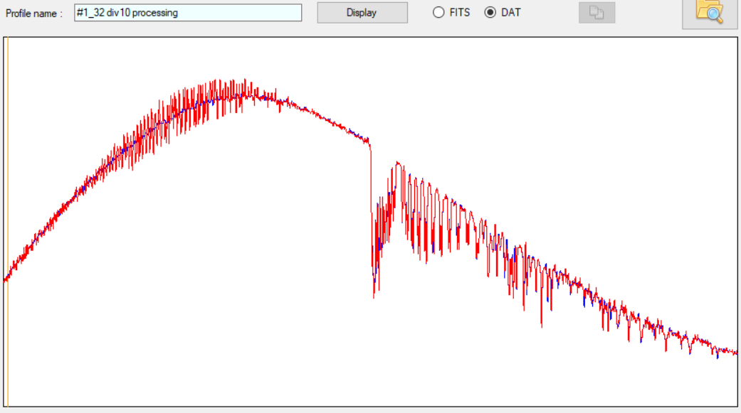

I have discovered a workaround that allows me to process spectra. What I do is divide all the images by 10 (including the dark and bias images). These are saved in floating point format so no information is lost. It is simply a scaling. When these scaled images are processed in ISIS everything seams OK. Here is the comparison for order 32 processed in this way. The div10 profile has been multiplied by 10 for this comparison.
