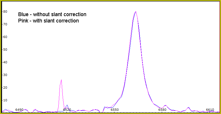

This plot shows the effect of applying the slant correction. Nothing else changed between the two runs.
V1329 Cyg hot pixel.png (12.78 KiB) Viewed 4908 times
There is a hot pixel visible on the image at that location which was in the hot pixel file. With the slant correction set to zero the hot pixel is not present in the spectrum. When I apply a slant correction of -0.87 the hot pixel appears. I was not applying the cosmic ray filter. I then did apply the cosmic ray filter and it removed the hot pixel from the spectrum.
Curious. I've now corrected the cause of the slant so the problem has gone away.
