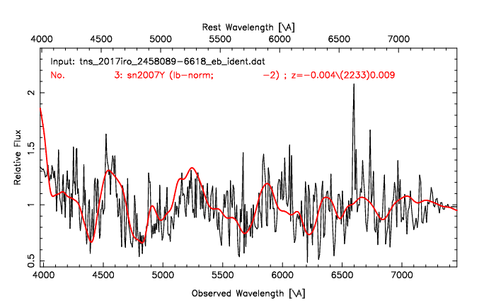

SNID also suggests type Ib based on your spectrum for example
I think TNS did not plot your spectrum because it expects the spectrum as a .dat file in the ASCII file (not the ISIS log file you uploaded)
