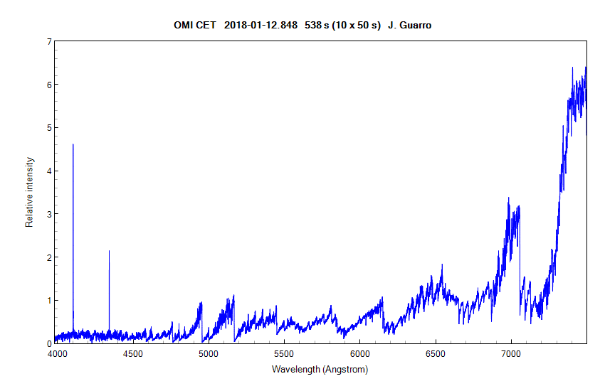

They are graphs of the observations of any 2018.
It seems that Omi Cet is at its maximum, surprises its emission in the Hgamma and Hdelta.
As for the SU Lyn, it shows its magnificent sawtooth and its unique Hapha.
Regards, Joan.

Hola Joan! Wonderful 2018 spectra...
Very interesting the Omi Cet evolution. I saw a similar state in your old spectrum taken on February 9, 2017 (from ARAS db).

Buongiorno, Paolo,
Now the Omi Cet is close to its maximum and this must be the reason why Hydrogen shows this amazing activity in the violet.
