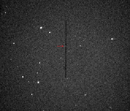

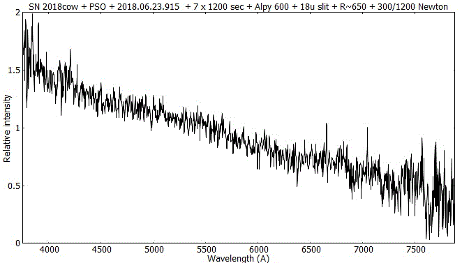

My observation from last night - bluish featureless continuum:
Guide view (off slit guiding):
The peak where H-alpha should be doesn't seem to be hotpixel: it's 100A away, and when applying the background galaxy's redshift (4241 +/- 39 km/s), I can measure 6561.2A as its barycenter. So that may be from the galaxy.
The "W" shape (absorptions barycenters: 4912A, 4967A) should be also something real (SNR good enough in the green-blue), but none matching by any atel reports.
I will be interested in comparing our results and learn more, here is mine:

Hi Peter,
Very interesting. This is certainly an odd object. (There are now 30 ATels on this !) I would have expect some clear features in the spectrum by now if it was a normal supernova. I ran it through SNID but it did not come up with any matches.

Thank you for the look, Robin!
ATEL#11776 also reports vanishing features on the next day (2018-06-24 21:22).
It would be nice to access those spectra as fits files, for a comparison.
Also curious how was the result (overlapping observation with mine) with the T60 at Club Mars.
