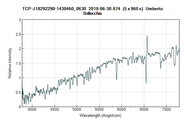

Post by umberto sollecchia »
Bonsoir à tous, placé le profil de la nova observé ce soir avec Alpy600. Umberto
tcp-j18292290-1430460_0630_20180630_874_Umberto Sollecchia.png (28.21 KiB) Viewed 32919 times
Last edited by umberto sollecchia on Sat Jun 30, 2018 11:16 pm, edited 1 time in total.
Posts: 1565
Re: TCP J18292290-1430460, mag 10 in Sct
Excellent, Umberto
Strong Na I D absorption
Waiting for the spectrum
f
Posts: 578
Congratulations Olivier, Umberto!
So we have a classical nova...
