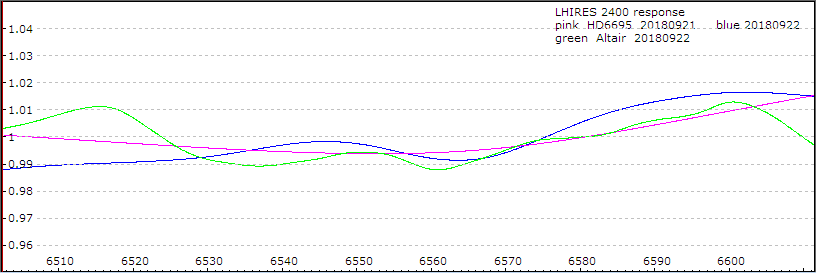

Hi James,
Interesting that you should be looking at this. I have just returned to high resolution with my LHIRES after tuning up the spectrograph on the bench over the summer. Here are some recent instrument responses at Halpha with the 2400 grating. To be honest, looking at the low levels of variability in these I am wondering if it is actually useful to use a new instrument response every time when working at H alpha over such a narrow wavelength range unless the air mass is very high. I am not convinced the differences are real at this level and I may actually be introducing variability.
I would even go further and argue that, although it is not the BeSS standard, rectified spectra would be just as useful and we could forget about instrument response and continuum shape all together ! (In any case, I suspect that the first thing professionals do when using our high resolution H alpha spectra is rectify them to get rid of continuum differences between different observers)
Re: LhiresIII Image Response Curves
Note sure if you have the same problem, but in ISIS I ofter have to correct he last few pixels in ISIS -> 5. Profile -> Edit tab (of course, just for response - for real spectra, I'm cut them).
The last 1-2 pixels always very bad, exactly causing to drive away the curvature at the right edge (very rarely seeing on the other side, too - e.g. when summing spectra with tiny shift).
But in general, seeing this also for 1 single exposure, possibly a rotation / deskew in 2D -> 1D might be introducing this artifact.
Examining the first and last pixels in ISIS -> Edit tab has became a standard procedure for me (up to ISIS - v5.7.0 - newer versions don't bring any advantage for me by release note, so not upgrading to avoid surprises).
