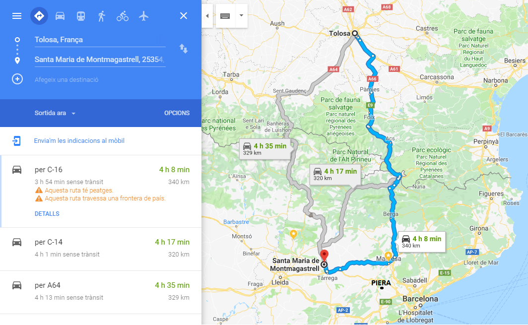

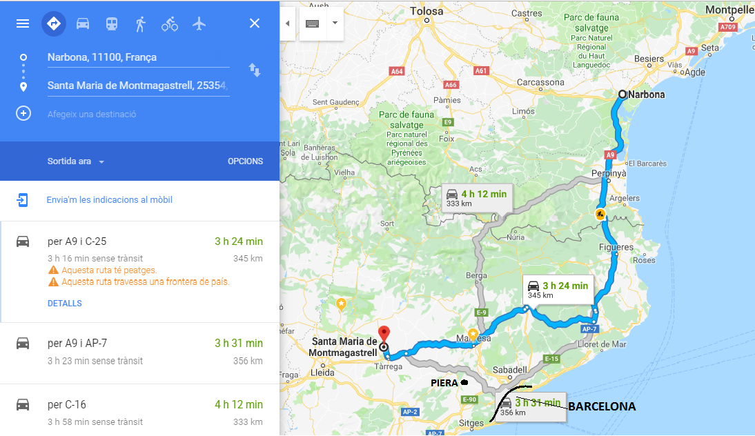

How you know I have REMOT, one remote observatory from 8 years ago in Santa Maria de Montmagastrell, a small village about only 25 habitants. I can tell you shortly forme my experiences. With a supportable liminic contamination, the sky in it is well with a very good seeing and slow wind for most of the year.
First I want tell, that I live in Piera, about 70 Km. to Sta. Maria, and I've working her telescope and echelle LINX from all places by internet, ( from L'Aquila, Italy, for example ), usually for 8 years ago I used it the REMOT from my home in Piera.
Certainly on the first times there are some problems, small problems that became a bigger problems for the distance. I could overcome this things with the great help by Antoni Jové, he was working by software, hardware, mechanical parts, etc. Without him, I couldn't have done the project. Antoni lives in Tàrrega only 8 Km. to Sta. Maria. Another important thing, he know how make a telescope in station.
I agree Robin's message, and this is the possible raison that why don't work the remotes echelles own AAVSO. For all is very important there are a person near remote telescope. I can explain you similar and bitter experiences by Mallorca Astronomical Observatory, OAM, whit their remotes telescopes in La Sagra, Almeria, South of Spain.
In Sta. Maria I could observe, 179 nights in 2016, 209 nights in 2017 and 173 nights in 2018. The main problems are, persistent fog in Desember, January and February, ( I'm writting this message today on Saturday night in Sta. Maria, in outside there is a persistent fog since 4 days ago ), and one slow rural internet.
If someone of us or other people, want going to Sta. Maria I would be very happy to show all things and we'll can observe with REMOT and make spectroscopy.
I attached two cards with roads, motorways and times, taking to reference Toulouse and Narbonne for one trip by car. But if you prefer to plane, it's very easy for me pick up at Barcelona Airport and then return to the return flight.
Cheers, Joan.
Cheers, Joan.
