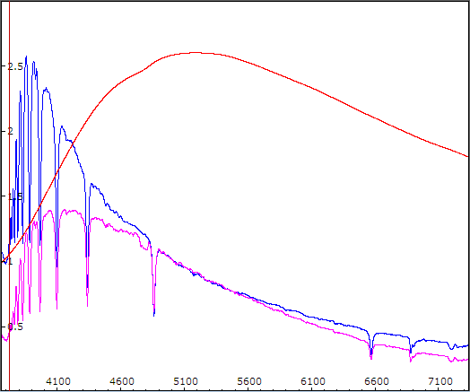

Here is an extreme example from 2 nights ago of the effect of focus drift when using an achromatic focal reducer. My CII is an aluminium tube model and shows large drifts in focus with temperature. I started an observing run by measuring a reference star. The temperature of the telescope dropped significantly during the run so by the time I remeasured the same reference star ~2 hours later, the focus had drifted significantly. This does not matter so much with a fully reflective telescope. The spectrum stays the same. You just lose some light because the star overspills the slit. Because the focal reducer is achromatic though the shape of the spectrum changed completely because the wavelengths in the star image which pass through the slit are different. Note how the ratio between the two spectra (red) is an exact copy of the focus error curve for an achromatic lens

If the spectral response changes with focus position and this one drifts with temperature, i guess a solution would be a focuser that automatically changes position with temperature. A TCF from Optec, for example. I use one in my other telescope for photometry and Works pretty well.
