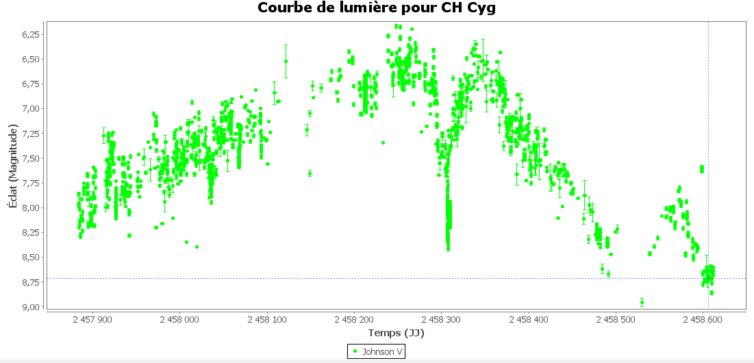

Very low luminosity V ~ 8.6
Impressive changes in a few days.

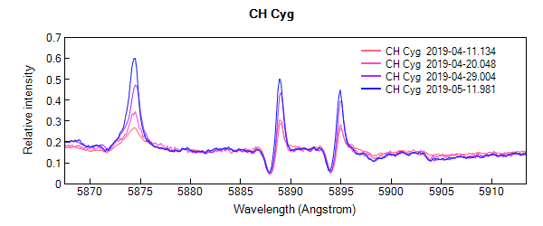

Na I D emission lines are increasing (very low ionization level)

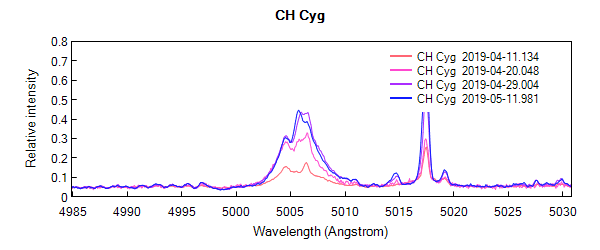

[OIII] region, with He I 5016 and Fe II 5018:

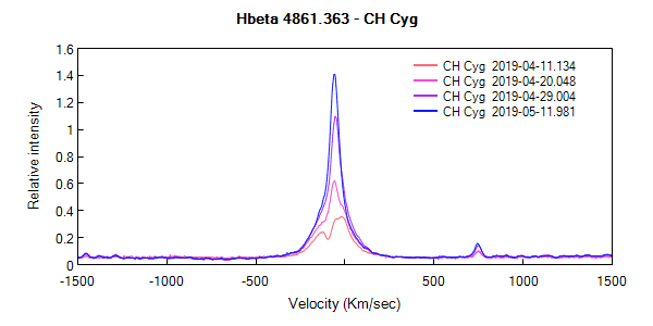

H beta in almost pure emission

the interesting thing is that CH Cyg (V and B) its getting fainter (abruptly) and in a relatively short time period; When this happened in the past, it indicated a jet ejection and dimming of the LC by the ejecta/dust in the inner circumbinary environment. So close spectral and photometric monitoring in the next few months would be of a great interest.
Monitoring of the event at high cadency is strongly recommended

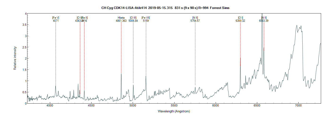

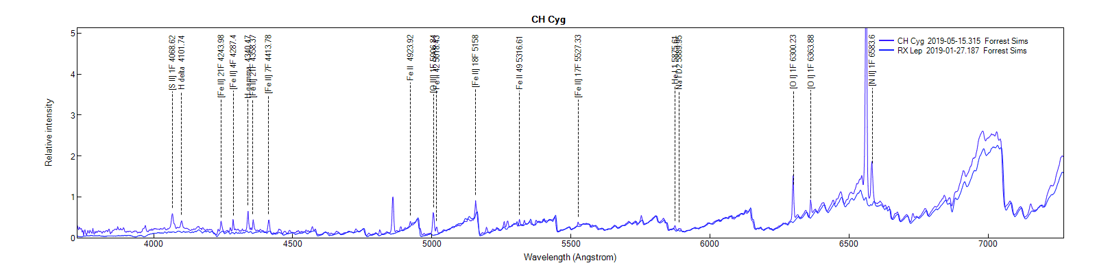

Here is my low resolution contribution on CH Cyg from last night using the Shelyak LISA. I have exaggerated the vertical scale. I have attempted to identify the Oxygen, Fe and Nitrogen lines. Do these look correct?
Woody
Posts: 1567
Re: CH Cygni: still surprizing
Hi Woody,
Correct, unless high ionization Fe lines.
CH Cyg is a peculiar symbiotic, powered by accretion and temperature of the hot component ~ 50 000 K (only!).
Most of the lines are low ionized lines (allowed and forbidden) such as Fe, Ti, ...
Posts: 1567
Hi Woody,
Here's an identification on your spectrum
I used your spectrum of RX Lep to detect the lines which appears at that resolution
More lines could be identified in the range 5000-5500

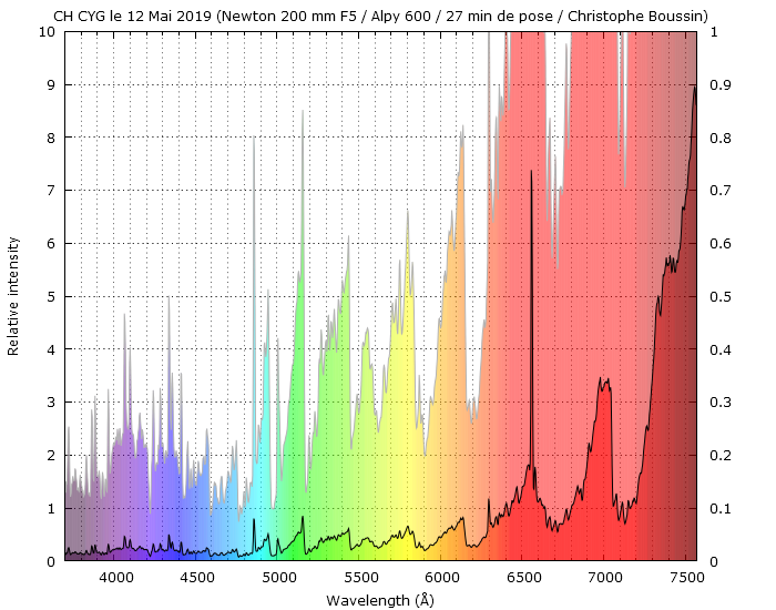

Here is my contribution to the monitoring of CH Cyg.
I obtained the following spectrum the 12th of May at 00 h 03 TU with my Alpy 600 (resolution of 503, JJ = 2458615.5027) and an acquisition time of 27 min :
CH Cyg on May 12th, 2019
_chcyg_20190512_003_Christophe Boussin_3700_7570.png (104.14 KiB) Viewed 7759 times

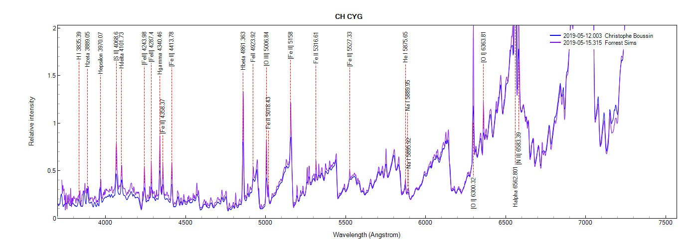

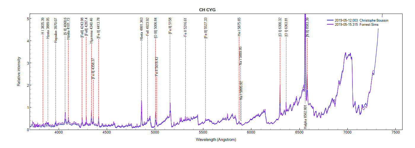

Just to highlight the effect of the resolution on the detection of spectral lines, here is a comparison of the Forrest Sims spectrum (LISA) of CH Cyg with mine (Alpy).
I indicated the position of the same lines identified by François.
CH Cyg on May 12th and 15th, 2019 (comparison)
CH Cyg on May 12th and 15th, 2019 (comparison, zoom)
