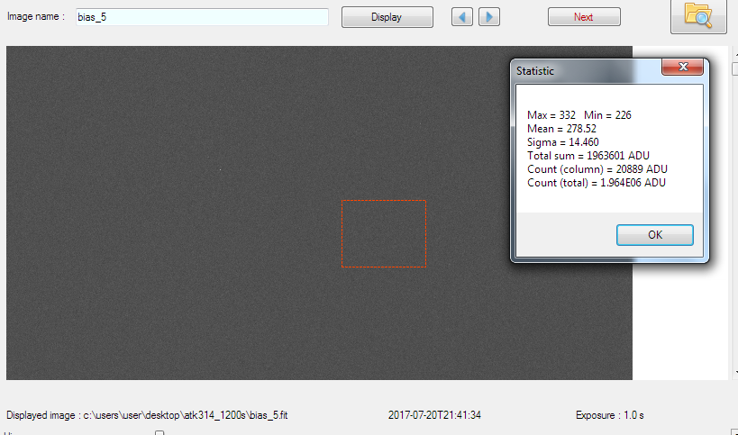

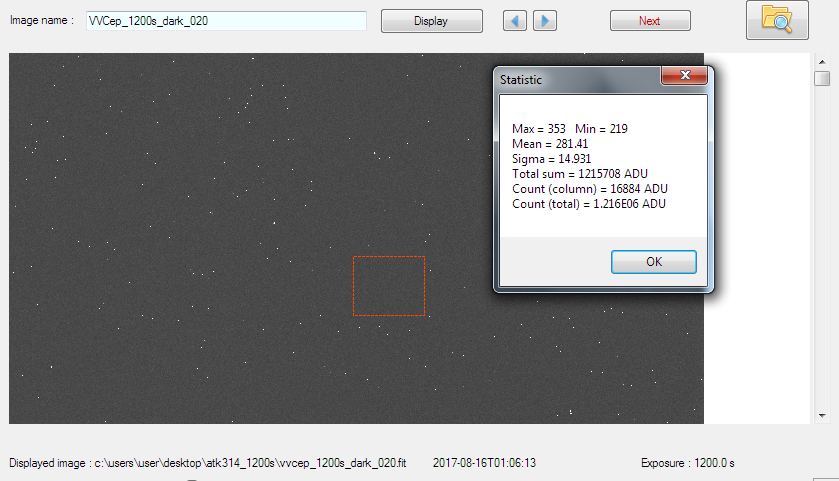

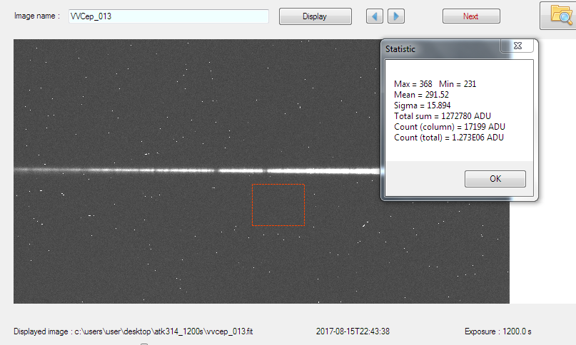

I am not sure I will get 2 hours of darkness here until autumn now ;-) but I do have a comparison at 1200s. Attached are typical bias, 1200s dark and 1200s star exposures. (I have not measured the differences yet but I think the effect is already clear) The measurement is in the blue using the LHIRES with 1200l/mm grating and ATIK 314 camera 2x binned. (The sky background would be even lower with a 2400l/mm grating unbinned)
Bias sigma = 14.5 ADU (which at 0.28e-/ADU = 4.1e- ie the read noise of the ATK314)
1200s dark sigma = 14.9 ADU (The thermal signal is very low with the ATK314 and makes almost no contribution to the total noise in 1200s)
1200s sky sigma = 15.9ADU. (Here we see a small contribution to the noise from the sky in 1200s but the read noise still be significant)
Even at 3600s I think it is clear that the read noise will still be significant
