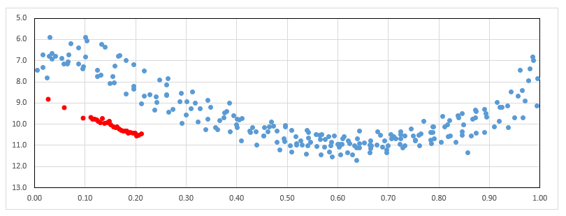

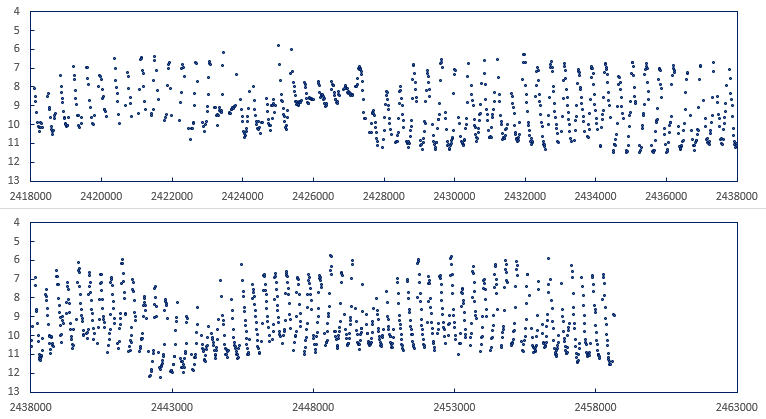

The historical light curve in AAVSO database (Visual, 15 days mean)
since 1908

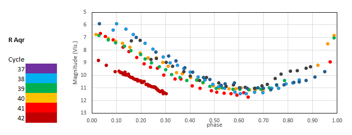

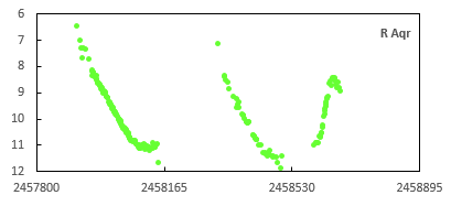

The 3 last pulsations of the Mira
with the recent maximum about 1 mag under the previous ones.

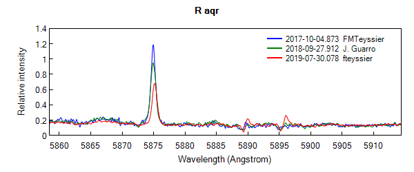

Echelle spectrum obtained this morning.
Emission lines looks weaker than during the previous pulsations of the mira at about the same luminosity
Na I D in emission.

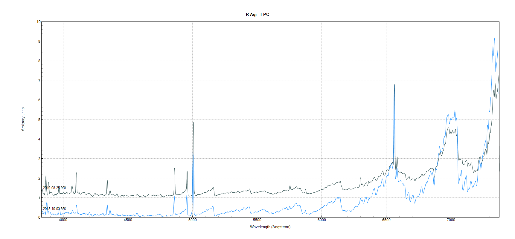

after a long stop due to lack of time to observe, two days ago I could obtain some spectra. Here is a low resolution spectrum of R Aqr compared wiht another taken a year ago. More or less both spectra are taken in the same pulsation phase. The main difference is in the Mira intensity: the continuum is weaker as expected, but I don't appreciate more differences.
When I have finished processing the remaining spectra, I will upload them into the database.

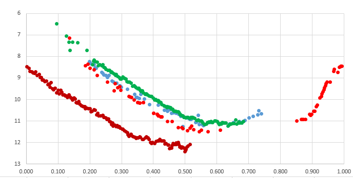

The target is now easy during the nights, but its luminosity declines.
The phase (pulsation) is ~ 0.2 and it will be easier to compare the spectra with those of previous cycles.
Re: R Aqr Eclipse - Monitoring requested

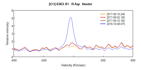

The luminosity of the current pulse remains much lower in comparison to previous pulses

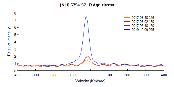

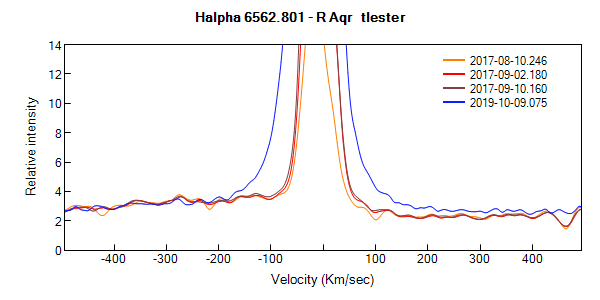

Significant changes of the main lines, EW and profile, especailly in the blue part of the lines:
Tim lester's spectra R = 140000

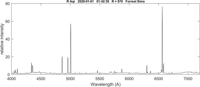

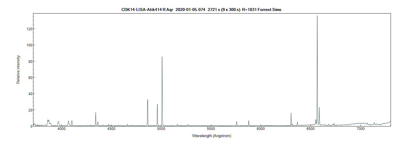

Here is my spectrum of R Aqr from last night.
Woody Sims
