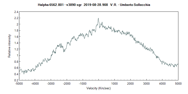

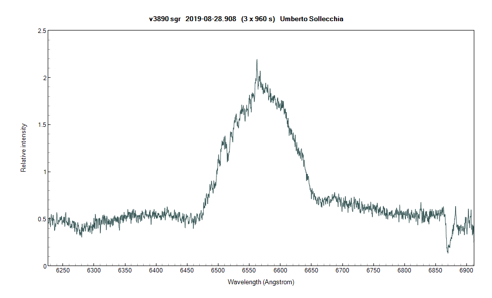

- Posts: 247
Re: Eruption of recurrent nova V3980 Sgr
Bonjour à tous, voici le profil de la nova observée la nuit dernière entre nuages et brume.
Vitesse radiale
Vitesse radiale

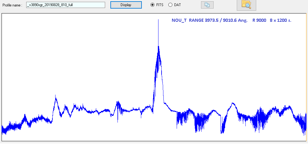

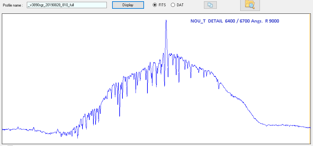

- Posts: 729
Good job Umberto and Terry,
This is the vision with NOU_T echelle spectrograph.
Friendly, Joan.
Friendly, Joan.

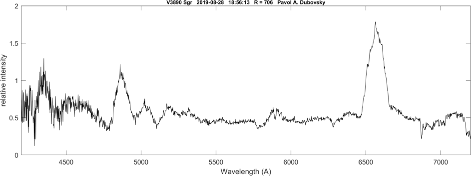

- Posts: 1567
The spectrum obtained by Pavol (LISA R=1000):

Wow ! That has to be one of the most remarkable amateur spectra I have ever seen. Where do all those narrow absorption lines superimposed on H alpha come from ? (The companion star or circumsystem material from previous outbursts ?)Joan Guarro Flo wrote:
EDIT: of course they are mainly just Telluric lines
